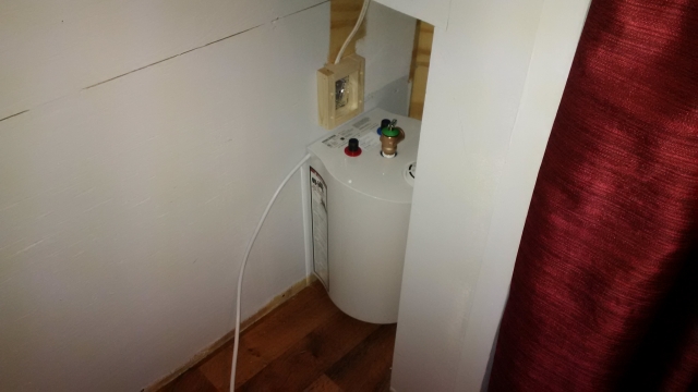

CoventryKid, we have thought about the kettle for heating hot water and haven't thrown out that idea. The simple kettle and two 5 gallon blue jugs under the sink one fresh and one grey seems sooo easy, but would we wish we had done it differently? Are you changing for ease or was heating the water an extra step you grew tired of doing?
pirijodonny: To answer your question, during the build I wired a 20A circuit for a "future" hot water heater just in case. I also installed the hot water Pex lines to both sinks - kitchen and bathroom.
Because our rig is all electric, we had to plug in each night to keep the fridge cold during our 6-month tour of BC and down to California and back. We returned home unexpectedly in Oct. We planned to stay for 4-6 months then resume our trip. So it was a no-brainer - I had time to install a hot water heater.
I found this on Home Depot's site: a small 2.5 gal hot water heater https://www.homedepot.ca/en/home/p.mini-tank-electric-water-heater-shc-25.1000789401.html. These are typically used as "point-of-use" heaters when the main hot water heater in a house is a long distance from the sink.
Anyway, this is the one I am in the process of installing (front left of trailer, at the v-nose - bathroom behind curtain).
Bottom line, as we are always plugged in, this is going to be a nice "luxury" addition.
Hope I've answered your question!
Doug
