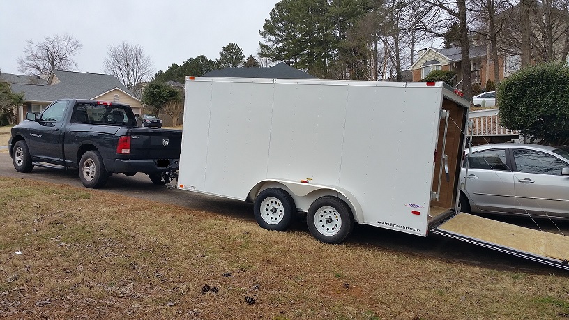

LOVE THE TRAILER looks like you could drop the hitch about another 2'' to level out trailer better will be following this build for sure :thumbsup: :pictures: :pictures: :pictures:

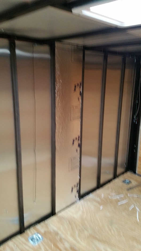

Postby chiefairwrench » Fri Feb 26, 2016 6:28 pm
So let it begin after spending half a day in the tax and tag office Th insulation install begins. :?

I went with doubling up on 1/2" insulation. Question when we say LH (left hand) we are talking about drivers side right? I am getting ready to install my shore power plug in want to make sure i put it in the right spot
