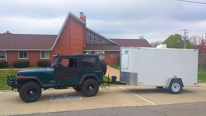

I think you will like the Monstaliner. I painted my whole Teardrop with it. Painted it over epoxy and cloth. I didn't use it on the floor but I know it is durable. The Monstaliner holds up so well to road debrise, rocks, sticks etc. so I decided against putting on thin diamond plate on the front and sides of my tear as I had originally planned.
I use a power washer on it after each trip and have had no issues.

Jeep & Teardrop look great! Glad to see the Monstaliner working for the flooring. Looking to monstaline the floor of my trailer and the inside/outside of my Old jeep. Wife wants my new Jeep done too... but that scares me!

Roll on bed liner for flooring?
Postby funengineer » Thu Aug 18, 2016 6:54 am
kayakdlk wrote:I think you will like the Monstaliner. I painted my whole Teardrop with it. Painted it over epoxy and cloth. I didn't use it on the floor but I know it is durable. The Monstaliner holds up so well to road debrise, rocks, sticks etc. so I decided against putting on thin diamond plate on the front and sides of my tear as I had originally planned.
Dan
Outstanding build kayakdlk. :applause: :applause: :applause:
I see you used the same Marinco outlet and GFIC that I did. I used the GFIC on the end of my shore power cord.
Your build gave me lots of great ideas for finishing my conversion.
Thanks for the info on the Monstaliner. Yours looks great. I'm heading out to sand mine now then re-roll it this afternoon.
