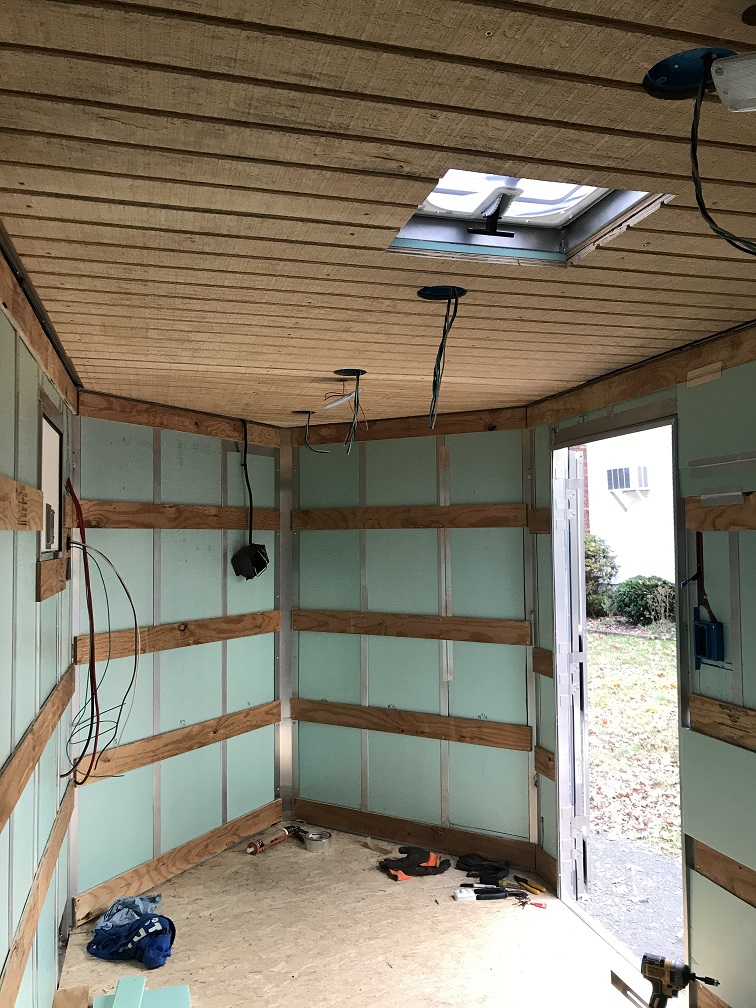

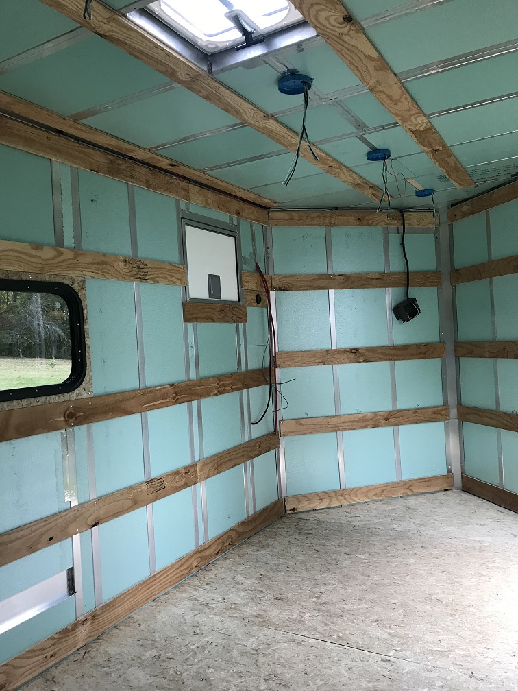

Update: Progress has been a bit slow due to working O/T and other commitments. Insulation done and 1/2" plywood stripping added for an additional thermal barrier. An extra 1/2" of XPS is being installed between plywood strips.
IMG_0129 copy.jpg (256.59 KiB) Viewed 1730 times
IMG_0133 copy.jpg (287.99 KiB) Viewed 1730 times

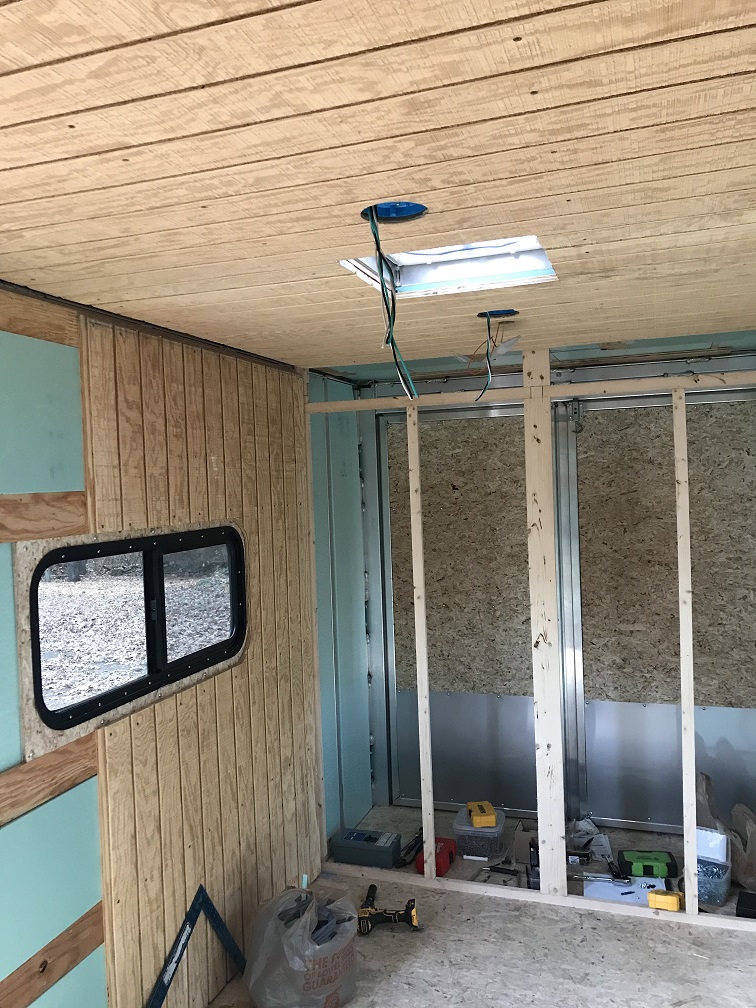

Installing T1-11 with 4" O/C grooves on ceiling and walls. I'm leaving the wiring channel at the top of the walls open for now and will cover it with trim to make it accessible without removing any paneling.
IMG_0139 copy.jpg (328.82 KiB) Viewed 1729 times
IMG_0140 copy.jpg (329.12 KiB) Viewed 1729 times
