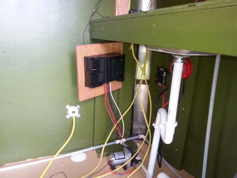

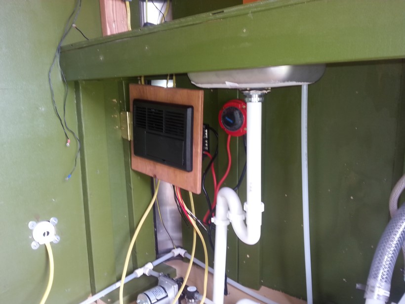

Postby Tommy B » Thu Jun 16, 2016 12:20 pm
Hinged vertical panel right behind the water pump. 12 inches wide or so. Hinged at the bottom, locks at the top. Tilts forward. Limit tilt with small chain. Say 8-10 inches should allow access to the back as needed. Might need to lengthen the black dome light wires with butt connectors by a few inches but all the other wires should be ok.
I will need to buy 30-40 feet of that yellow 120 volt wire for the hood and AC though.

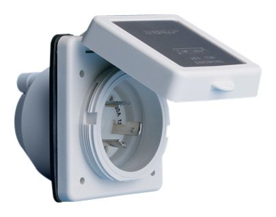

Postby Tommy B » Mon Jun 20, 2016 10:25 am
I am going to install this tomorrow. I need to cut through the skin, then 1 inch of space and then the 3/4 plywood. Either way, its going to be difficult with the interior plywood preventing me from doing this like I want to. Wood backing directly behind the skin to screw the inlet into. That one inch space will allow the inlet to pull in the skin as its tightened to the interior plywood and seems like it will not be solid.
The only thing I can think of is I can still remove the right side interior plywood. Either the upper or lower piece. This would expose the frame and skin and I could brace it up proper BUT this would place the inlet clear on the other side. Near the door Maybe. But I really wanted the inlet to be on the left side and forward. Is that not really Possible?
Thanks.
30 amp inlet male.jpg (13.42 KiB) Viewed 3237 times

Postby McDave » Mon Jun 20, 2016 12:25 pm
Hey Tommy,
Your gonna want to put that outlet as close as possible to the power center, and batteries also. Shorter runs = less amps=less and smaller ga wires. also if you had to cut an access door inside, then put the ply/paneling against outer skin, then 30amp inlet, hopefully near power center, access door inside may come in handy. Where is your water inlet and poop dump located? A lot of times these are all close proximity on the left ( drivers) side.
McDave
Also, How deep is that inlet? looks more than 1". So maybe just longer screws and brace it inside of interior paneling?
I must be reading that wrong, your paneling isn't 3/4, right?

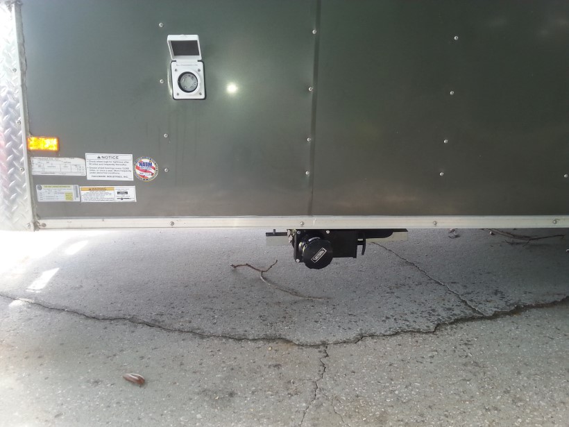

Postby Tommy B » Tue Jun 21, 2016 1:30 pm
ugg, another azz kicker. hung a little crooked but I could straighten. Small concern. My wife has soo much patience with me. Could not have done it with out her.
Its THE best I could do and its solid if anything else.

Postby Tommy B » Tue Jun 21, 2016 1:33 pm
The inlet..to frustration. But its right. I think.

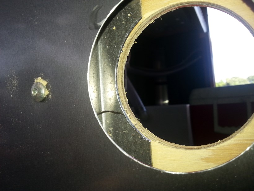

Postby Tommy B » Tue Jun 21, 2016 1:37 pm
This was a brake through. Mciver and duct tape. Desperation,perspiration,beer. :thinking: :thinking: :thinking: .
Hope this helps some one.

Re: HALLMARK 6X12 CONVERSION
Postby Tommy B » Thu Jun 23, 2016 7:34 am
Darn,,its upside down. :oops:
Upside down and crooked. Like the installer. Scary thing is, I really thought about it.
