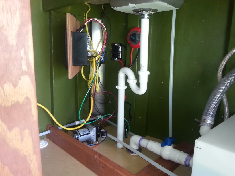

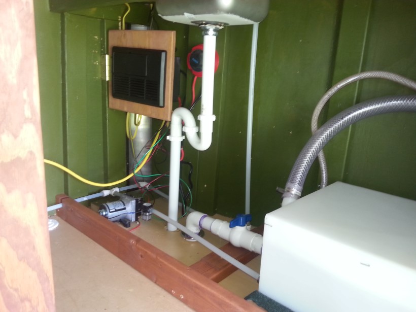

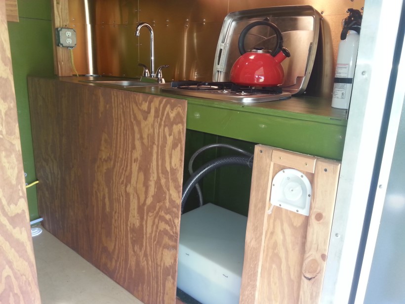

Postby Tommy B » Sun Jun 26, 2016 3:40 pm
Much progress. Most good. Some not so. AC electric seems solid. That Air Conditioner always tripped breakers at home and at camp with generator. Gfi circuit at home is only 10 AMPS. In the trailer its 20 AMPS for the air conditioner.Not tripping in the trailer but STILL periodically trips the house 10 AMP GFI breaker when I crank the AC ON max. But you could hang meat in there when and it stays on. Serious. DC dome lights go half dim and flicker at the same time periodically. jump up and down may bring it on/or not. I will trouble shoot. :thinking: BUT OH NOOOO....the toilet is leaking when I fill tested it. :x

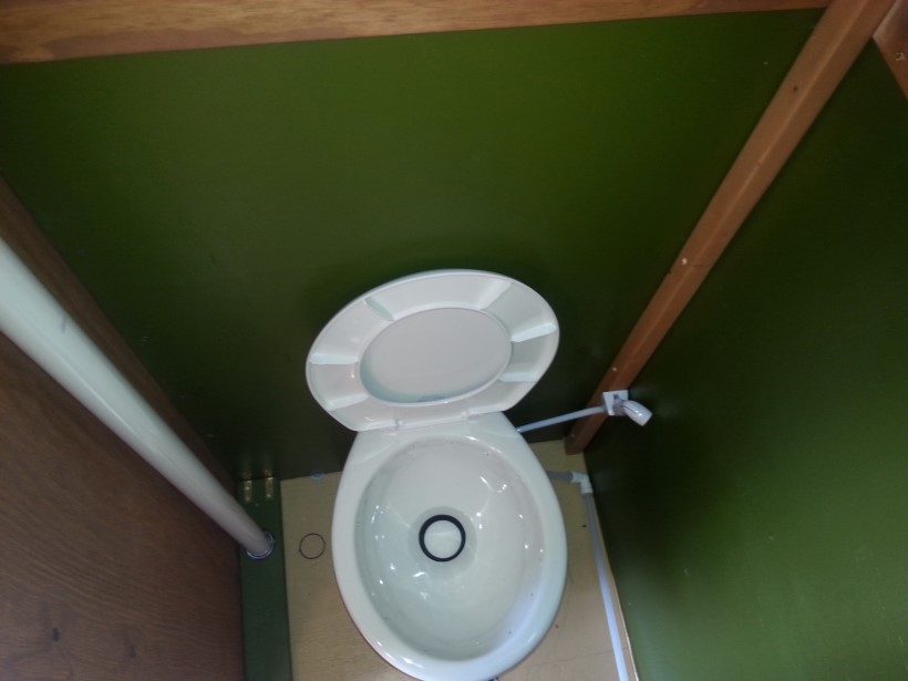

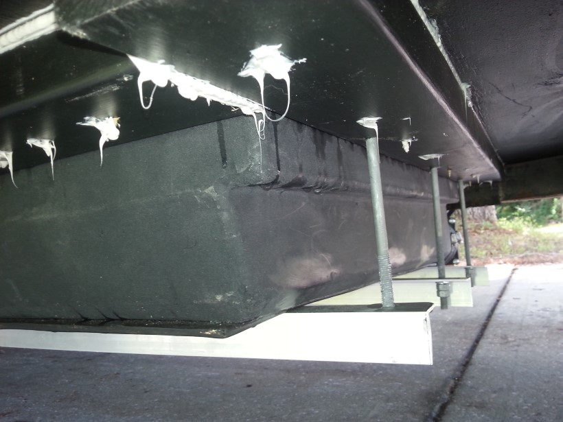

Postby Tommy B » Sun Jun 26, 2016 3:52 pm
No leaks in side at all. When I fill the toilet to the brim as well as the black tank it seems to leak I think at that thin foam seal between the floor flange and toilet base and spews out the space here between the bottom of the floor and the tank.
I am comfortable with that wax ring and would like to swap out them as such. Somebody, anybody no what I should do? :thinking:
Thank you, I will try and figure it out tomorrow or so. :thinking:

Postby hankaye » Sun Jun 26, 2016 4:46 pm
Tommt B. Howdy;
Tommy B wrote:No leaks in side at all. When I fill the toilet to the brim as well as the black tank it seems to leak I think at that thin foam seal between the floor flange and toilet base and spews out the space here between the bottom of the floor and the tank.
Trying to wrap my head around what it is that you are saying is leaking. Wouldn't happen
to have some kind of picture or diagram handy to post to show what it is that you think it is???

Postby Tommy B » Mon Jun 27, 2016 7:48 am
Good Morning Hank.
No picture at the moment, but this may help.
In order to fill test I used that Flush King device. I placed it on and Cranked the hose on high and ran around to the inside of the trailer. As I depressed the petal to look down inside and watch it fill, I was reminded that the on demand water pump was hooked up and of course it started working as I depressed the petal. This really filled the 15 gallon tank fast and I panicked and at first let up on the petal as I was about to run around and release the tank drain/flush king. But I thought I would take one more quick look and I wanted to be sure it was full. When I depressed the petal again water shot out like it was pressurized. By not depressing the petal the full time as the tank filled air could not escape as the water rushed in from the flush king. I believe and :worship: that the water forced its way past the toilet seal as it was under pressure. It really was cascading there underneath the trailer along that 2x4 in the picture as I released the drain. I will try again today and make sure the water pump is off and the petal is depressed the full time to allow air to escape.
The electric issue turned out to be the battery cable, as I just barley set it on the post. That was an easy one and maybe the toilet will be too.
Thanks for taking the time Hank.

Re: HALLMARK 6X12 CONVERSION
Postby hankaye » Mon Jun 27, 2016 9:10 am
Tommy B. Morning Howdy;
At first I couldn't figure out why you had pressurization as you have a vent then it dawned on me
while pouring the 2ed cup of coffee, ... :coffee: the drop hole isn't vented till ya open the hole ... :lol:
This is an excellent learning opportunity. After it dries out, turn off the pump, dump 2, 5 gal. buckets
of water in then turn on the pump, and use your "Onboard" water supply to fill it the rest of the way
with the foot peddle. Here's the learning part ... LISTEN to the sound of the water as it enters, the
closer to the top it gets the sound will change. This is important so that you will know when to find
a place to dump it and so that you won't end up having it 'burp' some of the contents at you when
you flush and the escaping air launches the bowel contents at the flusher. Hope this helps flatten your
learning curve.
