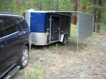

That's a lot of components to put up an awning. I used 10' of 3/4 emt fixed to the top of the wall and these fittings. I cut the assembly pieces in 5' lengths for ease of handling and storage and use a 10x10 tarp with ball bungees. Allows me to have the awning out 10x10, 10x5 with a 5' drop for some privacy, or fold it under for a 10x5.
I have the emt on both sides so I can use the awning on either side, or both sides, if I buy more fittings. They're easy and quick to use and the 3/4 emt pieces give it a lot of strength. Only takes a couple of minutes to set up.
https://creativeshelters.com/category/flat-fittings

Not so much about set up, just seemed like a lot of construction parts. This is my setup. I don't have a picture of it out the full 10 feet, just out 5x10 and down 5' and just out 5' and folded under. I have doors on both sides. The nice thing is that using the parts I have used, you could easily go 10x15, 10x20...out as far as you want.

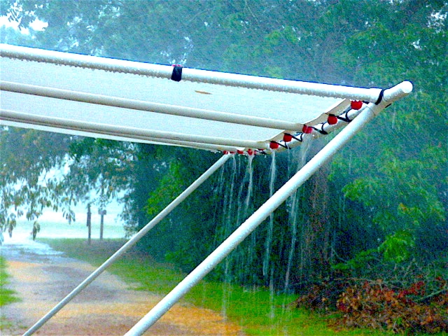

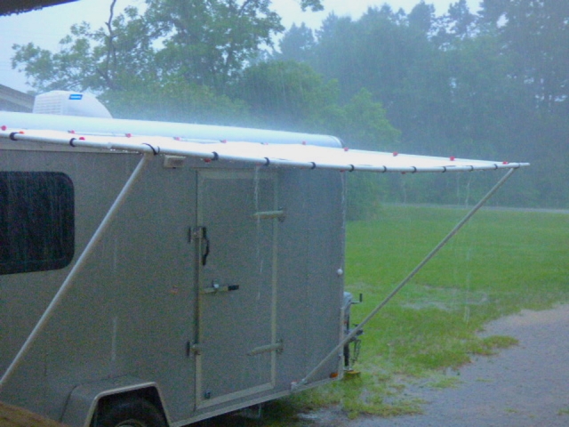

Postby McDave » Fri Jul 06, 2018 6:54 pm
Looks like you have a little dampness there. Great test for the awning. Nice work Hawk.
