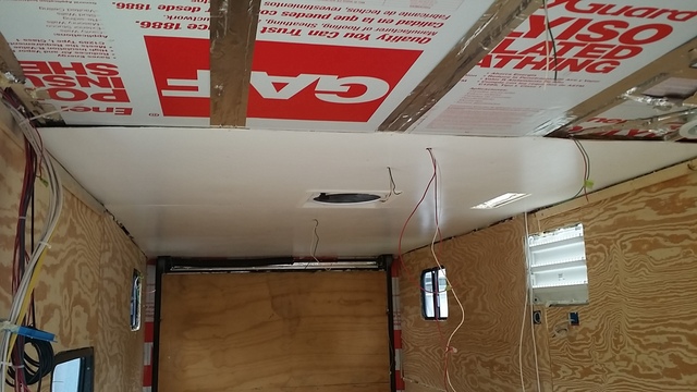

A little more progress today. I got in ceiling panel #3 today. Two more to try and get done during the evenings this week, then I start flooring. :thumbsup:
I'll trim the ceiling and give it a good finish coat of paint when walls are up and etc. nearer to the end of the build.

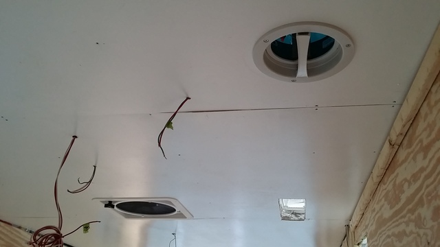

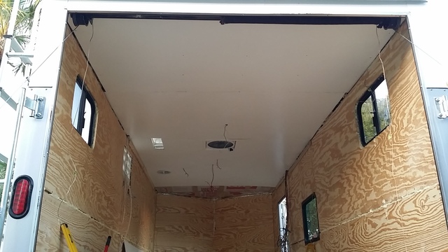

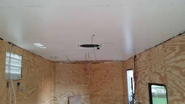

I got one more ceiling panel in last night and managed to get the holes in the correct spot using x,y measurements. One more panel in the V-Nose and I start the flooring :-)
I still have to remove the temporary rail and finish trim; however, I will wait to trim it out until after I have the walls and cabinets framed in. That will happen within a few weeks I hope. :thumbsup:

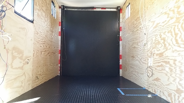

I got this far today. I have the ramp done and most of the floor. I got a late start and just ran out of time and plus, it is really hot here today and especially inside the trailer rolling on flooring.
I might have said it earlier, but in the Aisle and Kitchen area, I will be installing a wood laminate over this diamond plate flooring. That is intended mostly for the Garage area. It should be a good underlay (moisture barrier) in any case. I think this will look nice once trimmed out with the etrac and tie down hooks installed in the rear floor. I am going to put 24" of Chrome Diamond plate as a kick plate on the ramp. That will all happen when I trim it out.
I have a little more to do up front. Ran out of time today.. plus it is hot and that glue is making me dizzy. :(
