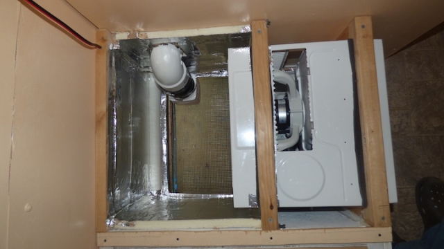

Postby featherliteCT1 » Sun Jul 15, 2018 4:36 pm
Hader wrote:Image
Hader,
Is your air conditioner mounted on it's side? If so, I did not know that they could operate that way.
Also, how do you like the performance so far? .... I know that some have noted that the units setting on the floor do not perform as well as the units mounted high because the cold air tends to settle on the floor.
Thanks
featherliteCT1

Re: Another way to skin a cat.
Postby Hader » Sun Jul 15, 2018 4:57 pm
featherliteCT1 wrote:
Hader wrote:Image
Hader,
Thanks
It's Right-side up. We only tried it at an outside temperature of 106°, Trailer skin was between 112º to 125º. trailer was under a cover, but it was S. Texas. We got the temperature down to 80° in 2 hrs, we then (knowing that it's working) turned the AC off.
As to the floor! We'll have to wait and see if there's a noticeable difference, considering the small space. We can always use a fan to compensate.

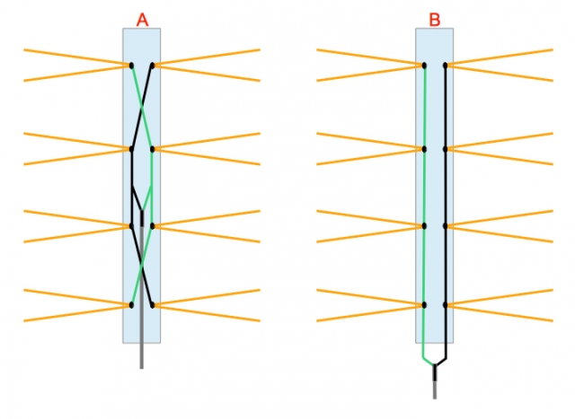

Any input would be appreciated.
Found this TV antenna plan https://www.popularmechanics.com/cultur ... v-antenna/ and built it as per instructions (A).
It works perfectly.
I'm thinking about building one for the trailer (as in B). Would the configuration of (B) effect the reception?
Postby hankaye » Sun Jul 29, 2018 9:04 am
Hader, Howdy;
Not being any way, shape, or whatever smart about anything, especially anything to do with engineering
I venture to say that when you have build 'A' you are sourcing your signal with both sides of the yagi and not
just a single side as you would with build 'B'. Anyway I found this;
https://turbofuture.com/misc/Pros-and-C ... i-Antennas
and for that balun term I found this;
https://www.google.com/search?q=balun&o ... e&ie=UTF-8
I'm sure that someone much more knowledgeable will show up to help ya get a bit further ...
Postby Hader » Sat Aug 04, 2018 9:22 am
hankaye wrote:when you have build 'A' you are sourcing your signal with both sides of the yagi and not
Thank you Hank.
What got me confused is that It looks as if (B) is also sourcing both sides. What am I missing?
Hader
Postby hankaye » Sat Aug 04, 2018 9:05 pm
Hader, Howdy;
Thank you Hank.
Your probably not missing anything, rather I most likely am, flboy (Don), would most likely be the responsible adult in the room
for this conversation. To me it appears that "A" would be more like a balanced reception, stereo as an example only, by gathering
signals from both sides equally and "B" would be more like monaural one half is pulling from it's side and the other the same. Maybe
I got that part backwards as well ...As I mentioned at the beginning of my initial post, I ain't an expert at anything as my ex's all
3, even if I did re-do with #2 so is that 4??? Google can be your friend and from what I saw, these Yagi's can send and receive but
the arms (V-shaped bits), need to be specific lengths for specific frequence segments.
Make one of each and see how they compare, re-build the worser of the 2 to match the better...
Postby Hader » Sat Aug 04, 2018 9:24 pm
hankaye wrote:To me it appears that "A" would be more like a balanced reception, stereo as an example only, by gathering
That may be what I'm overlooking.
We are very happy with (A), just was wondering why it couldn't be wired differently.
I'll wait and see what Don has to say.
Postby flboy » Sun Aug 05, 2018 6:19 am
Hader wrote:Any input would be appreciated.
It works perfectly.
Hader, short answer is yes, I think the B configuration would affect reception in that it would be less than A.
Each opposing pair of the little "V's" is an element with a more precise length and separation at the ends of the "V", and to improve the signal/gain, the received signals from each element needs to be in phase at the feedpoint to "add". Just looking at it, I believe the intent of the center feed and crisscrossed phase bar is to achieve the "in phase" benefit (better gain).
On B, the bottom feed may present some phasing problems in addition to a higher impedance at the feedpoint.
In both cases, you must run the coax into a Balun before connecting to the antenna.
Since it should be easy to re-configure the feedpoint and phasebar as shown, you can try both configurations and see what you get with all else being the same. I think you will notice "A" brings in more distant stations. For receiving a signal, any old wire may bring in a strong station , so B will work for stronger stations but may not pick up stations further away due to less gain.

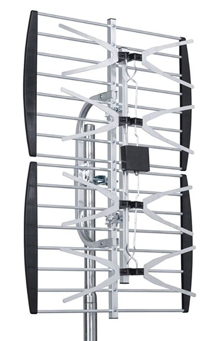

Just my thoughts. BTW... this is a knockoff of a 4 element Bowtie antenna. You could further improve reception and reduce noise by putting some wire mesh on the opposite side. It should be electrically isolated from the antenna.
Don (Flboy)

Postby Hader » Fri Aug 10, 2018 6:53 pm
Thank you Don.
flboy wrote: you must run the coax into a Balun before connecting to the antenna.
I'm using it without a Balun for now. I'll be getting one Saturday.

Postby flboy » Sat Aug 11, 2018 6:17 am
Hader wrote:Thank you Don.
Yes, that will match the impedance of the Antenna Feed Point to the TV receiver input. Again, may not make a huge difference on strong stations, but will help on weaker ones. Baluns are very important if you are transmitting, but do make a difference on receive also and they cost very little.
