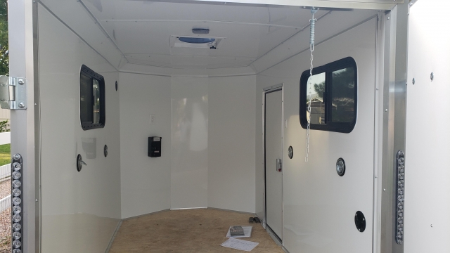

Postby meach4x4 » Thu Oct 01, 2020 10:21 pm
So this is the interior as delivered:

Postby hankaye » Fri Oct 02, 2020 8:03 am
meach4x4, Howdy;
Almost a turn-key CT. chuckle.
Nice, what kind/type/R-value insulation did they install in there?
What thoughts have you for additional wiring and how are ya gonna
run it?
