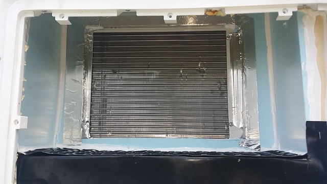

No I haven't taken the outside vent cover off. I did estimate the open area on the vent cover and it is greater than the area between the cooling fins by a significant amount. With the large vent on the roof as well for intake, I think the circulation is good (there is a lot of hot air coming out of the vent and plenty of air coming in) . The A/C seems to be cooling well... I am just looking for some ways to make it work better by sealing and insulating what I can on the trailer itself. This is the peak test in Florida now given the July weather and the fact I am in full sun with no shade or awning on the trailer or reflective paint on the roof except the area of the solar collectors.
I am not surprised at the water coming out. That is very normal in Florida and one of the reasons why I wanted a smaller AC unit that ran longer and did not short cycle. Just opening the door exchanges a lot of air with near 100% humid air outside, It is muggy here.. almost a steamy haze in the air.

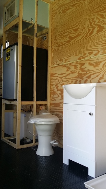

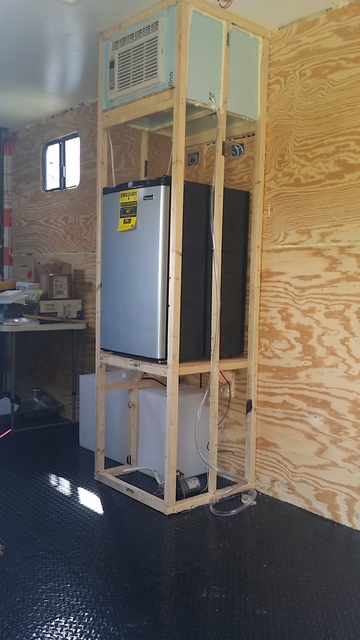

Got a few more hours in today. Progress pics below. Finished the AC, Got the fridge in and have one of the fresh water tanks placed. I'll start installing the bathroom next. I need to get the toilet installed, panel the sidewall, then frame in the Bathroom walls. Working my way around clockwise. :)
The AC taped and and sealed. It cooled the trailer while I was working inside today with 94 degrees and full sun outside. You'll see on next pic, I have double insulated the inside and underneath.
The refrigerator is in. I left enough room to put 1 inch foam around the fridge to double insulate it. I'll cut the foam and put in this week. The space above the fridge will be a panel with a Bluetooth Car Stereo (12VDC) and a cabinet door to access the TV antenna electronics and etc. Below, the fridge will be the water hookups, pump, etc.. I have another saddle tank for the other side. It will connect up by running a pipe underneath and connecting both at the pump inlet so the level off and pull both down evenly.
I have the toilet and vanity in place as I make measurement to start the bathroom framing. I need to run the blackwater tank vent pipe up to through the ceiling also. It will be in the corner behind the toilet.
