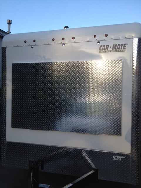

Postby OverTheTopCargoTrailer » Thu May 30, 2013 9:31 am
Here is panel without the tool box.
photo 5.JPG (141.47 KiB) Viewed 3043 times

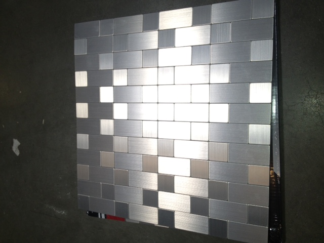

I found these tiles at lowes $10 each, very light & easy stick-on
photo 1-1.JPG (87.47 KiB) Viewed 3043 times

Postby roadinspector » Thu May 30, 2013 10:10 am
Hope the suns reflection off the diamond plate doesn't blind ya in the mirror. That would be rather rude at the most inopportune time.

Postby tnriverluver » Thu May 30, 2013 8:40 pm
I agree about that diamond plate on the front. My V-nose has a wide strip of polished aluminum down the front of the V until it hits the lower diamond plate and it can get very annoying in sunlight and even at night from oncoming headlights.

Postby OverTheTopCargoTrailer » Fri May 31, 2013 10:40 am
Hey Hey Bruce What's up
All these guys are getting mad a my extra sunshine from too much diamond plate :x :x
Good thing the space shuttle is not flying or my roof panels would get heat too :D

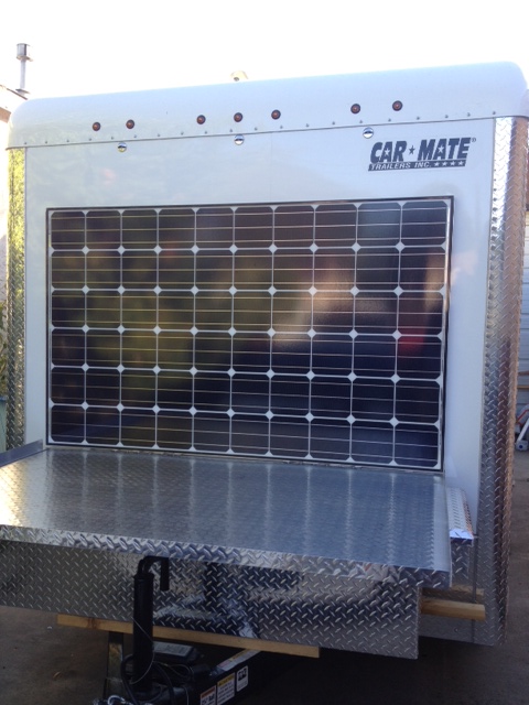

I have decided to make 3 different smaller systems with all those panels 2,250 watt panels
below I ordered this charge controller for just one 255 watt panel (( to test different stuff ))
and a morning star 300 watt pure sine inverter :D :D
total i'll have 3 of those 300 watts each & one other 1500 MSW inverter
The plan is coming together... sent away for the paper work for Maine Trailer Registration
will see what that looks like :thumbsup:

Postby OverTheTopCargoTrailer » Fri May 31, 2013 2:56 pm
Hey hank
I got a jack that comes down & can swivel the trailer 360 deg :D :D :D :D :D :D
No seriously , I will have 1275 on the roof , 255 on the front and 410 on each side.
The panels are now dirt cheap ....... So I can glue them all around.
Maybe some for the back door will still come - they have 180 deg auto swing then :lol: :lol:
Only the batteries still cost alarm & a leg.
:beer: :beer:

Postby OverTheTopCargoTrailer » Sat Jun 01, 2013 12:07 pm
Hey Bruce
I sorta plan to do my setup something like this ...
1.) front 255 watt panel - 15 amp charge controller & 300 morning star inverter. 150-200 AH battery
this will supply the LED exterior trailer lights & the water heater, stereo & maybe outlets to charge phone etc.
P.S. I also put a 7 way plug on the trailer - so I can operate all trailer lights without Tow vehicle :D :D :D :D
2.) top 255 watt panel - 15 amp charge controller & 300 morning star inverter. 150-200 AH battery
this will supply my 60Q - ARB fridge & maybe outlets to charge phone etc.
3.) 1020 watt panels - 80 amp Outback charge controller & 300 morning star inverter. 400 AH battery
this will supply the TV, fans, DVR & maybe outlets to charge phone etc.
4.) Then I have the 1500 watt MSW inverter for running the 500 watt A/C unit, it will also function as a back up battery charger
and to equalize the 2 sets batteries if needed. This unit runs off shore power or also Gen set
5.) The 2 side wall panels 210 x 2 or ( 420 watts per side ) will only be used to give extra boost to 400 AH batteries if needed to run the A/C
late afternoon or early mornings - due to being wall mounted.
im still thinking about what size charge controller for 420 watts i'll use - "AS" only one side of panels will get power at a time.
what do you recommend ....as actual power output would be maybe 330 watts max.
maybe this ?? http://www.civicsolar.com/product/morningstar-ts-45
http://www.civicsolar.com/sites/default/files/documents/tristar20data20sheet-42831.pdf
http://www.civicsolar.com/sites/default/files/documents/tristar20operation20manual-42834.pdf
My logic is I don't wanna have everything hanging on one MEGA system, this will be easier to maintain, trouble shoot & fix if needed.
I keep hearing stories where a guys batteries go bad & he gotta buy 800 AH batts - not cheap.

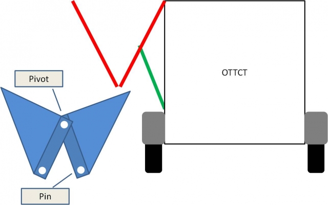

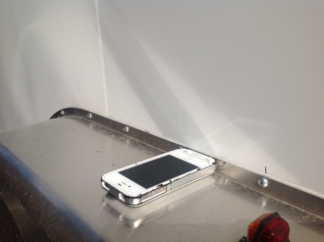

Postby OverTheTopCargoTrailer » Sat Jun 01, 2013 7:28 pm
Hey Bruce
Here is another crazy idea. Any thoughts ??
Pretend the cell phone was my 210 watt side wall panel 39" x 60" , I was planning to have the solar cells face outward , then remove the metal cover and get solar :D :D
but since I need one panel to fold out ( or at least down 6" - 12" ) which will be hideing my side wall a/c unit under the cover , I got this idea :thinking: :thinking:
It would be just the same to have maybe 2 panels face inward & when tilted down they would PU the sun,
maybe someone had this idea - then panels would almost provide some shade too "like pic 3 below"
ONE PROBLEM ALREADY - dealing with the wires if the panel facing in & tilts down ??
Pretend cell phone is solar panel picture below
Solar panel facing out - cover removed - picture above
solar panel facing trailer - with cover in place
Solar panel folded out - facing upward, PROBLEM how to
deal with solar panel wiring ?
Posts: 1628
Re: OverTheTopCargoTrailer 7 x 16
Postby A Plus MM » Sun Jun 02, 2013 8:14 am
Is this what you are thinking for making 2 panels face each other? I would think the wiring would not be hard at all, just leave enough slack at the hinge so it will not be stretched when fully folded in storage mode. BTW, the blue part would be the hinge between the two panels and the green bar would be the prop to hold the panels up at what ever angle you want them. If it's not obvious, the red bars would be the panels.
A Plus MM
Posts: 38
Images: 7
Joined: Sun Sep 02, 2012 1:04 pm
