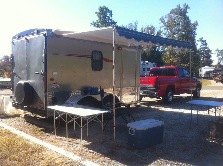

Thanks Hank! Table mounts on grommets that are on the inside and out, pops off in seconds and you can move it. I intend to use it for a grill stand /kitchen on the outside.
Anybody find an affordable roll out awning? I see them for $4-500.00 for a 12' one, seems like a lot?
Any ideas?

Postby tnriverluver » Wed Mar 20, 2013 7:42 pm
pvangel wrote:Thanks Hank! Table mounts on grommets that are on the inside and out, pops off in seconds and you can move it. I intend to use it for a grill stand /kitchen on the outside.
Any ideas?
A bag awning for a pop-up is probably your best option for that trailer. They are easy to put up and take down with a little practice. It is what I went with on my build because I wanted to be able to open my door back all the way if needed and wouldn't be able to with a regular RV awning. Mine came from here http://www.rvworkshop.com/index.php/pro ... rkShop-844
Any ideas?
Nice! Which one did you buy, the supreme or regular? do I buy a 10' one for a 12' trailer?
Thanks for your help!
