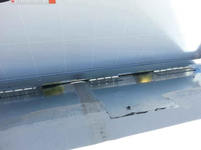

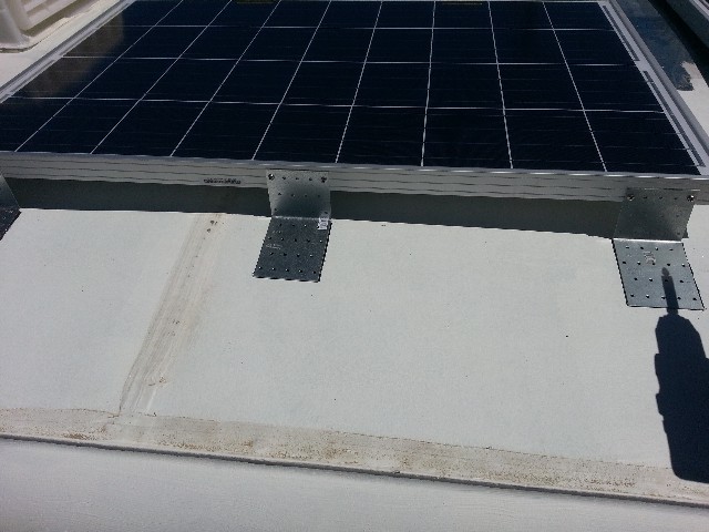

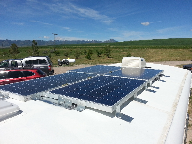

Since we have been having so much cloudy weather that interferes with our solar battery setup , I decided to increase our solar from 200 watts to 400. That should give us enough amp hours on cloudy days or in areas with partial shade to still recharge the batteries as well as take care of our modest immediate uses. The only problem has been finding a couple of days of good warm sun to do the work in.
I used 3m VHB tape to put the original two panels on with, and I am using it to mount the new ones also. From previous experimenting (panel removal from old CT) and research I found that getting the old mounts off requires either extreme (below 0) cold or high heat. Finally we got a day with some heat to it, and I got one of the panels off. It took a lot of prying and some cutting, but the mounts came up one by one.
The original mount had two panels down the middle .
To put 4 panels on the roof I wanted to move the first two so that the four could be in two pairs down the middle of the roof. The roof on our CT has a pronounce curve to it so the outside edges are up higher than our first installation. The panels butting together also posed some issues. I put the first panel down with one edge on the center line with it raised about a 1/4 of an inch off the roof. With the panel level (I hope)the outside edge is a little more than 2.5 inches off the roof.
I used Simpson Strong Tie angles for the middle and front brackets and 3X7 inch tie plates for the outside brackets. The tie plates were bent in a vice to the correct angle. I used an angle finder to measure that.
In order to get to the middle brackets if I ever need to or to remove a panel, I used hinges to mount the second panel to the first one. To make it easier I mounted the hinges and drilled the holes before either panel was put in place. Then it was simple to just screw them together and finish the other mounts.
This next picture is one of the middle support brackets and a reflection of the hinges. The black goo on the roof is some leftover VHB tape from where the original supports were.
On a side note you can see where the silver roof is bare metal that didn't get painted with Henry's Solar Reflective Paint. I am a true believer in Henry's! That bare metal was untouchable while the painted areas were almost cool to the touch.
And a picture of the first two panels in place. You can see that the rear panel hasn't been moved yet. Bad weather is back, and finishing the back two panels will have to wait for another shot of good sun to do the work in.

Between storms we got a couple more good days of sun, and so we mounted the last two solar panels with 3M vhb tape. That gives us 400 watts. Our roof is curved so all of the mounts are bent to the angle of the roof.

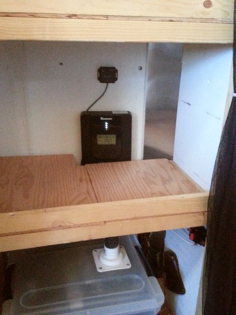

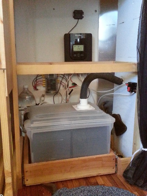

We also upgraded to a 40 amp Renogy Solar Controller with a Blue Tooth module, and we added a breaker with a quick disconnect on the right side wall.
Here it is with the shelf out. The 220 amp hr golf cart batteries are in a drawer mounted on slides.
Here it is with the shelf in. It has plenty of breathing room and is easy to read in this position between the two areas. The shelf is made to be easy in and out for extra wiring and fuse access. I haven't got all of the wires zip tied and tidied up yet. There is enough extra wire to allow for the batteries being pulled out, or the controller pulled up.

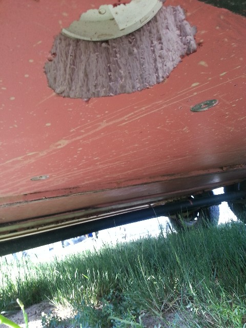

I finally got the floor insulated. Fire season came quickly in June last year, and I didn't get time to insulate the underside before I camped for 4 months in the high country. My feet froze even with foam floor pieces and rugs. So I am excited to have it done for this year.
I do recommend that taking care of the underside is done as soon as possible. I certainly paid for not doing it last year. First I had to clean a ton of mud, mag (road salt), and even cow manure (country roads) off the rails and underside. I pressure washed it three times and had to wash it with a rag and soapy water to get the final mag film off. What a pain! :shock: But I didn't want to have any salts or dirt under the insulation.
Then I had to treat the rust areas where gravel had chipped the paint on the rails. After taking care of the rust, I sprayed the rails with undercoating and sealed all of the bottom floor seams. At last it was ready to put the insulation in. I used glue and screws with fender washers to hold the insulation up, along with some spray foam in the gaps, sides, and seams. Then it was painted over with some old paint to add a little protection to the foam.
I am glad to be out from under! :?

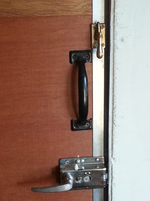

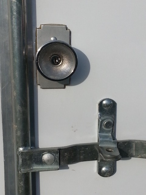

We put an older style used "slam lock" on the door. We decided to not use an RV lock because of how much support material is removed from the door to accommodate the inset latch. The cargo trailer doors are thinner than RV doors, so the main door support can be just about cut in two when putting the RV style latch in unless you reinforce it.
The latch we used only entailed putting a one inch hole through the door. It holds the door nice and tight. I do have the keys for it, but since I still use my cargo bar, they are not a real necessity when locking up from the outside.

Postby onehoser » Sat Jun 15, 2019 7:55 pm
Rainier70 wrote:We put an older style used "slam lock" on the door. We decided to not use an RV lock because of how much support material is removed from the door to accommodate the inset latch. The cargo trailer doors are thinner than RV doors, so the main door support can be just about cut in two when putting the RV style latch in unless you reinforce it.
any more details of the latch you installed? i was going to install an rv latch but i'm thinking twice

Postby Rainier70 » Sun Jun 16, 2019 8:38 am
There are a number of methods for blocking the bar on the outside from being locked. I have seen some that drill a hole in handle and lock the handle to the bar. Some people just put a lock back on the hasp so that the bar can't be placed in it. Without the hasp holding it the bar can be pushed to the side. That would work with a regular lock, but not a puck lock where the bar could be wedged behind it.
On my first 6X12 CT I put a ring in the wall to lock the bar back against the wall with a long shank lock. Image
On this 7X16 CT I mounted a second hasp on the wall to lock the bar in. That way I can use my same puck lock on it. It's easy to just take the lock off the door, move the bar into the second hasp and put the lock back on.

Postby Rainier70 » Sun Jun 16, 2019 8:47 am
The secondhand doorlock that I used, I got from a generous member of this forum, but they can be bought by looking up teardrop trailer parts. Here is a link to one supplier:
https://www.teardroptrailerparts.com/do ... -kits.html And from their pictures you can see the parts and basically how they work. Mine locks on the inside with a lever and outside with a key.

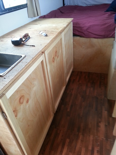

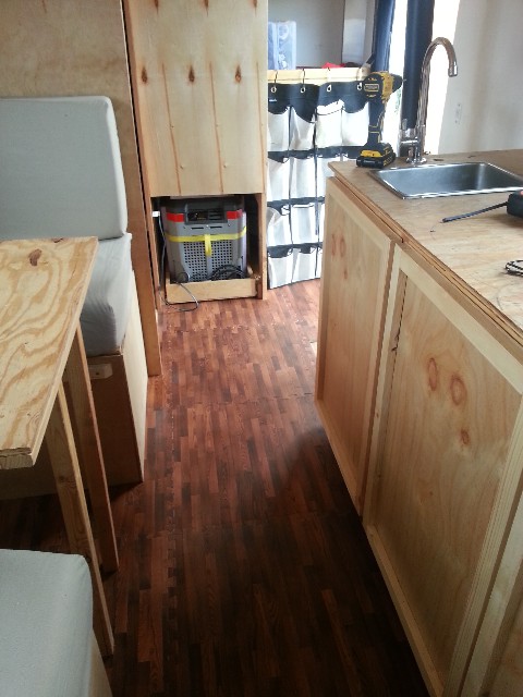

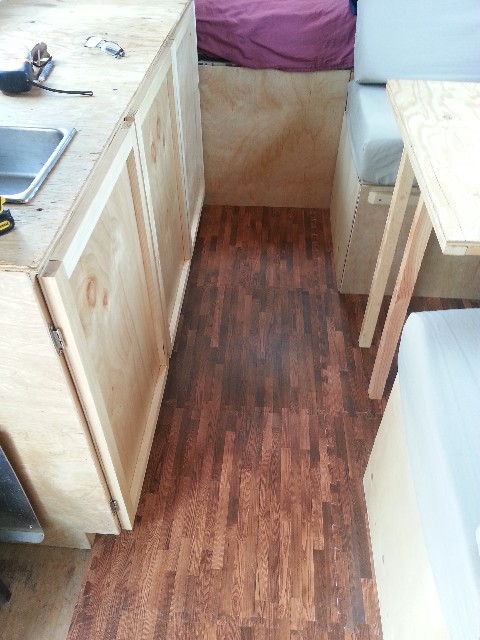

Inside the CT I got the flooring done except for the tile that will go under the stove. I put foam interlocking flooring tiles from a big box store down. I love walking on them. They are very comfortable on bare feet. The puzzle edges are more pronounce at first, but as they are walked on they even out and become less noticeable. Since they are foam they can be damaged by dragging heavy stuff across them or by dropping things. I do have extras, but I think that with care I will get many years service out of these.
The sink is inset, and I got some of the cabinet doors done too.
I put magnetic child locks on the doors to the cabinets with shelves.
They are easy to lock for traveling, but can be left unlocked for when I am camped. As long as I don’t forget to lock them before I pull out. :oops:

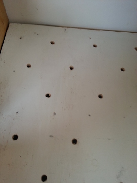

Other small jobs done: I got the holes drilled into the bed platform to provide air under the foam mattress, and put in tie downs in for some of the under the bed storage. I also did a bunch of painting and staining, and about a million more small jobs.
I put a hole about every 6 to 8 inches.

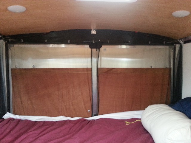

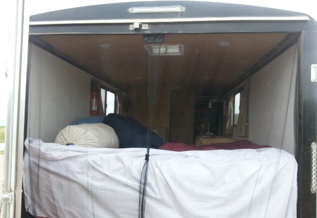

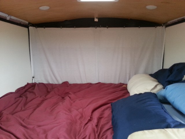

I hung the mosquito net for the back doors.
I was going to trim the excess on the sides, but I don’t think I will yet. The extra on the sides makes an effective bug seal without having to put up a lot of Velcro tabs up, so far anyway. The net hangs behind my dust sheet.
It takes about a minute to drop the dust sheet and open the doors. The only reason it takes that long is because I am careful to keep the dusty side of the sheet to the outside and knock most of the dust off first.
And with the dust cover up:
Wow. Two trips across the bed to mess with the curtain really annihilated the cover I have on it to protect from sawdust while working. :shock: :lol:
I have found using a dust sheet across the back when traveling has been really helpful for keeping things clean. No matter how well the doors seal, on our rough and horribly dusty back roads the doors will flex and admit dust in clouds. Lots of it. Plus when I open the back doors there is a pile of dirt on top of the seal just waiting to jump in and attack! :roll:

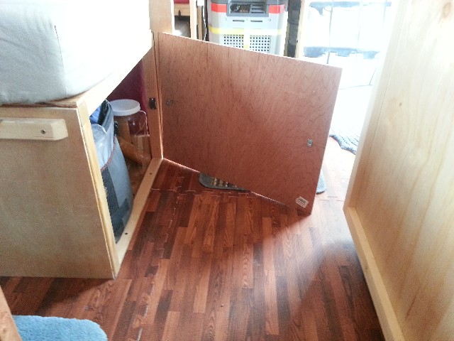

The smooth panels on the sides of the seats and under the bed area are mounted with magnetic catches. Sometimes it is just nice to pull the side off for a quick grab instead of opening the top. I would have hinged them, but I didn’t have room for hinge swing on some of them. I don’t access through the sides very often anyway.
The access panel is propped up against the side to show the magnetic catches.
