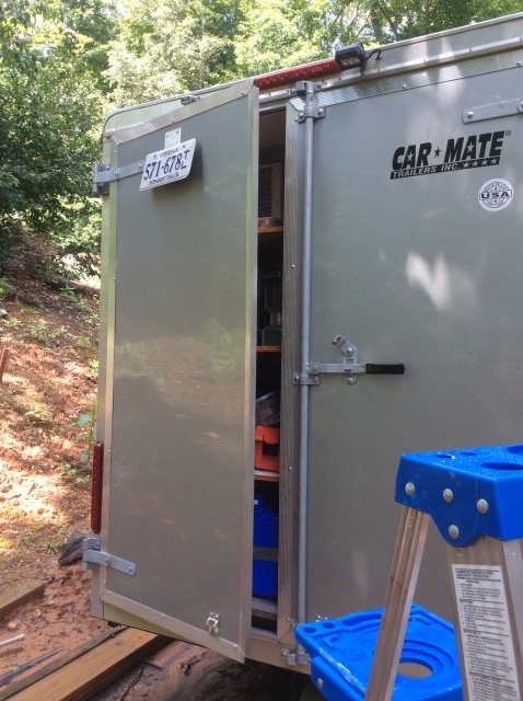

Id10t wrote:lrrowe wrote:Hank,
Yes I have considered them from the beginning. But that required cutting more holes then I wanted to at the time (and now too). That is probably the main reason I tried the AC hacking approach. My idea with my long duct did not work in my case and then when my wife developed lung bronchitis, I trashed the hack idea. I am going to wrestle with the security issue for the time being and then as another (not last) straw, I can consider the slide out idea or one like MtnDon's.
Of course, if I forgot about the value of money, I can look at a high seer inside/outside unit like OTTCT and at least one other poster has done. I like the concept and have the right layout to retrofit one to my current interior, but am just not ready for that expense considering I only spent $25 for it used. Today, an 89 degree day, I moved my trailer which has been sitting in the sun for days and therefore hot and stuffy and got the inside trailer temp down to 70 in the afternoon.
Have you thought about reversing your box hack. If I remember correctly the hot air goes out the back the unit and the cooler fresh air comes in from the top and side vents. If you had your box on the back side extending to the door opening and vented it on the top the hot air would escape naturally. The gaps in the door should provide enough air for the intake if its separated from the hot air escaping. You use some coreplast with slots cut in it to hide the gap between the open and closed door. If security is a big concern you could build an expanded metal door that would swing out from the open door and lock benind the closed door and still leave plenty of venting.
