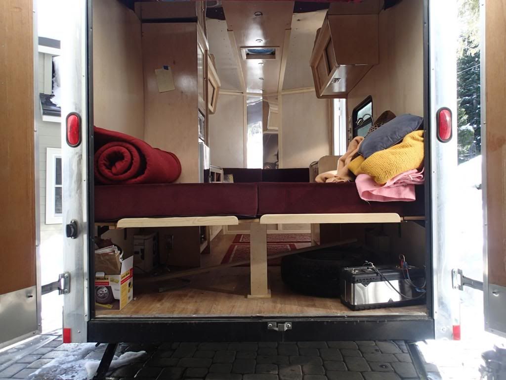

The back open. The bed is split in the middle, each half folding up against the two walls. The pedestal in the middle is free standing and moves aside so I can load trikes, bikes, Moto bikes, paddle boards.....etc.

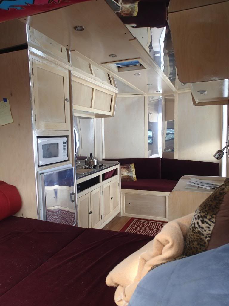

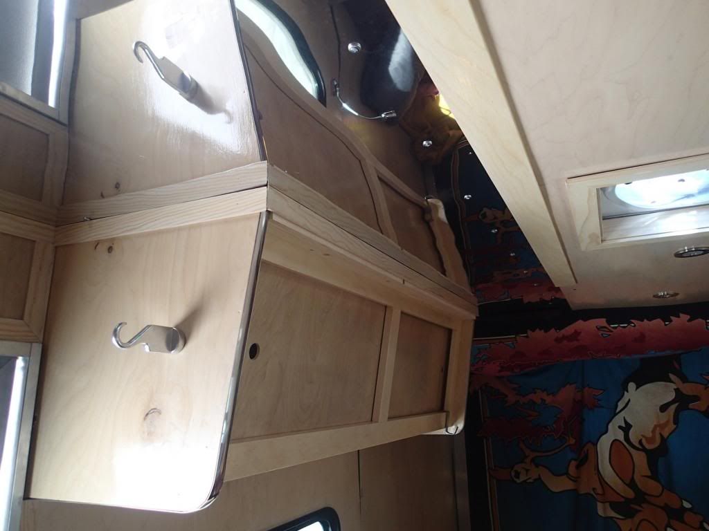

Upper cabinet. Shiny Aluminum ceiling. Repurposed Aluminum coat hook

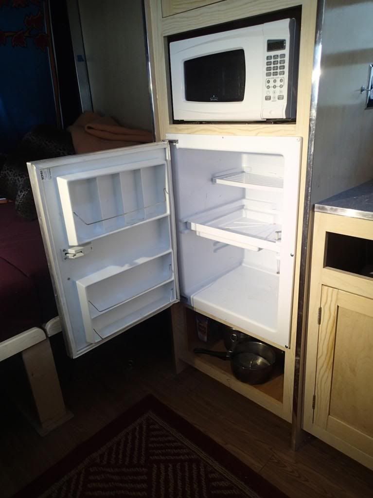

True Ice box (they never break down). Modern Microwave.

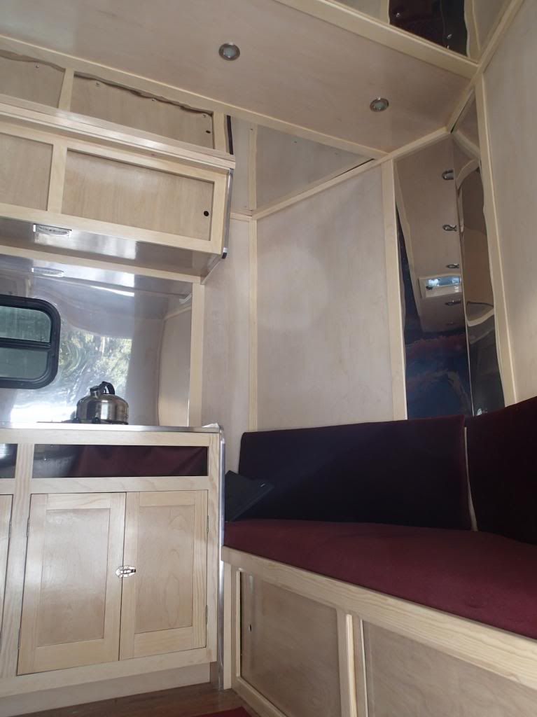

Front bench seat. I want to make a small pedestal table in this corner. Something to put up and take down on demand

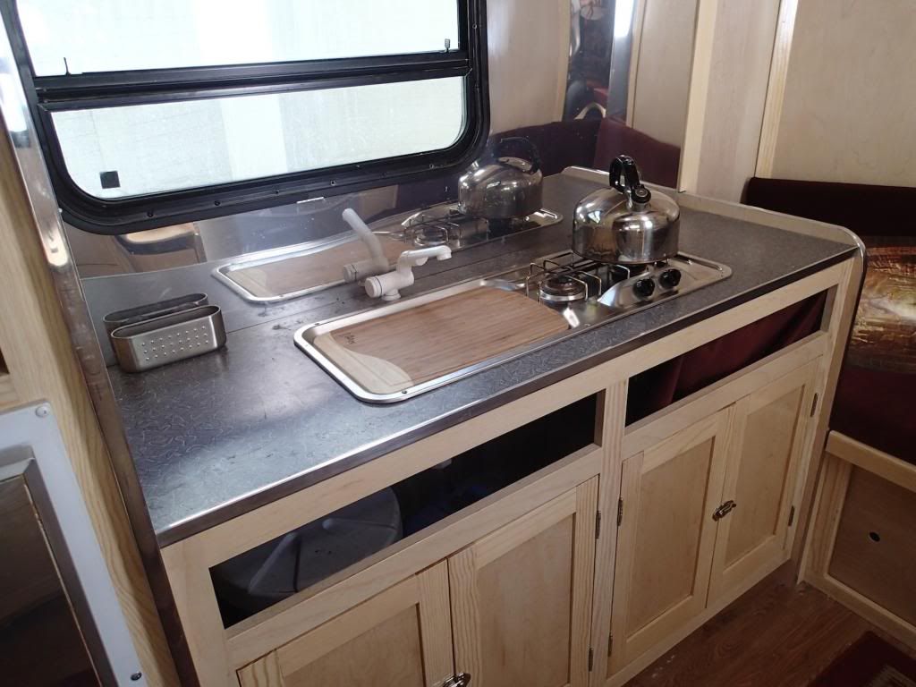

Kitchen. SMEV two burner cook top with sink covered by cutting board. 12v on demand faucet. Under the sink you can see where I am keeping my fresh water, in a 5 gallon tank. Next to it, under the sink drain is another 5 gallon tank for grey water. Small tanks for small use (no shower/privy) Light weight. In the right hand cabinet is a portable Thetford toilet. It is also accessible from an exterior cargo door.

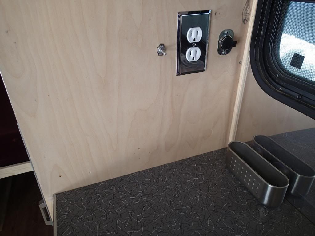

Switch on the left is power to sink pump. 110v receptacle, 12 volt receptacle. 1950's style "boomerang" formical top.

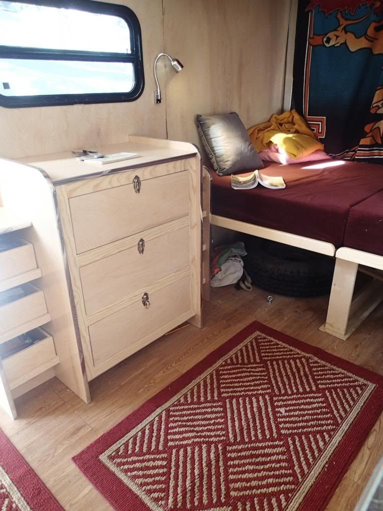

Dresser and boxes for nicks, nacks, books and maps. You can see the spare tire which will eventually have a home in a "to be built" steel reinforced cabinet above the bed.
The reading light on the wall next to the bed is a high intensity LED light on a flexible neck. Works real nice. I have GOT to clean up that paneling edge with molding.

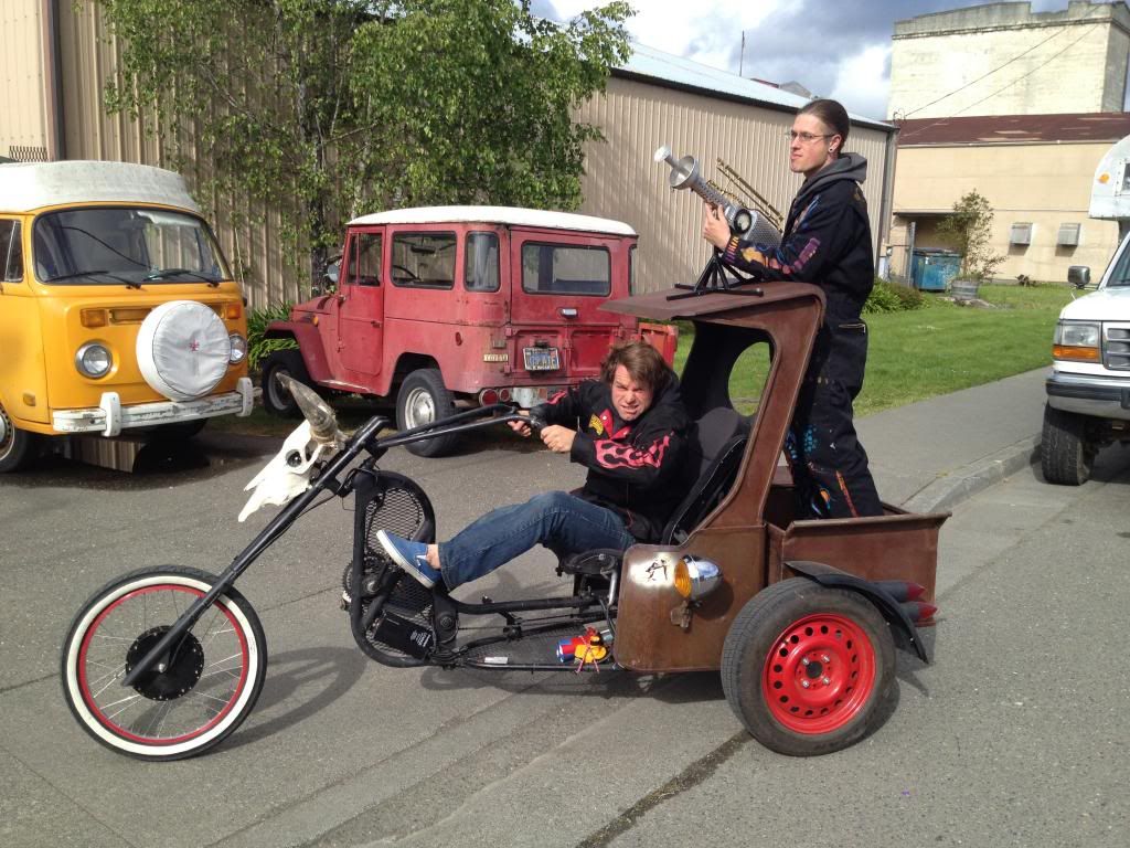

The trike is just a crazy idea I had. Some friends and I have been cutting up bikes and welding them together as trikes for a few years. This one is the first we made to look more like a car/truck. The design for the frame and axle came from the good people at atomiczombie.com. They are THE source for crazy bike designs that anyone with a welder can turn into working bikes and trikes. The frame was fabricated mostly from 1.5 inch EMT tubing along with tubing from old steel bikes. Go kart parts were used for brakes, rear chain, axle and sprockets. Bike parts for gears, pedals, front chain, head tube, shifter etc.
The front wheel hub is a 2 kilowatt, 48 volt electric motor. It is powered by 4 sealed lead acid batteries stored behind the seat. Electric assist range is up to 8 miles. Motors available range from .5 kw to 2.5 kw. Complete motor/controller/battery packages range from $700 to $2000 (and higher for LiPO4 batteries) They are marketed and designed for use on standard bicycles. We have seen only a handful of BIG trikes like ours around.
An interesting note: as long as a trike has 3 wheels, pedal drive, and goes no faster than 20mph, it is LEGALLY a bicycle. Even my 9 foot long, 300 lb monster is a bicycle.

Keep meaning to ask ... do you have a link for where we might find an icebox
such as the one you are touting ???
hank
Yeah, I second that. I remember my folks had one in our old VW microbus pop-top. They just made a big block of ice (as I do for our cooler) and we were good for several days.

I got the ice box at Vintage Trailer Supply
http://www.vintagetrailersupply.com/Ice ... ts-810.htm
Mine's the larger of two they sell. $160
