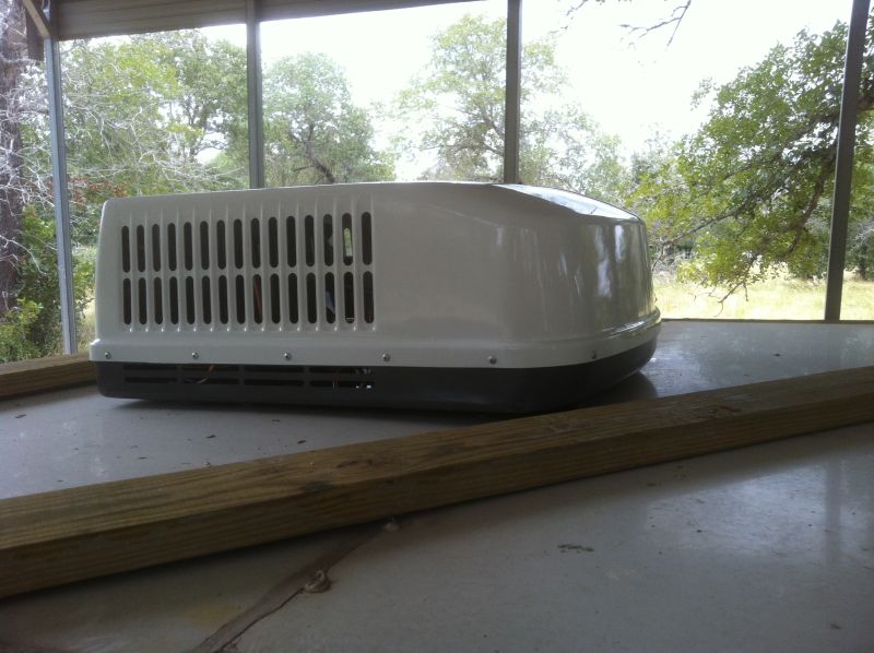

Well got the AC installed. My wife wasnt home so I carried it up the ladder by myself. Now I need a massage.

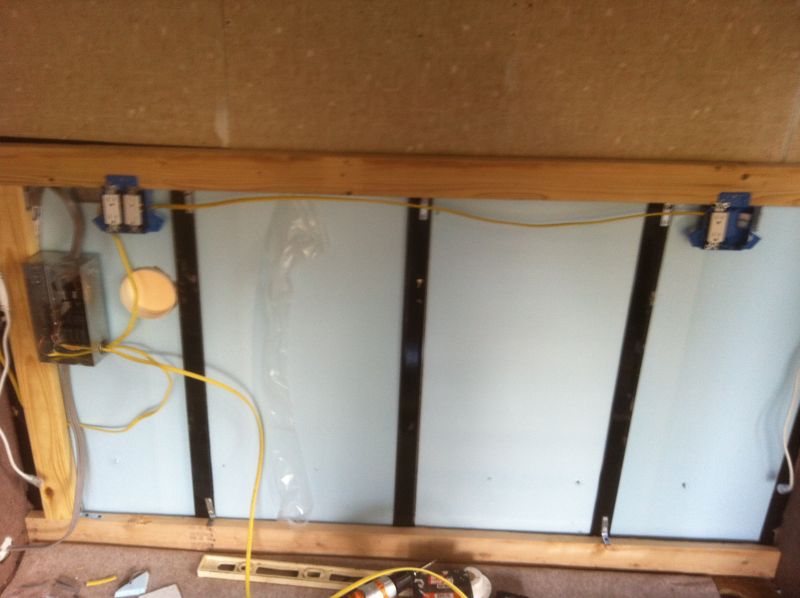

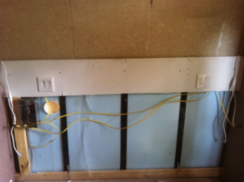

Got the breaker box wired in
Put a piece of luan up to hide some of the wires. The rest will be hidden by the counter.
The white wires hanging there connect to the LED rope light that I will install tomorrow. I have to buy another torque wrench to tight the ac down and find an adapter so I can plug in the RV plug to regular house hold plug so I can test everything. Monday we are going to the Re-store to get some cabinets and a counter top.

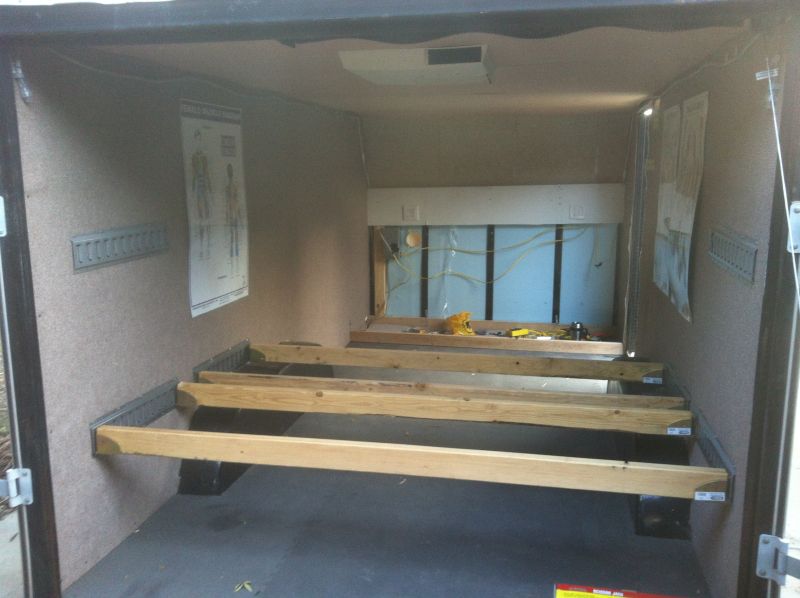

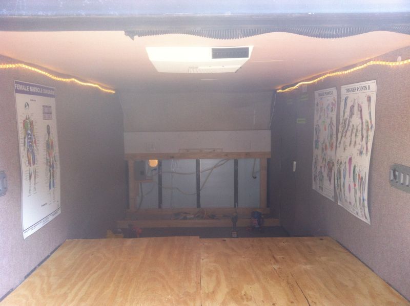

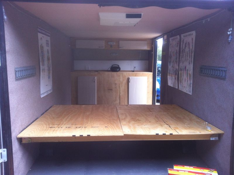

Made some more progress on the trailer today. Put the bed rails in

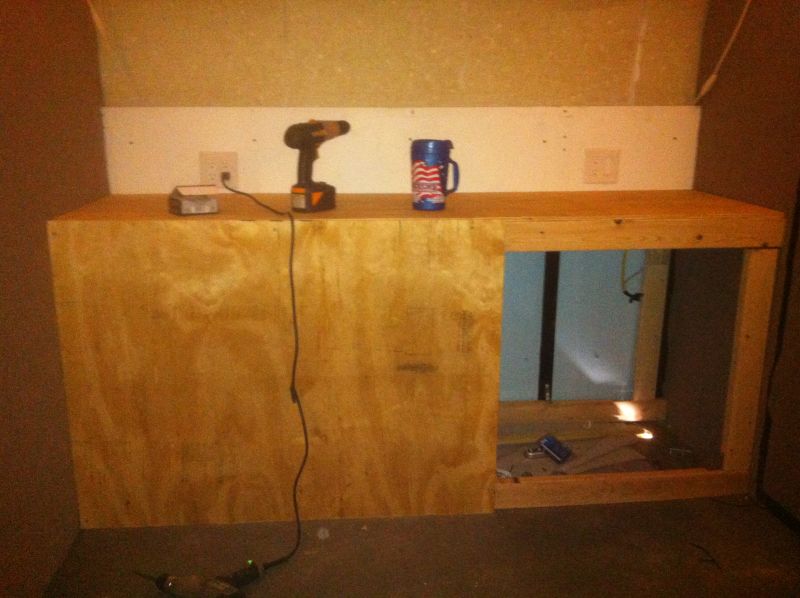

Straitened up the front galley and plugged everything in
Put a countertop and front on the galley
Now I need to get some cabinet doors, fridge, and build the upper cabinets. We were going to go camping this weekend but the wife got food poisening. :? That will teach her to go out to eat with out me.....Just dont tell her I said that :worship:

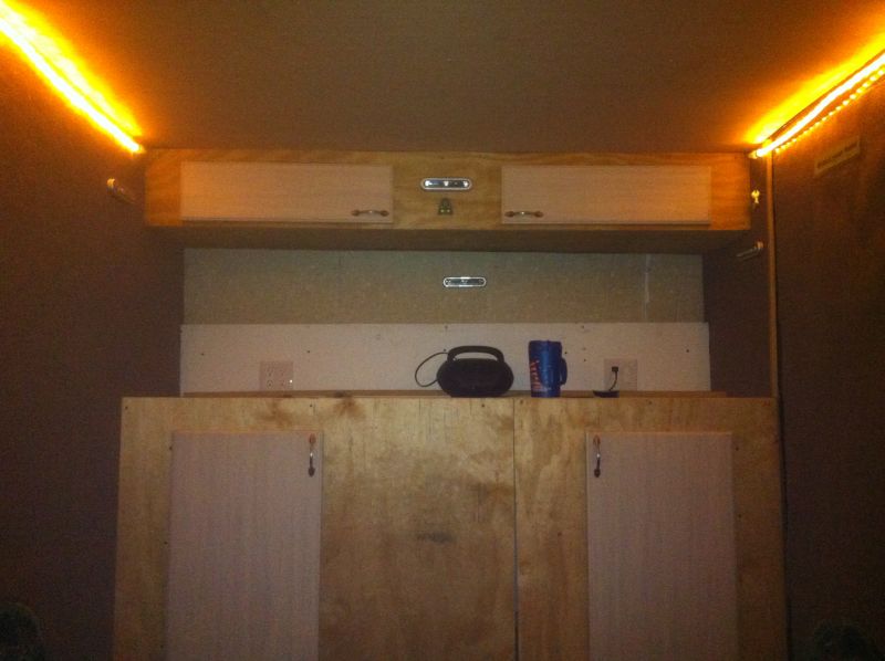

Got the cabinet doors installed. I picked up some at the Re-store like Don and Christy had done.
View from the back
Yeah I know there is a gap in the front of the plywood but I figure that is wear the fridge is going to go when I get one. I hope to get the sink this week and install it so we can paint the plywood. The counter top is just plywood and the re-store had some veneer that I might get to put on top. They also had some wood laminate floor tiles that I thought might make a good counter top. Had anybody ever used those for a counter or table top?

Postby Smiddyt » Wed Jul 18, 2012 6:15 am
I decided to make the front part of the lower galley out of one piece of plywood because I did not like the gap that was there. My wife did not care but I did not want people coming in for massages and seeing it. I bought another piece of plywood yesterday but it was raining when I got home so will work on it tonight.
