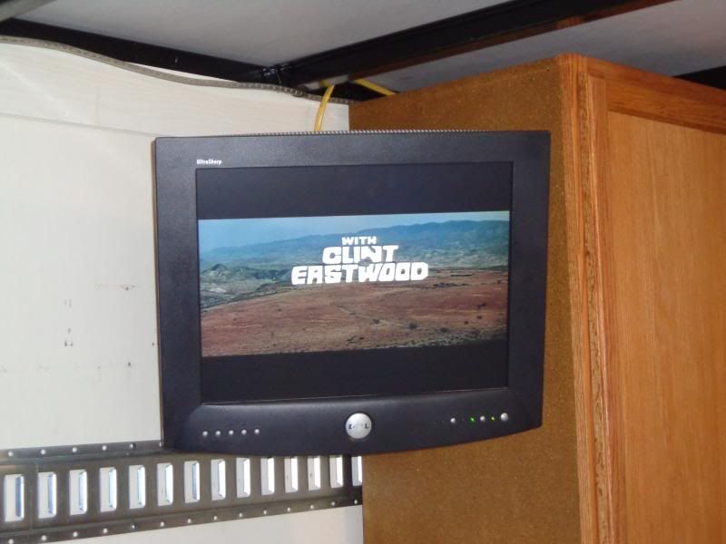

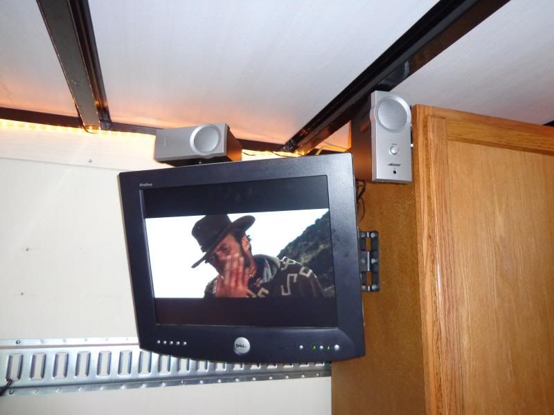

Postby gregert12 » Sat Jun 08, 2013 5:42 pm

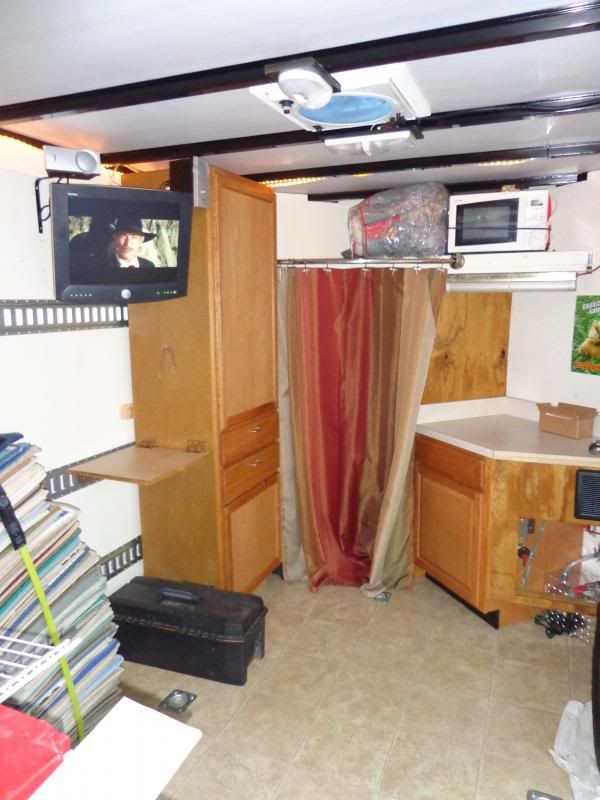

Found this on Amazon for $20 shipped (thanks Gadgetman for the item) and am reusing the spare LED desktop monitor, speakers and DVD player.
Also changed out the shower curtain to a real rod and curtain (to be hemmed.)

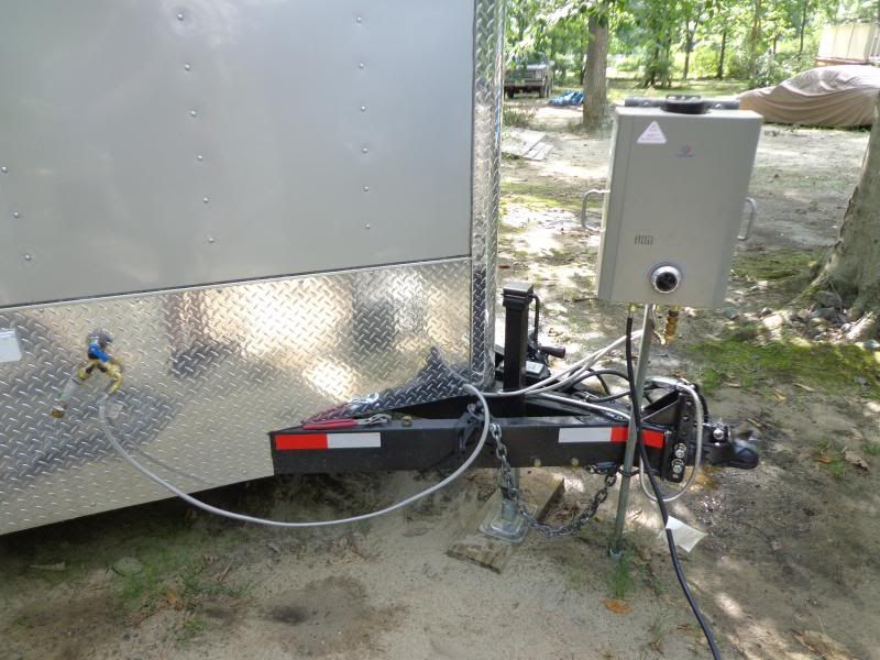

Postby gregert12 » Sun Jun 16, 2013 4:53 pm

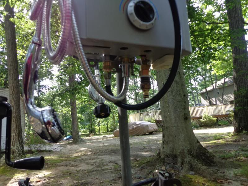

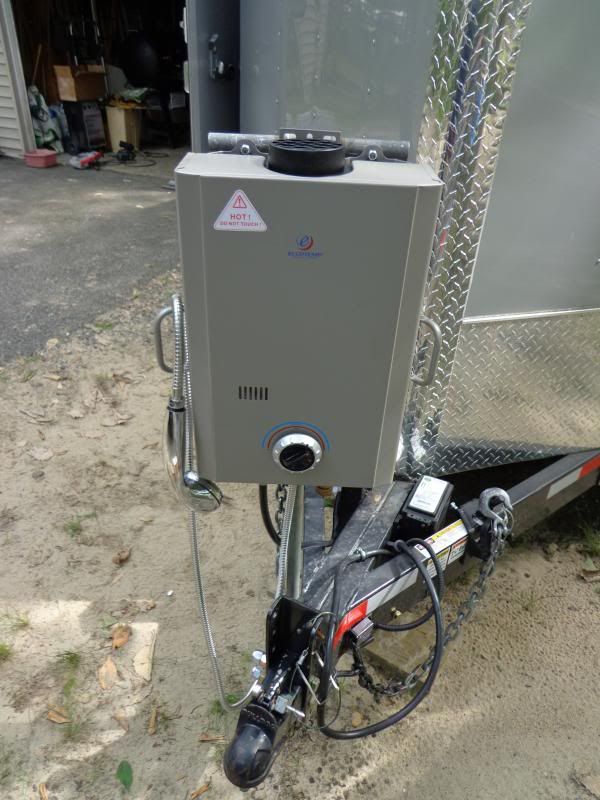

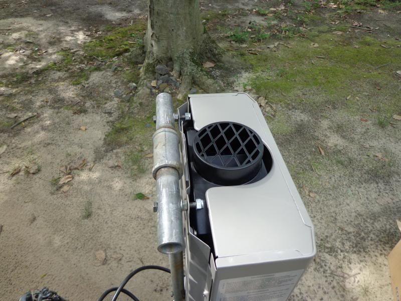

Here are the EccoTemp L7 and its mounting bracket (3/4" galvanized pipe and T fitting) fits into the safety chain bracket for an easy setup. The bottom of the galv pipe has a pvc coupler to break the ground in case of an electrical fault.
I only need a few more plumbing fittings and a 6" piece of 1/2" OD hose to reduce the quantity of water which increases the pressure to the heating unit.

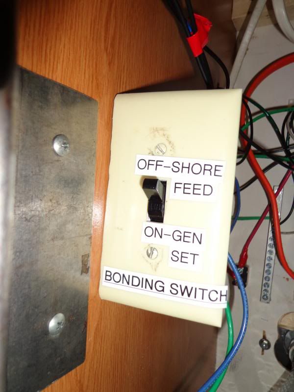

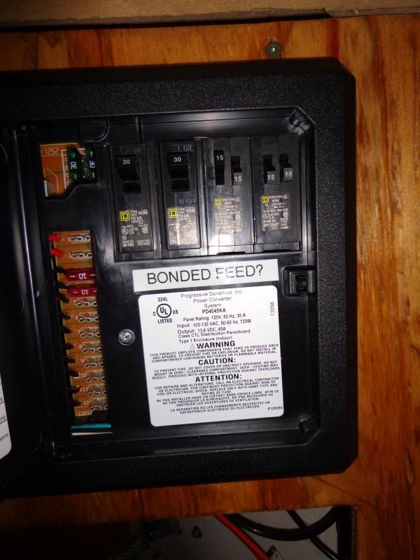

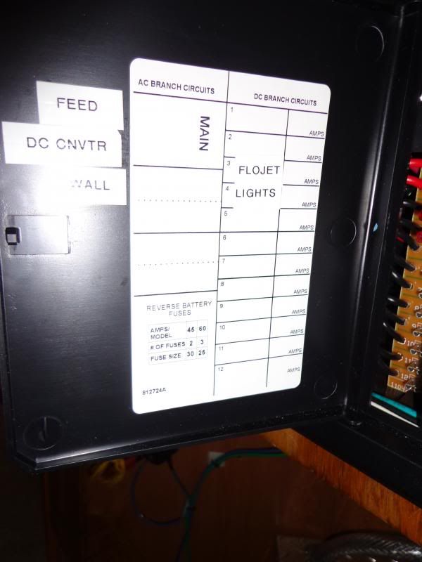

The electric is all finished and this simple switch bonds the ground/neutral since the Honda 2000i is not bonded. With the switch on, the converter panel is now the main service panel and must be bonded for the fault to travel to the generator's grounding lug and to the earth. When the switch is off, the neutral and ground are isolated since the only bonding jumper will be located at the main power panel at the house/campground and then seek earth. Since the ac/dc converter is technically a sub panel in this second situation, it is against code to bond the sub panel and the main service panel in the house/campground.
Labeled and the electric is done until i get an AC/DC DVD TV.
gregert12
Posts: 34
Joined: Tue Sep 25, 2012 3:44 pm
Location: NJ
Re: Denali toyhauler build thread (in progress) 060813

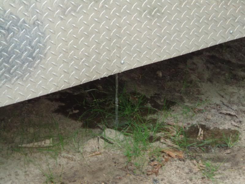

Postby gregert12 » Sun Jun 23, 2013 9:32 am

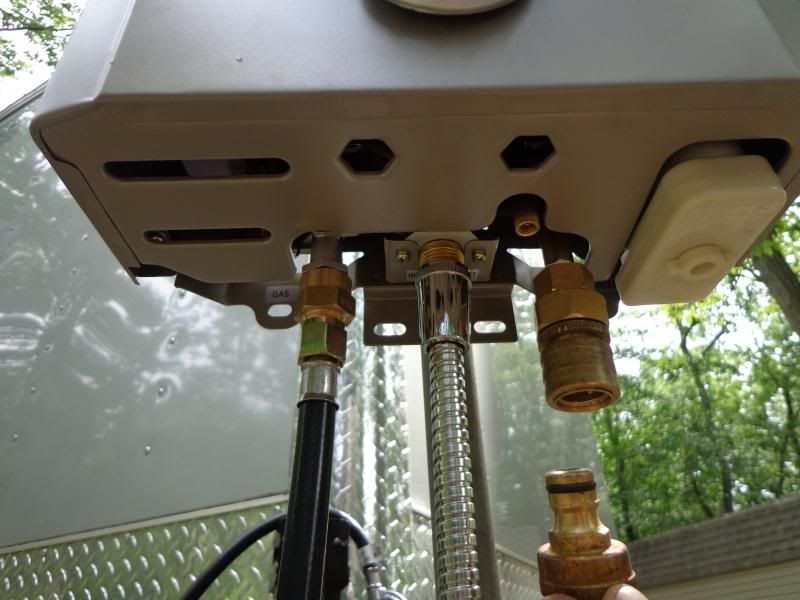

Plumbing is done. :D
Picked up from Lowes an 8' dishwasher connection braided 3/8" hose, both ends are compression fitting and an extra 3/8" comp to 3/4" garden hose fitting (~$2) to connect the spigot trailer side to hose for the water heater.
Just after the t fitting is a double ended female connection to connect the shore water to the trailer. It has to be double female since the shore output and trailer input is the same male fitting.
Tank drain works well enough.
