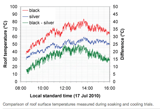

BUSTED - the link you gave in the headline, goes to a dead link, which does not have the information ....So you and MYTHBUSTERS are both busted.
On your second story which you claim you did not read here is the chart...showing 15-20 C difference.....
AGAIN a hell of a lot more than 10F..... more like 40 - 50F
Besides also owning a silver & WHITE are, the silver is already MUCH HOTTER vs white.
aa roof temp.png (84.49 KiB) Viewed 3139 times

Postby MtnDon » Tue Feb 16, 2016 1:31 pm
Graph is roof temperature. I thought the big concern was the interior air temperature?
The researchers had two cars in the sun for an hour, one black and the other silver, parked facing south, in Sacramento, California. The silver Honda Civic (shell SR 0.57) had a cabin air temperature of about 5-6°C (9-11°F) lower than an identical black car (shell SR 0.05).
Read more at: http://phys.org/news/2011-10-silver-whi ... r.html#jCp

Postby OverTheTopCargoTrailer » Tue Feb 16, 2016 7:17 pm
RESPECTFULLY MtnDon
I wish you would read YOUR OWN info CAREFULLY.....
Where does it say at what point the cabin air temp was measured ? Was it at the height of the heating cycle ? Was it at the low point of the cooling cycle ? Was it a average temperature between heating & cooling cycles?
I am clueless how you come to your conclusion based on the LIMITED given data ??
On a trailer my experience is inside temp tracks exterior temp.....SIMPLE the hotter the skin, the hotter the interior.
Cheers ottct
