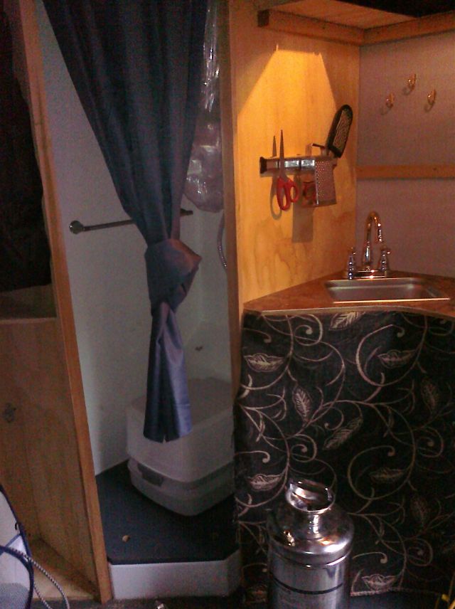

I used a platform on mine that sits inside the shower and makes a false bottom for use as a bathroom, if the shower is needed just remove the portable loo and floor and its ready to go.
nice trailer :D

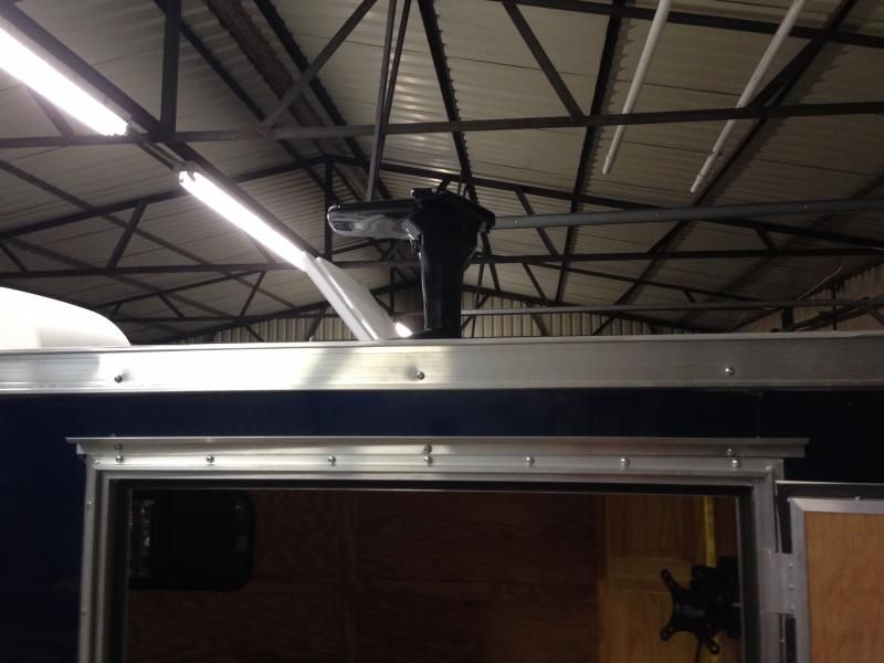

Got a little done this weekend but forgot to take pictures. Mounted the Antenna for the TV, works great. Got the black water tank installed and the pedestal built for the toilet.

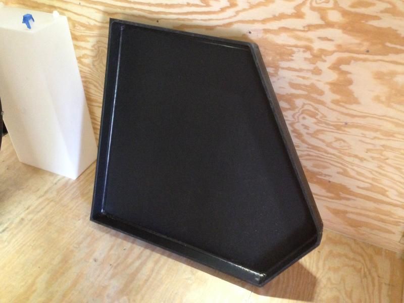

Bob, will do. Tonight I made a cardboard form of the shower floor and sent it with my neighbor to see if the company will make the pan. I'll hopefully know in a few days. The name of the company is "Custom Composites" and the material I believe is "polypropylene".

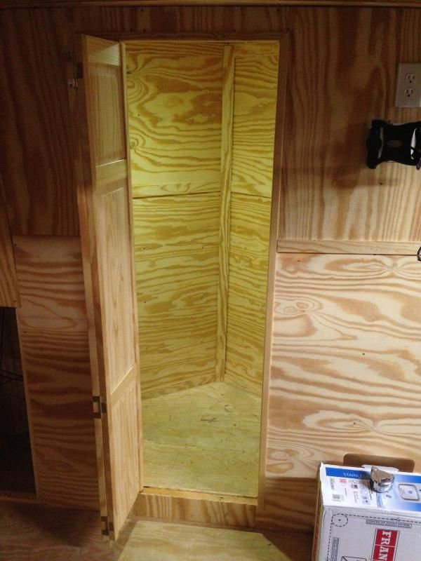

Here are a couple of pics of the shower area, I think it turned out pretty roomy. The 6 gallon black-water tank is in the pedestal under the toilet.
Ran out of trim for around the door, think it is looking good.
And here is a quick shot of the antenna.

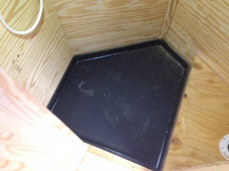

Postby Slyhuntr » Thu Jul 03, 2014 5:39 pm
Shower pan was delivered today.
It is a perfect fit.

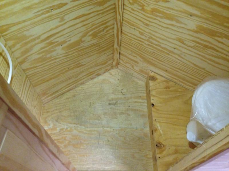

Postby Slyhuntr » Sat Jul 12, 2014 7:08 pm
Worked a little last night and today, temps have been pretty high here so it kinda slows the progress.
Shower walls installed, need to caulk them.
Vinyl flooring installed.
