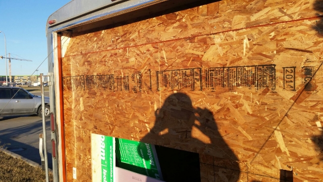

Wall two up.
This project is calling on my creative side more than I anticipated. Had it all worked out where my fancy duct tape would go, adding just the right amount of functionality and class... now its to chilly to work, adhesive isn't adhesive 8)

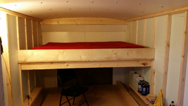

Sub wall from outside. Low door added for the dogs to access the screen room when warmer weather hits... and wide enough to slide my queen mattress through.
Mattress fits upstairs (stairs not included) luckily. Forgot to take the diagonal geometry involved with moving it from lengthwise on the floor to sideways up top into account.
Painting was supposed to happen at this point but the weather isnt cooperating... worried it would freeze on rather than dry... lol

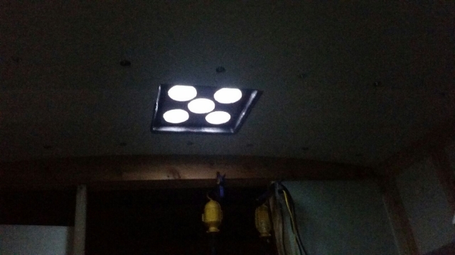

Finally plugging up that hole. Sort of lets a mirky light through... then again its mirky outside.
My nuts are cold. (See hung ceiling nuts from above). Was curious how much of a heat sink they'd be. May have to invent some sort of covers for them.
