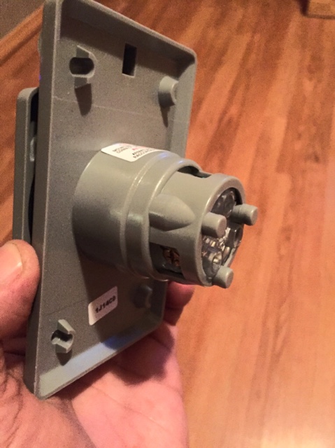

The cheap option won't work as I can't find a box. The top option works better as I can simply drill a hole and slide it in. I have a roll of butyl tape. I will add plastic box cover on the back as a rust-proof spacer to give a little more room in the plastic box.
abqlloyd
Posts: 273
Joined: Mon Aug 08, 2005 11:47 pm
Re: 6x12 V-Nose Build
Postby abqlloyd » Sat Dec 13, 2014 3:27 pm
Hole saw will make install easy.

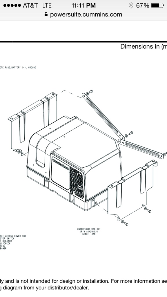

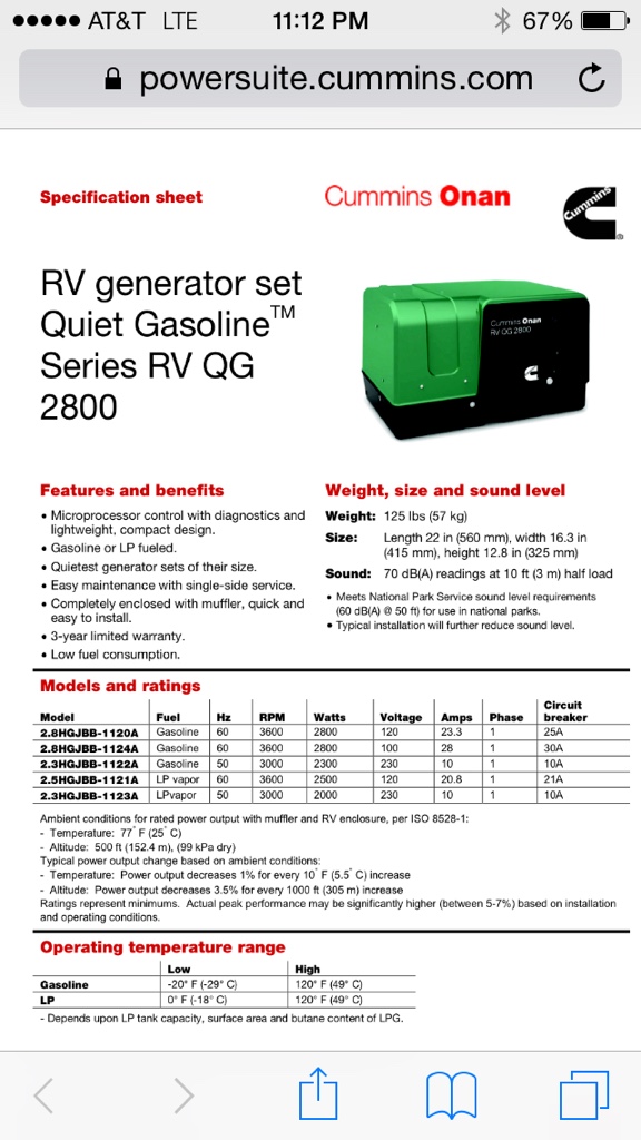

If money wasn't an issue and I had a little more room I think this would be the perfect solution -
Just mount it under the floor and put some sound deadening material around it.

I like coffee. A lot. An on-demand genset would make running the Keurig easy.
abqlloyd
