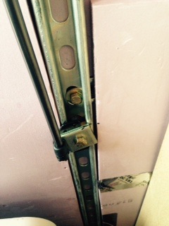

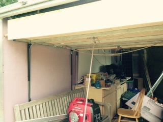

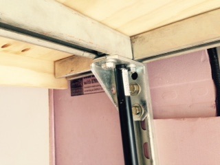

Postby wanabxtrm » Sun Sep 06, 2015 7:11 pm
I'm curious to see more detail on your bracket/slides. I think I have mine worked out but still have some binding issues if they get out of alignment. In the end I over estimated the bed weight so I need to physically pull it down vice pushing it up. Heres a few pics of it. Also what's your range of motion on it?
image.jpg[/attachment]

Postby monocog » Sun Sep 06, 2015 9:28 pm
Cindy, when pulling down from ceiling it takes some effort the first 6 inches, after that with 2 fingers I am able to pull it down, when putting it up the first 8 or 10 inches takes a bit of effort and then it rises on its own. I would guess 50 pounds of force for initial pull down, and 40 for initial rise.

Postby monocog » Sun Sep 06, 2015 9:37 pm
Wanabxtrm,
I believe I have 32 inches of range, I will measure and take pictures tomorrow. My bed frame weighs about 80 pounds, I used 84 pounds of force on all 4 gas struts. If you add unistrut parallel to your uprights, angle struts approximately 40 to 45 degrees you can get nearly full travel of the overall strut extended length. My struts only have a compression range of about 12 inches.
