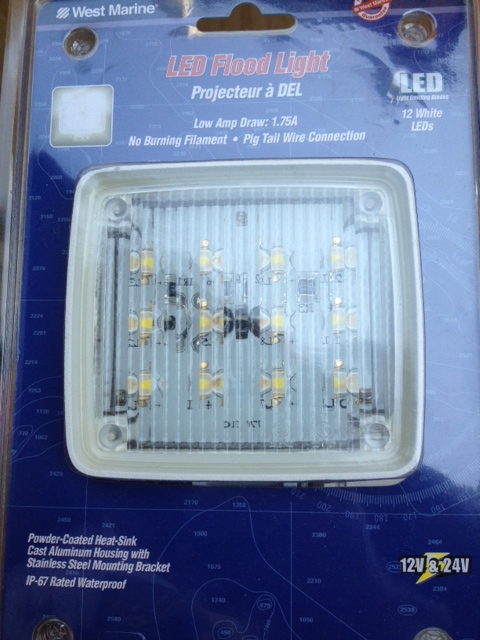

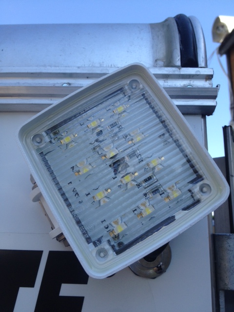

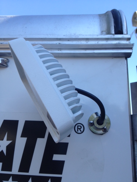

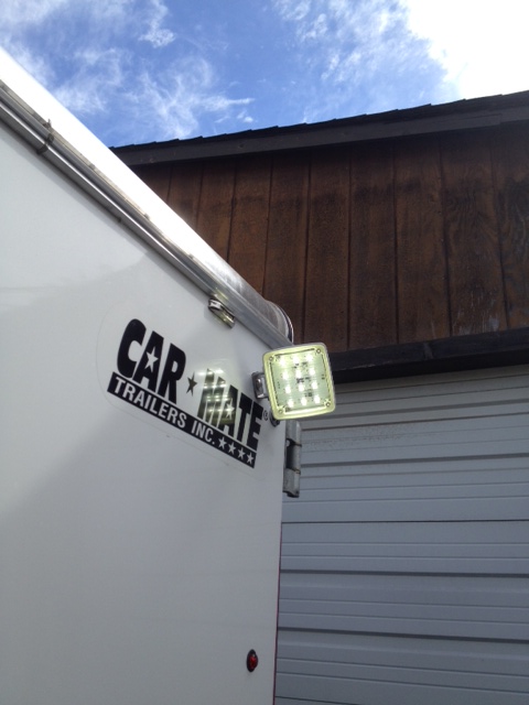

Here are some nice waterproof marine LED floodlights that I installed.
I installed on on each side, upper rear corner, they also fold flat.

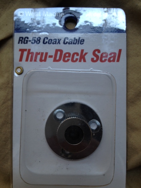

I used this Gizmo to run the wire through the trailer wall,
this stuff is mostly all for boats, so I'm sure it will be watertight on the trailer.
look at the picture in the previous post to see how it looks.

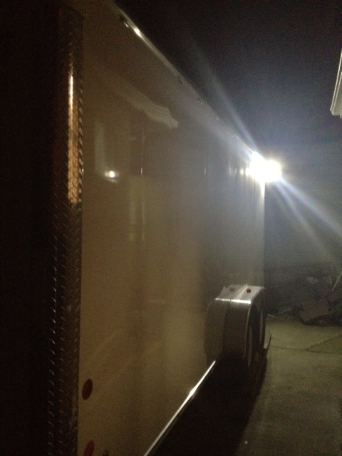

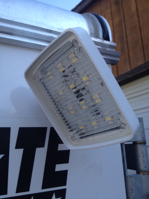

Here is a view with the LED light laying flat ,
I think the light has about / close to 900 Lumes -
trust me its VERY BRIGHT 8) 8)
slowly I'm getting there, Merry Christmas in June :R :R

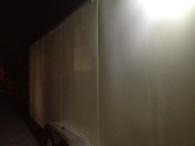

Here is a quick look at the new lights, they work great :thumbsup: :thumbsup:
Again they are much brighter then the pictures :thinking:
