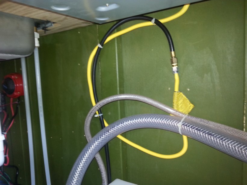

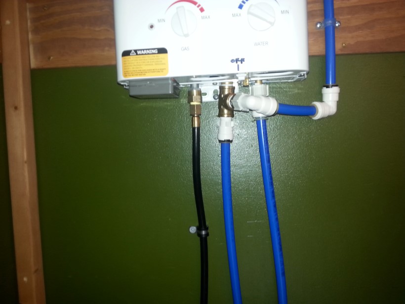

Ok. Hot water heater is plumbed in. What an awesome set up. I can hold my hand over the top of the heater indefinitely when running hot water.
For better or worse, I'm using separate hoses for each appliance. They are new, and for the most part entirely in the trailer. Protected from the elements and very easy to check fittings with wrench prior to use. Even the internal stove fitting. I will turn off all gas prior to hitting the rack. I may leave the little buddy tank valve on so I can turn the unit on in the middle of the night briefly.
There will be two detectors. One under the counter and one in the cabin somewhere. This is my call after weighing it all out. Usage, practicality, material, and money.

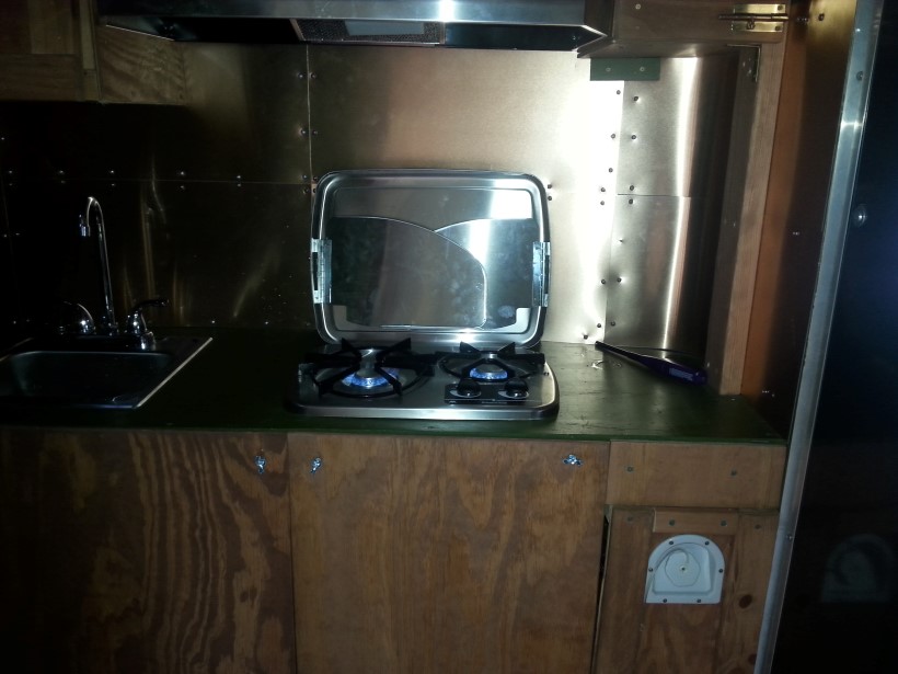

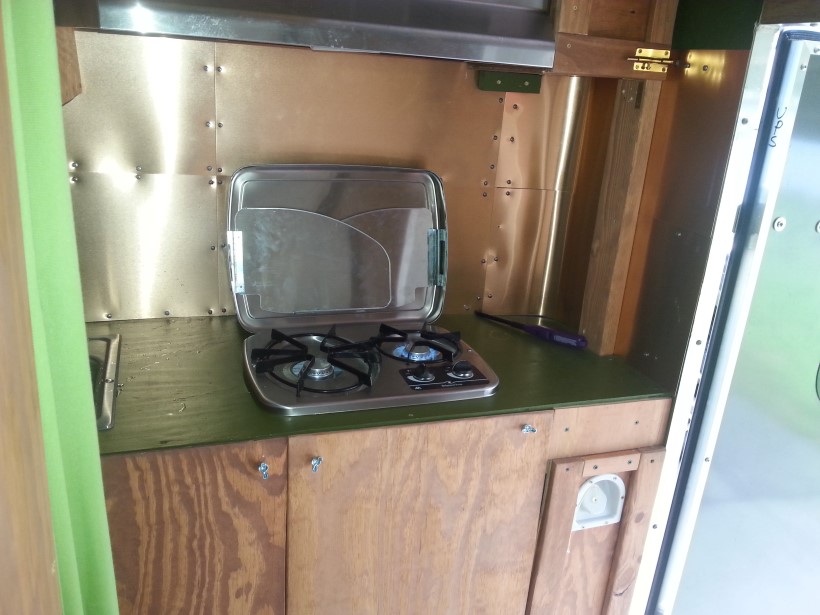

Finally hooked up and mounted the stove.

Dang if that doesn't look outstanding. :thumbsup: . Have to ask, did you use the YELLOW Teflon tape
for the propane fittings? The white doesn't play well with the gas, is why I ask.

Postby Tommy B » Sun Aug 28, 2016 9:24 am
yes sir! yellow for sure. I did notice how much thicker and tougher that stuff was.

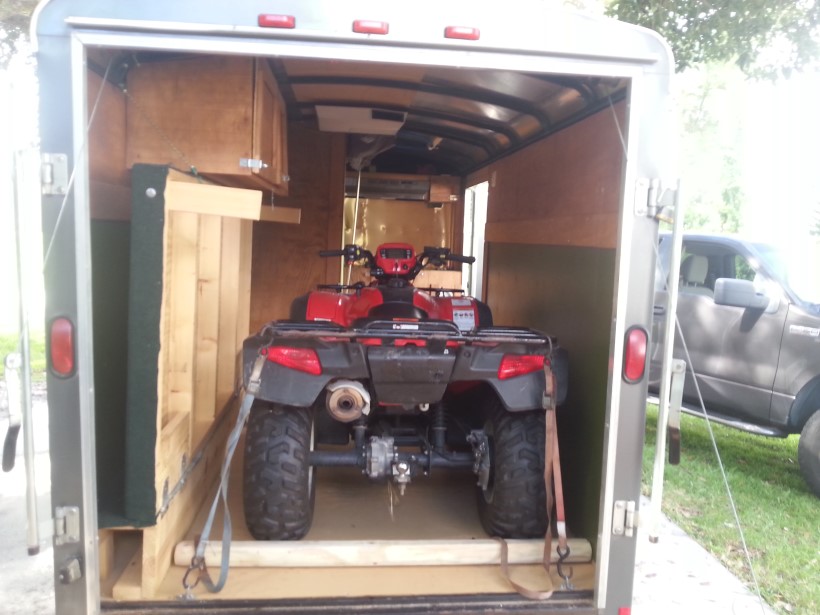

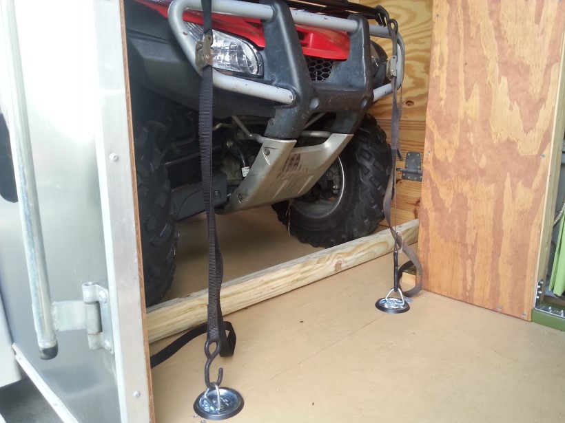

Finally getting to the end. Here are a few more pics.
The full size wheel chocks are awesome and will be kept in the back of the truck or in it. The ATV is rock solid. The KTM will go in the back of the truck. Still plenty of inside storage for table and chairs, two coolers and a that grill less the propane tank. Another 10 foot hose and I'm good to move that grill anywhere close. ( see previous camping picture ).
