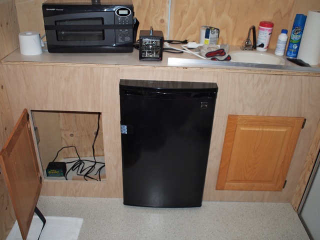

Postby d30gaijin » Thu Sep 15, 2011 7:19 pm
Made a bit more progress today. Did the cutouts for the doors into the oak plywood then mounted the doors with hinges bought at Home Depot. I actually got every thing pretty darn straight, which is good for my woodworking skill level. Then I installed the oak ply with the doors attached back into the CT to make sure I wasn't too visibly off.
Next I'll disassemble it all and orbital sand the oak ply then stain and varnish it to match the cabinet doors I bought at Habitat For Humanity. While I bought them at a used price of $4 each the cabinet doors are essentially brand new so I do not want to strip and refinish them. Much easier to make the bare oak ply match the cabinet doors.
I also picked up an 8' length of 1" thin aluminum angle for the counter top cap. I am getting closer to finishing off the galley and then will move on to the wall paneling.
Once the wall paneling is in I can then insulate the upper corners where the wall paneling meets the roof Luan paneling and panel that area in. Once that is done the inside of our CT will be mostly done in terms of finish. From there I'll concentrate on over head storage and conveniences to make the CT more livable.
I know this is all probably pretty basic and simple for those of you with experience doing cabinetry/wood work but I don't have any experience doing this stuff so it is a major undertaking for me. Still, I am very happy with what I have accomplished so far, due in large part to all the help and expert advice I have received here on the T&TT CT Conversion forum. I thank you all sincerely. :applause:
Pic below shows what I accomplished today (yes, that is trick photography GPW. Like I said, I can't seem to hold a camera straight, hot, and normal). :oops:

Postby d30gaijin » Fri Sep 16, 2011 7:36 pm
Wolfscout wrote:@ don and others...
have you noticed a need to do something about the refrigerator door coming open during travel?
I ask because other weekend I pulled mine across the property and set up for a weekend. the fridge door had come open in the travel. small mess I was lucky.
When I took it to the Welders other day to have him weld on a new folding Jack.. I noticed, upon checking inside, that the frig-door had come open again in travel. So I grabbed the cordless drilling... and sank in two eye bolts so I could bungee it shut.
I'm sure that will work when I bring it home. LOL
Wolfscout,
Yep, had the same problem and you can see my cure for it in the photo above. Left hand side of the reefer door, about 1/3rd of the way down from the top of the door you'll see a sort of white square spot on the door. That's a Velcro strap. I went to the wife's favorite fabric store and bought a 2' long strip of 2" wide Velcro with a sticky backing (peal away and stick it in place where you want it). I stuck a piece to the side of the reefer and another on the door then ran the opposing Velcro strip between the two. It keeps the door closed when traveling and is simple to remove, as typical of a Velcro strip i.e., just peal it away. It also works great for keeping the door partially open when the reefer is in the off mode and I want to let it vent so moisture doesn't build up inside. Open the door a tad and put the Velcro strap in place and it is solid enough to keep the door open to vent the reefer when not in use. No bolts no awkward bungie cords.
Don

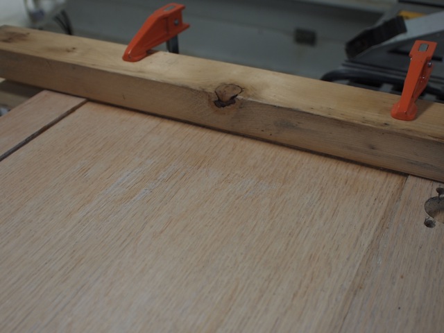

Well, as they say, "The best laid plans..." re: the cabinets and doors. I had hoped to match the oak plywood to the color of the cabinet doors I bought but that didn't work out. We had Minwax golden oak stain on hand and doing the initial stain and rub-off it looked like it would match the cabinet doors, and initially it did until I put the two polyurethane semi-gloss coats on. Once dry the oak plywood came out a considerably darker finish. It looks great but is darker. Consequently I had no choice but to strip the cabinet doors of finish so I can try to match them to the oak ply.
I spent most of today stripping the cabinet door finish off using Jasco, steel wool, and water. Bad move. I got the finish stripped but the water caused the door construction to start to warp as they dried, thankfully only on small edge areas on the back side where the door is glued together, I am thankful for good tongue and groove construction, which only pealed up slight, as I said, on the back side.
So now I have squirted some wood glue into the partially separated wood along the horizontal axis top and bottom and clamped it tight with a heavy piece of pine and two clamps and will let that set overnight then do the same with the slight vertical separation tomorrow... and that's just for one door. I'll have to do the same for the other door so that puts me a few days out for staining and final finish on both doors. :thumbdown: I could get by without doing that but then if someone opens the door they might notice the slight separation on the backside (doesn't show at all on the front side of the door) and I can't live with that.
The first photo below shows the separation (what looks like a black line). If you look close you can see the inside of the edge frame wood curling up/away from the back side center inset of the door.
The second photo shows the wood clamps and heavy pine in place after squirting glue into the separation and clamping it in place.
A lesson learned; don't use Jasco stripper, steel wool, and water to strip and wash a glued together wood structure (as the wife told me once she got home and I showed her what I had done... she knows a lot more about stripping wood than I do). In my defense I've always used Jasco, steel wool, and water to strip paint off of metal... why would wood be any different :oops:)
Don

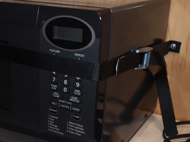

Postby Wolfscout » Tue Sep 20, 2011 5:07 am
Don, are you using long velcro straps to secure your microwave in place?
I was considering taking some nylon strapping and to the all to bind mine there. Perhaps with some quick disconnect type buckle like my backpacks have.

Postby d30gaijin » Wed Sep 21, 2011 12:34 am
Wolfscout wrote:Don, are you using long velcro straps to secure your microwave in place?
Wolfscout,
I am using a 1" nylon strap bought at Home Depot to secure the microwave. It came with a simple cinch type metal buckle. I cut the length to fit, melted a hole in it to put a screw through (via a small tipped soldering iron) and screwed the strap to the the wall using a washer (see photo below).
I hope that helps,
Don
