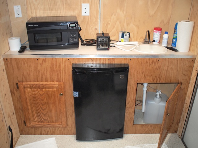

Galley Cabinets Finished
Postby d30gaijin » Thu Sep 29, 2011 3:03 pm
The lower galley cabinets are finished. :beer:
It was more work than it looks like, mostly due to the time it takes to stain, wait 24 hours, apply varnish coat, wait overnight, sand, coat again, wait overnight, sand, coat again, wait overnight, sand, etc. But it was worth the time and I am pleased with what I made, again considering my lack of wood working experience.
Next I think I'll go ahead and tackle the upper galley area, maybe build some shelving/cabinets.
Don

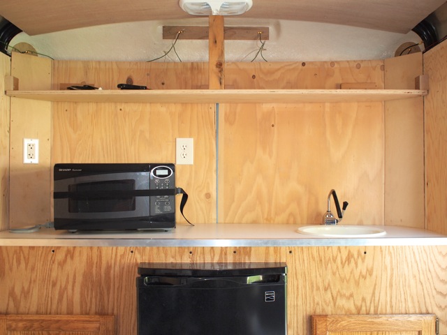

Galley Overhead Start
Postby d30gaijin » Thu Sep 29, 2011 6:32 pm
Along with the lower galley cabinet install I also got started on the galley overhead cabinet today. The upper galley cabinet bottom was cut and installed today. The center support beam shown in the photo was glued and screwed into place (glued at the top where it mates to the luan paneling and screwed to the bottom of the shelf). The reason for a center support beam is twofold; structural support of the cabinet center span and because I have two left over pieces of 3/4" thick oak plywood I used for the galley lower cabinets that measure 24"x48". I will use them to make the upper galley cabinet face. It would be nice to have a one piece cabinet face but that would take a near six foot piece to span the full width of the upper galley. I don't want to spend another $44 for a 4'x8' sheet of oak ply just to get a one piece upper galley cabinet front face so I will make the front in two pieces with a parting line in the middle of the upper cabinet. The center support brace is where the two pieces will meet and be screwed into same.
I'll need to make a cardboard template to match the CT inside roof contour then trace that to the oak ply and cut it to fit. Once I get the two upper galley front face pieces cut to fit (more jigsaw work that I am not looking forward to) I will then go in search of suitable small cabinet doors and, when found, will cut openings for them in the upper galley front face.
Any suggestions for an easy way to make a template that follows the CT inner roof contour would be greatly appreciated.
Don

Postby pete42 » Fri Sep 30, 2011 1:29 pm
You could make the cabinet face frame from separate pieces of wood
looks sort of like an 8 on it's side.

Postby denmohr » Fri Sep 30, 2011 2:57 pm
Don, I see your dilemma, how to match the "curve".......but, are you going to finish off the area between the wall and ceiling?
If so, that should be done first. Install that 1/4 round "cornice", for lack of a better word, run it a couple inches into the "cabinet space", past where the face frame of the cabinet will reside.
Once that is installed, take a piece of cardboard and place behind that 1/4 circle and scribe the curve. Done. When you make that face frame, make it 1/8" oversize on both sides..........it will snap in there and you have a perfect fit. OH,, when installing the "cornice, don't attach it to the structure (at least 18" from the proposed face frame location)...till the face frame is in, just in case you need to shim it out to make a nice clean fit.

Postby CarlLaFong » Fri Sep 30, 2011 7:41 pm
To match the curve, get a piece of cardboard the width of the finished cabinet. You can tape several pieces together if necessary. If it's not stiff enough, staple or tape a piece of wood to the back. It doesn't have to be pretty. Hold the cardboard in place, as high as it will go. Take a compass (the kind you draw circles with) and set it to the width of the gap at the center of the ceiling. A bit more won't hurt. Holding the point against the ceiling and keeping the compass as vertical as possible, draw a line on the cardboard. If a regular compass isn't wide enough, make one from a couple of sticks, a nut and bolt and a pencil taped to one stick. Sharpen the other one. If you have a steady hand and, maybe, someone to hole the template for you, you should have scribed a line that matches the profile of the ceiling. Cut along the line and test fit. You can make final adjustments and if there are any gaps, tape additional pieces of cardboard to it to fill them in. It might be ugly as sin when you are done with all of the tape and patches, but it's OK. Once the fit is to your standards, transfer the profile to your wood that you will be using. Carefully cut it out and, VOILA, there ya' go.

Postby GPW » Sat Oct 01, 2011 7:54 am
Carl, that’s exactly the same method we used in the late 70’s for making templates for the paneling inside Kustom Vans.. Worked Super !! :thumbsup:
