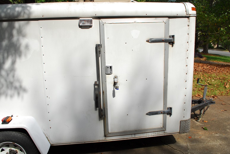

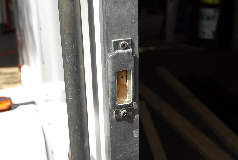

So finally some progress over the weekend before the rains came in. Saturday with the help of a friend, took the plunge and got the RV door latch installed. The only real difficulties were making the hole big enough to angle the actual lock in, and cutting the spacer between the door and the inner handle. It looks square from the outside, but actually has a lot of intricate cuts behind it to fit the screw holes and not interfere with the mechanism behind it. Pleased with how it turned out and the functionality (smooth closing, no binding, etc).
Pictures of course!

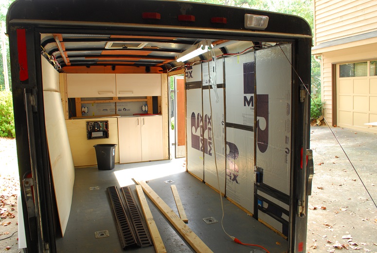

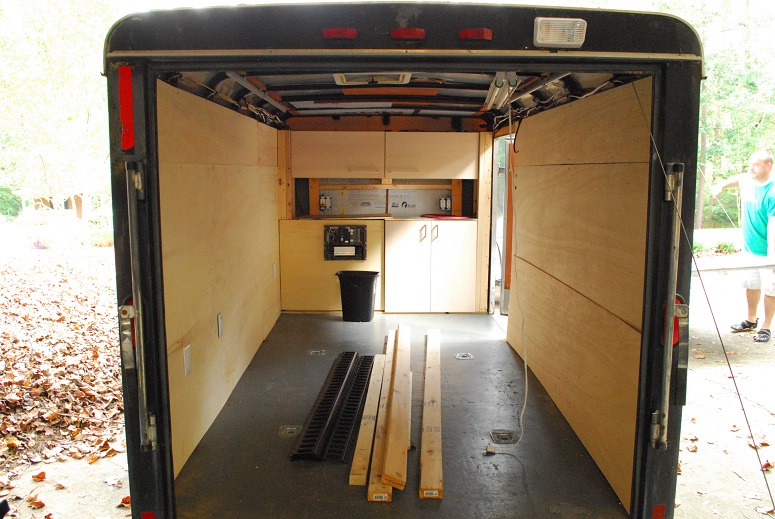

Sunday progress seemed a little more noticable. Finished the in wall DC wiring on the right wall (still have to connect some things between the sides and the main runs running foward), and removed the side door lock bar. I needed to be able to get the remaining old interior luan out from behind the bolts, which involved 2 coming out instantly, and 2 requiring 30 minutes of dremeling and some choice words. I ended up replacing all of the bolts when I put up the new plywood on the inside. I did get the rest of the plywood up on the right wall (the picture looks a little funny, there is a 4x8 sheet on the bottom and a 1x8 strip at the top. What looks like a third segment on the bottom is just my remaining plywood for between the front cabinets. I also got the remainder insulation I had on the ceiling, and looks like I will need another sheet or 2 to finish up (which I expected).
I also got my replacement switch for my DC panel in the mail yesterday (panel has 4 switches, and 1 was momentary, so ordered a replacement that is just an on-off), and hope to get that installed this coming weekend and finish up the DC wiring, along with the backsplash area. It is slowly getting to the usable stage, but still trying to work out how to do the work benches.
