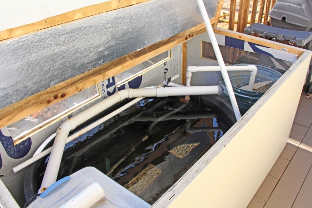

In case you are wondering what a shad tank is, here is a shot of it. I catch Gizzard Shad and Alewifes and use them for Striped Bass fishing here at Smith Mountain Lake.
