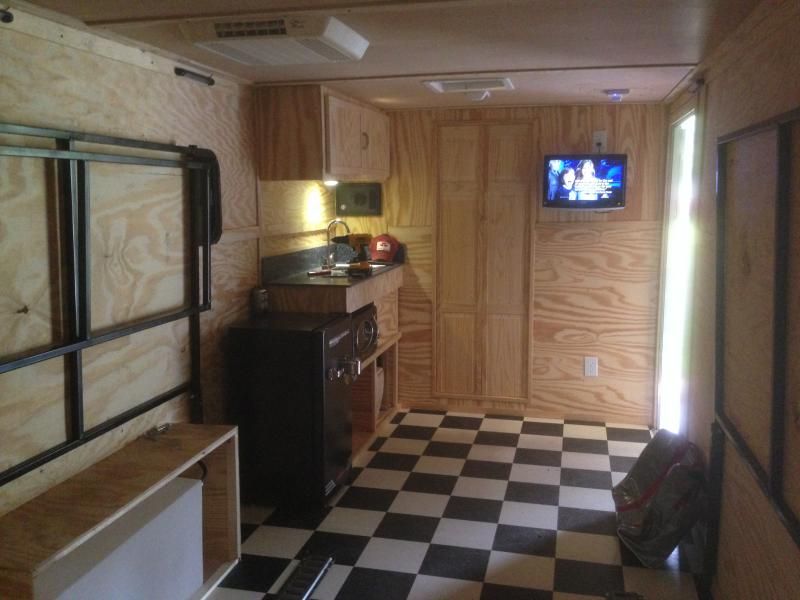

I have gotten a lot done since the last post. Plumbing is complete, all water lines ran in Pex. I haven't hooked up and tested the pump yet but will shortly.

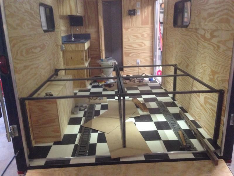

Shower curtain track is installed and just need to get curtain and a couple of towel bars and the toilet / shower area will be complete. I built the bed frame over the weekend and it turned out very well.
Just have a few cosmetic and convenience items to install but the insides are pretty much complete. I need to apply the roof coating, probably do that sometime this weekend.

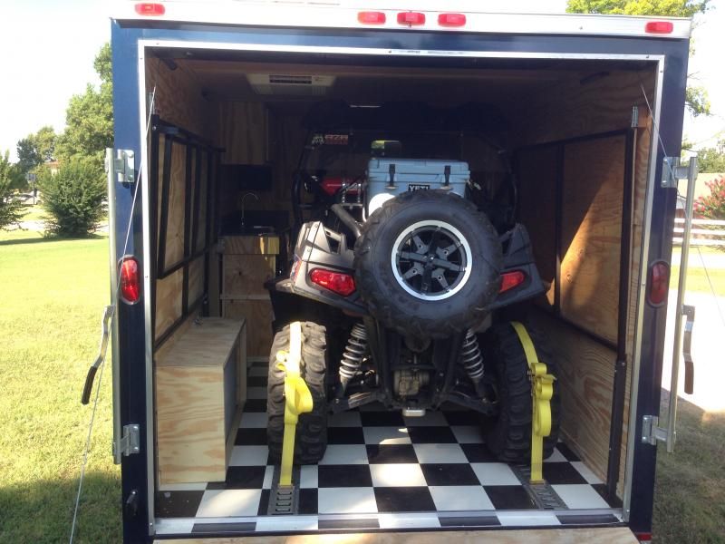

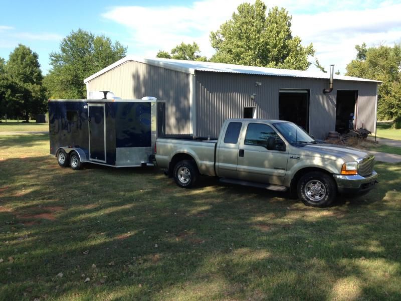

Here I had loaded the RZR and filled the water tank full for a test pull with our 2003 Quad Cab Ram. The Ram takes the tongue weight perfectly, but is lacking in the power. On flat roads it did fine but we all know roads don't stay flat and we do go to the mountains to play with our RZR. Fortunately we have a 99' Durango with a 5.9L that pulls just fine, but it doesn't like the tongue weight so I ordered an air bag suspension kit to hopefully take care of that.

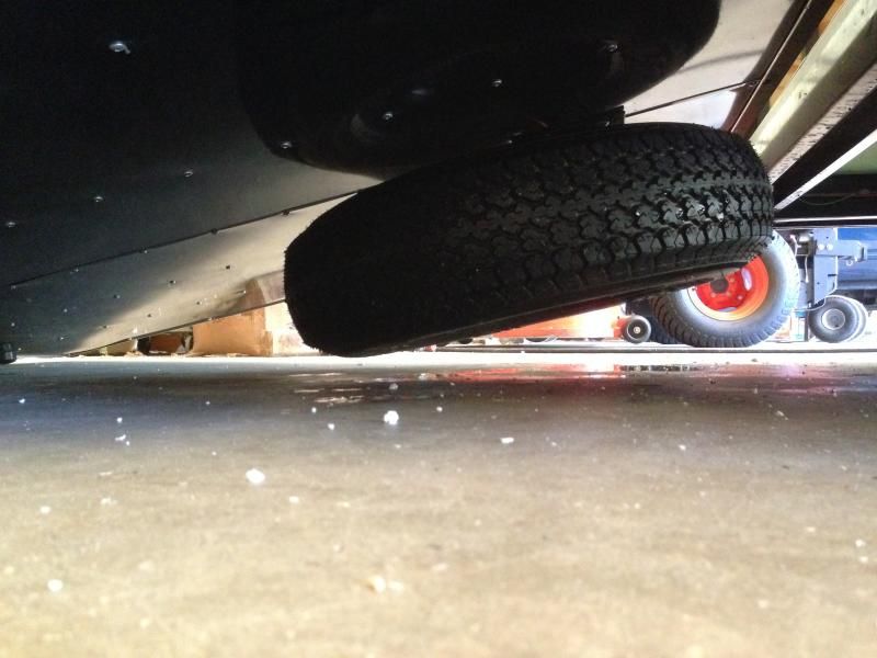

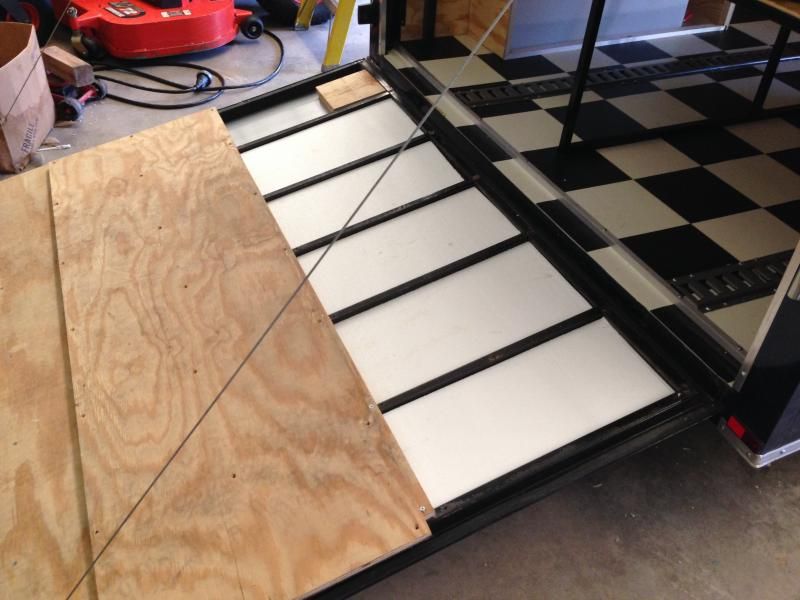

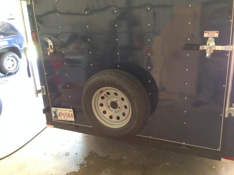

Decided to mount the spare on the exterior of the ramp door.

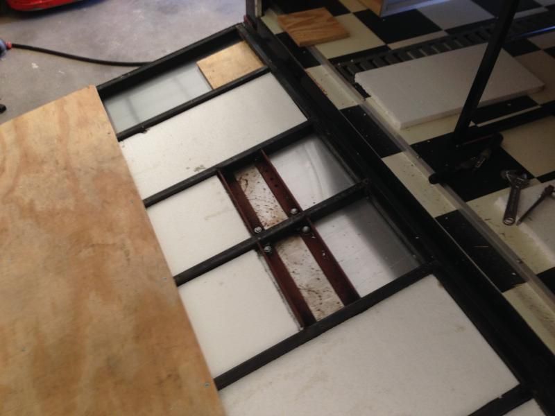

Here I pulled of some decking to reinforce the door.
Here it is mounted.
Plenty of room when ramp is down.

That is a fantastic location for the spare and I am going to steal it....;-)

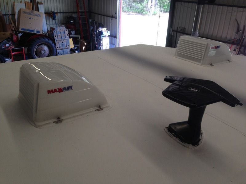

I decided after one trip to Lake Murray towing with our 99' Durango with a 5.9L engine that pulled fine but could tell it was working that we needed an upgrade on the tow vehicle. I did some serious searching and found a 01' F250 Super-duty with a 7.3L Power-stroke Turbo Diesel with less than 80k. Plenty of power and then some, room for upgrade if the need to arises on the toy hauler department. I installed some vent covers so the two vents could be used in the rain and also could remain open while in transit. Pretty much everything has worked like a champ. The air mattress was a "Fail" as it leaked the first time we used it. I have since took two memory foam hospital mattresses and made one two piece Queen mattress that is rather nice.
90 gallon tank in bed, some serious range there. :twisted:

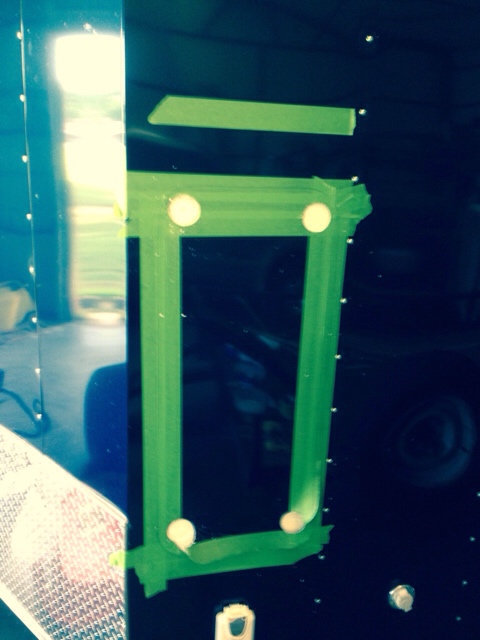

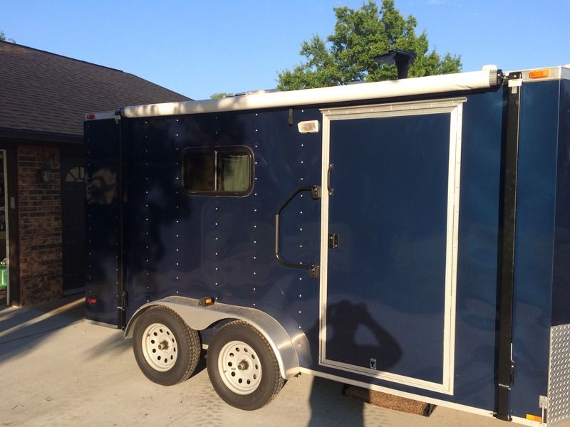

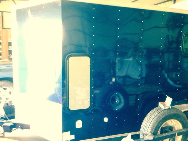

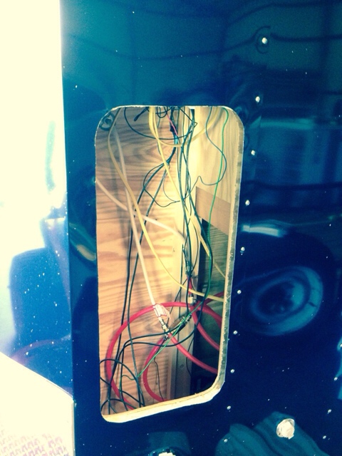

Reclaimed some lost space today behind the shower and sink area
Just need to find some Krylon to match close to trailer. Got the door off eBay.
Here it finished.
Vent covers.

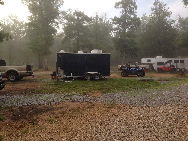

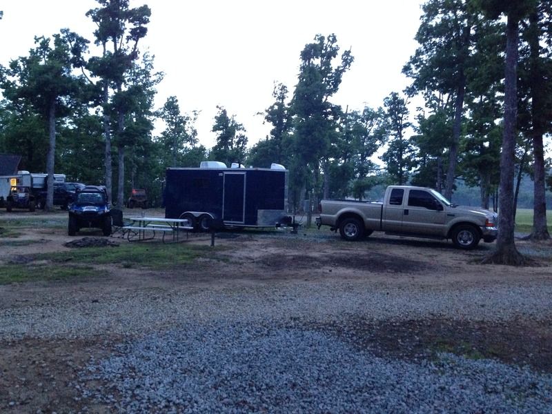

Loaded and ready to go. We had a tornado hit near us the night before and had tons of tree damage at our place.
Camping at Mulberry Mountain near Cass Arkansas
Worked like a champ. No problems and very comfortable, thinking about adding a awning though as it rained most of the time we were there. I actually tied up a tarp and used it for a awning which worked pretty well.

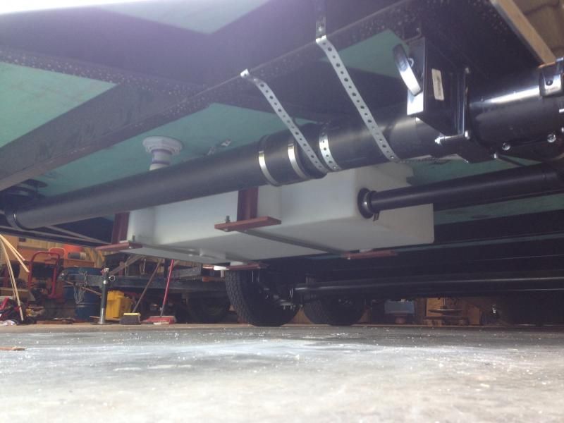

Nice rig. One question, is your "Black Tank" the 3" ABS pipe between the Toilet and the slide valve or do you also have a small tank under the raised floor as well? Forgive me if you posted that, I may have missed a page or two.
Have you had any "solids" buildup issues in that long pipe run?

I installed a 6 gallon tank in the pedestal below the toilet. Before I went to drain it at Mulberry I "topped" it off with extra water so I would have a good flow to clear the line, did too well as it about blew the hose off the dump station when I opened the dump valve.

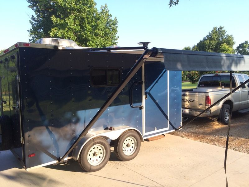

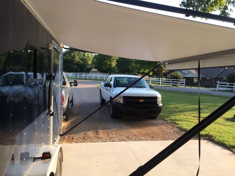

Postby Slyhuntr » Wed Aug 05, 2015 10:14 pm

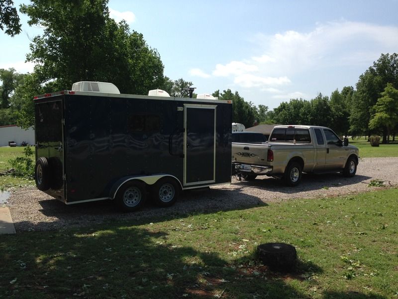

Added an Awning this week.

Postby aggie79 » Thu Aug 06, 2015 10:20 am
Fine job on the awning install! I really like your CTC. :applause: :thinking: :applause:
