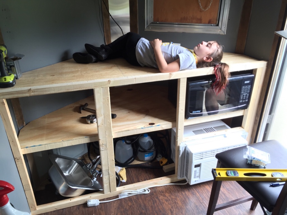

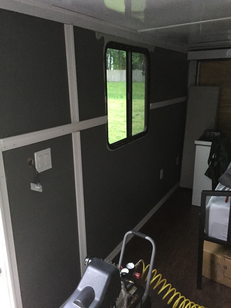

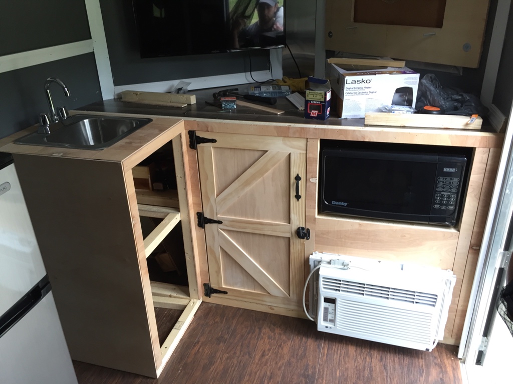

Well figured I'd revive my old thread. I'm currently remodeling the inside of my CTC since it didn't work out like I wanted it to. Here is the update of the cabinets I am building and the new paint so far. Much more to go!

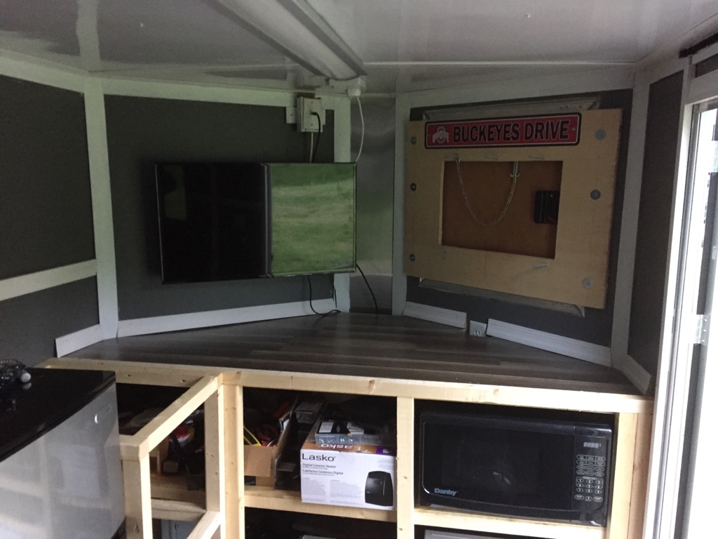

Postby Gunman9 » Mon May 02, 2016 2:10 pm

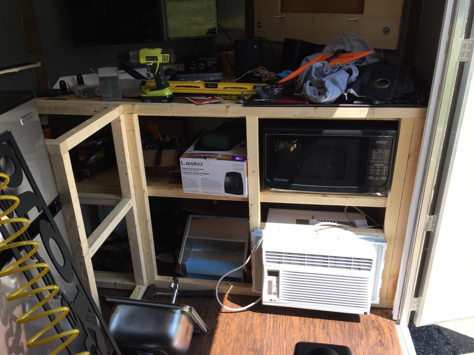

More Progress pics of the remodel.

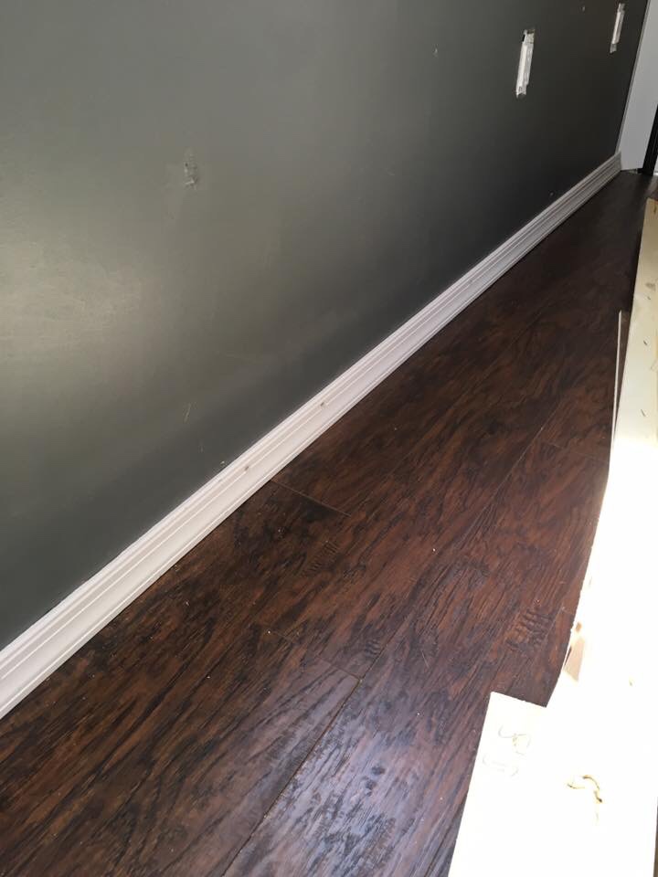

Postby Gunman9 » Thu May 05, 2016 4:30 pm
Gunman9

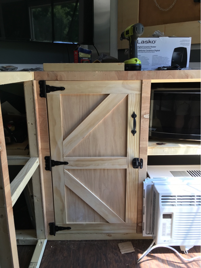

Built one of the doors for my cabinets today

Somebody has some carpentry skills. I'm likin' it. Couple things, 1st what material did you go with for the counter top?
Also, I love that door, and had to take a double take when I saw it. I am using an almost identical design of door to separate the cargo/garage area from the galley. Mine is actually a 6 ft hand built door that is over 125 yrs old, that I have been holding on to for over 20 yrs. It was the door to the "Ice Room" in our house that originally was the cooler before electricity, when ice blocks were cut from the Yellowstone River and delivered thru a shoot in the outside wall. I have another door just like it that went to the "Coal Room" that fed the furnace. It is nice, but has the coal dust all in it.
Anyways, I like what you are doin there, have fun!

Postby Gunman9 » Tue May 17, 2016 2:27 pm
McDave wrote:Somebody has some carpentry skills. I'm likin' it. Couple things, 1st what material did you go with for the counter top?
McDave
Thanks McDave.
For the countertops I just so happened to be at lowes and looking in the clearance section and the had 1 bundle of this laminate floor for $10 and thought that would make a great countertop. So I framed it all out, but down 1/4 plywood and then installed the laminate ontop of that. It's free floating to allow it to expand and the trim holds it in place very well. Does move at all and is level.
The door turned out great! I didn't originally plan on going for the old barn look but it just kinda happened the more I thought about it. I used 1/2 oak panel with 3/8 thick 1x3 for the framing. Brad nailed with 5/8 nails on the backside and wood glue. Very light and sturdy build. I still have one more exactly like that to put where the sink will be. Trying to decide now if I paint it all white or paint the trim white and stain the oak panel. All the trim of the cabinet will be white.

Postby McDave » Wed May 18, 2016 12:44 am
Beautiful. I will just throw this out there. My doors have what I would call a rough finish. I cant really see saw blade marks and it has a grey to white color but not painted, possibly just weathered? These are 1"x6" planks that are held together by the frame. The edges that are butted up next to each other are amazingly tight and straight. In fact they are very well made, but not like an interior finished door. I'll try to get at least one out of the cellar next week and take a pic. Just an idea, maybe whitewashed, still translucent but with some color/stain. Possibly some faux-tina/light distressing or ageing? Any way you go I love that style where the form follows the function. Simple but strong and the distinctive look that sets the tone and feel.

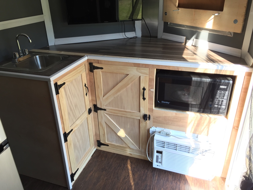

Added some more finishing to the counter. I cut the other door but need to order hinges since lowes can't find 30 of them lol

Postby Gunman9 » Tue May 24, 2016 9:43 pm
A small update
