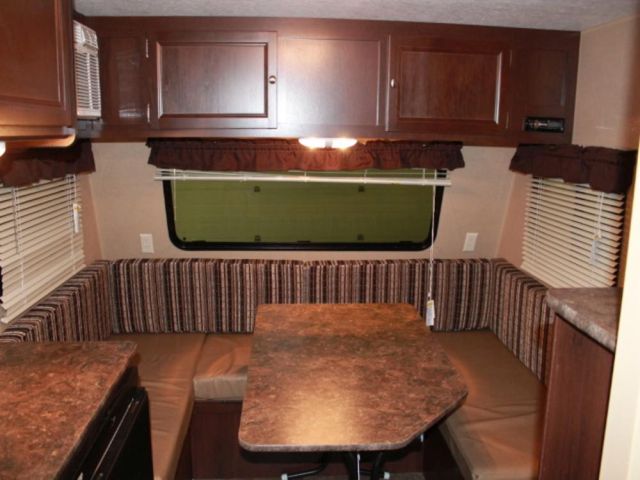

Here's a couple of pictures I pulled off the ole interweb of the AC install I was telling you about I saw this weekend that gave me my ideas.
This is an interior shot of the install. Image
The AC is mounted in a upper cabinet on the left in the picture.

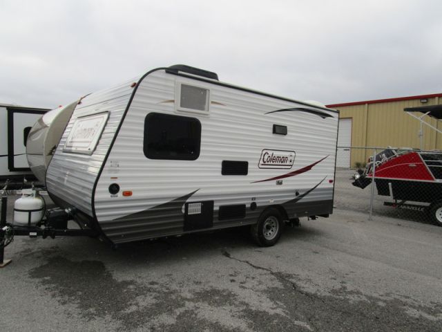

Here's a shot of the exterior and what really caught my attention.
Image.
Notice how flush the outside vent sits, the vent is above the window in this picture. The exterior vent lets the AC discharge all the heat its absorbing to the outside.
I found a similar vent online but I may try contacting the factory that builds Coleman RV's (Dutchmen) and see if its possible to buy the vent that they use.

I think that is a "thru-wall" unit rather than a window unit. Window units have an air intake on the side of the case and exhaust out the back. A thru wall unit has the intake and exhaust at the rear only. They are about 2-3 times the cost of a window unit but much less than a rooftop rv unit.
Instead of a vent, what about using a hatch door that you open when you get to the campsite? If I build a CT conversion, this is the route I would go.

aggie79 wrote:Instead of a vent, what about using a hatch door that you open when you get to the campsite? If I build a CT conversion, this is the route I would go.
I've thought of that as well, and it may be easier to find the right size "hatch" then a grille that I like.

That system you have a picture of is a window unit build into the cabinet with the exhaust out the back (trailer sidewall). You will notice the vent on the roof (basically a propane refrigerator roof vent).. that allows the unit to draw air in for the side intakes that also usually hang out the window. These systems work fine in smaller trailers and use much less power when on. Theses 5,500 BTU units can be run from a small Honda Generator. It is hard to find a roof unit less than 13,500 BTU roof mount.
