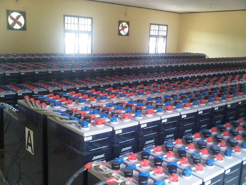

Here is a nice battery bank - I could use for my trailer :D :D
a Battery bank.JPG (142.38 KiB) Viewed 2797 times

I would not want to be in charge of keeping the electrolyte levels up. That is a lot of cells. :shock:

Postby OverTheTopCargoTrailer » Fri Sep 27, 2013 1:08 pm
Piece of cake, its only about 500 batteries & they all have clear casing to see the water level ,
maybe the guy who does that used to work at making big Mac's and applied the catsup & mustard...
they should collect the gas to be sold :lol: :lol:

Postby OverTheTopCargoTrailer » Fri Sep 27, 2013 2:24 pm
don't know, just saw the picture on the net & copied it...
did you notice the 2 center rows sit 6" higher so the water level can be viewed....
very nice & clean & professional set up however
