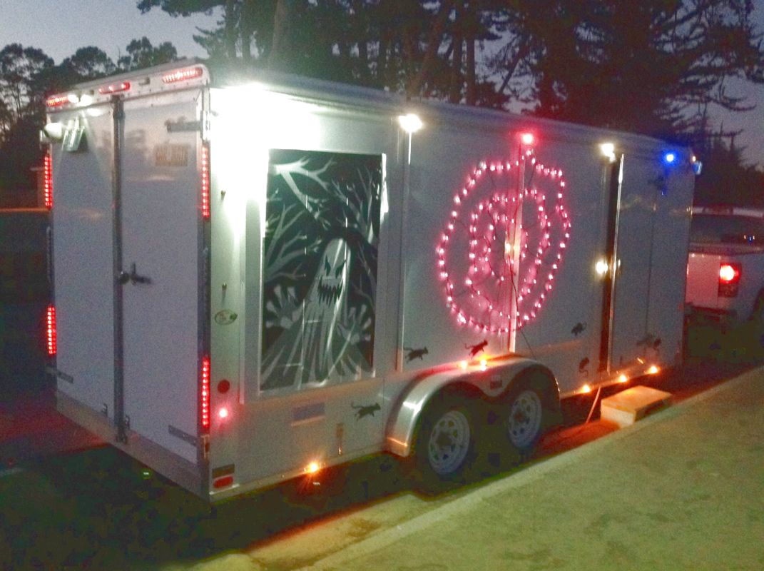

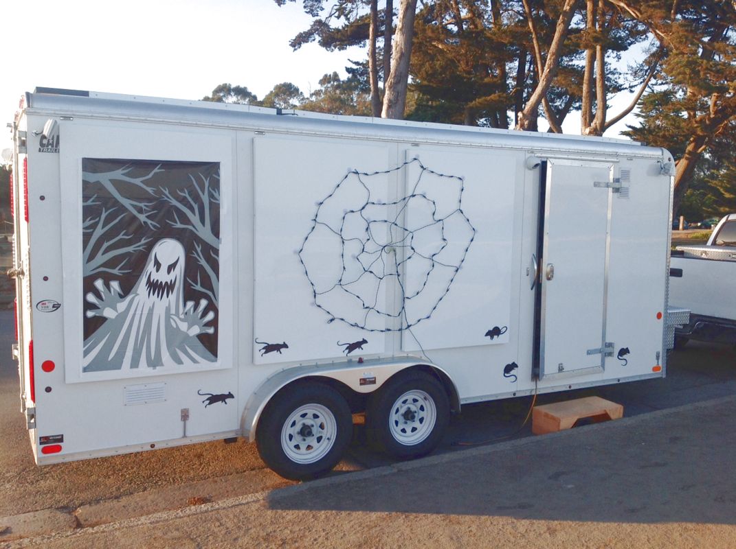

Next year I wanna see more Halloween decorated trailers here on the forum,
i'm gonna add more lights & a fog machine

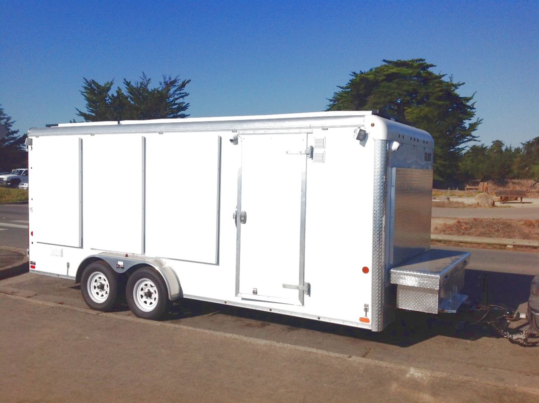

Nobody of the 100's of people who walked by were able to guess I had solar panels under cover :lol: :lol:
Now some were saying that the truck might hit the tool box while turning :thinking: :thinking: but I can tell you for a fact that I was able
to easily make 90 deg turns, even extra wide 180 deg U TURNS, turning my steering wheel up to 270 degrees and still had a few inches of clearance left over.
the tool box is full size truck tool box

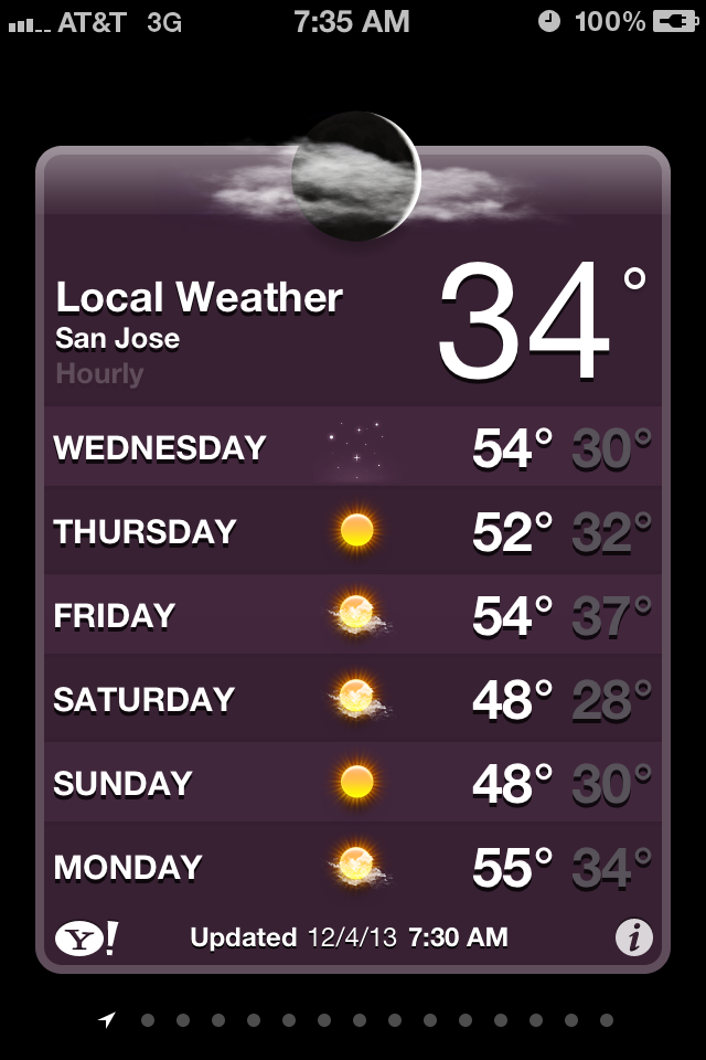

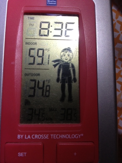

Its finally winter & freezing cold outside - but still 59 inside OTTCT with ZERO Heat
32" door still needs insulation
:goodmorning: :goodmorning: :goodmorning: :goodmorning: :goodmorning: :goodmorning: :goodmorning: :goodmorning:
the red clock is off by 1 hour , its really 7:35 am

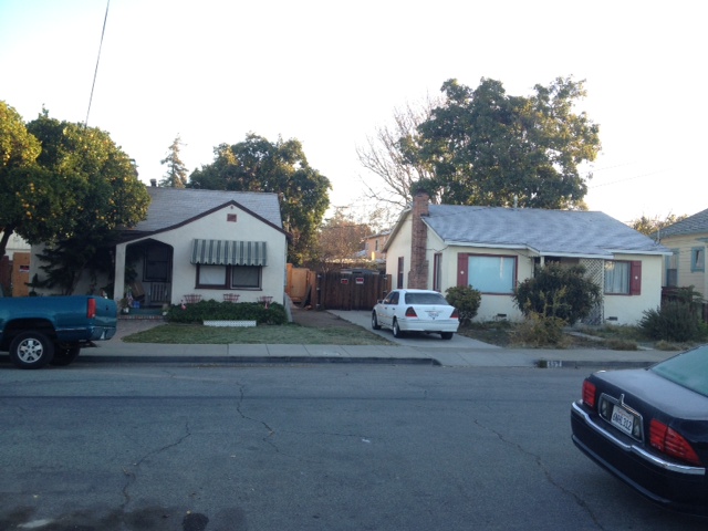

Can you see the frost on the crack house - ?
both have frost inside - no heat source

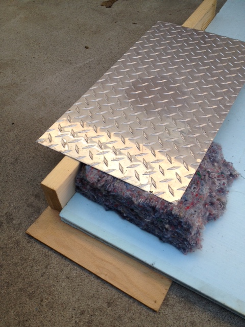

Ok here it is, for those of you who like to do winter camping & not have Niagara falls CONDENSATION drip on your head,
this method works as well as spray foam. It may also work in vans as walls are irregular
This set up works quite well with almost zero condensation.
the top diamond plate is of course the trailer roof.
the left side is a wood stud that runs under the metal stud "not shown"
I'm using R-19 Denim insulation - it really only expands to 3.5"
below i'm using 3/4" blue board mainly to compress the Denim - so there is no air space between metal roof.
the bottom layer is 1/4" paneling
Now most of you will LAUGH, because loosing even a single inch is blasphemy in your build
but since I have expensive solar and other electronic stuff on board...
one little drop is all it takes for a nice fire or a short.

Since I will most likely never camp in the western and southwester regions where the temperature can change so much between day and night, I will probably insulate to what ever the air spaces allowed in the sides and ceilings. I will spend the time and energy to learn more about the condensation issue so as not to allow mold or rot to exist in my CT. My camping when my wife is with me will probably be in the later spring to late summer in the East and South. The other times in cold weather will be me or a fellow fisherman or hunter during the colder weather. So for the cold weather insulation will be very much appreciated. But the maximum amount I "could" get if I accepted lesser interior dimensions is not that important to me. I am almost 70 now and still camp in makeshift camps like this picture shows:
