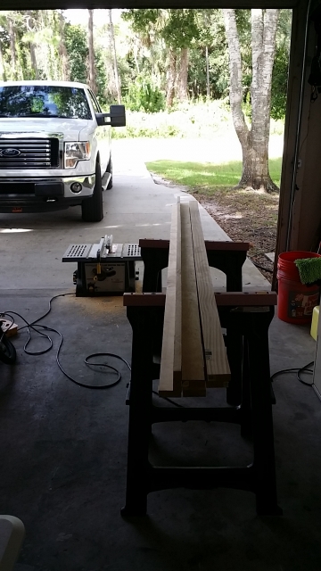

ripped 1*5's

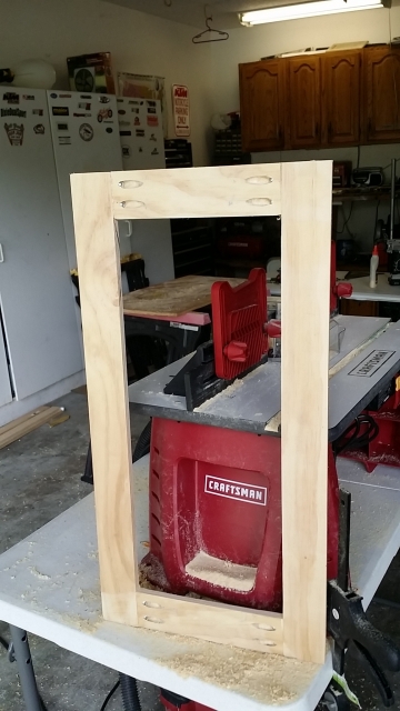

First pocket screws and glue

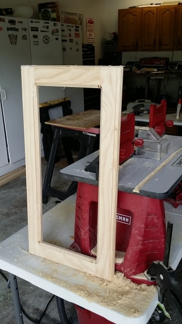

Very first ever. Has a 3/8 in. beading on outer and 45 deg chamfer on the inner. Did the outer on the table router and the inner with a handheld trim router. I don't know if there is an easier way.
Side by side. The second turned out better than the first... but both are good to me.

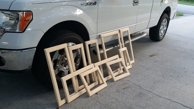

Thanks Martin. I got all the frames done except for the Electrical Cabinet. My plan is to paint them tomorrow and then install the panels and add hardware.
I need to start painting inside the trailer too so I can start mounting the cabinet doors. Should be ready by Monday afternoon to start that.
Got alot done today.

flboy, Howdy;
So, ... you're sayin' you assembled them first then did the routing?
Whichever way you did them they look great!
hank
hankaye
Posts: 2567
Location: S.W. New Mexico
Re: 7'*18' V-Nose Cargo Trailer Toy Hauler Conversion
Postby flboy » Sun Sep 18, 2016 2:16 pm
Hank, I did the outside before I cut the frames. Then I did the 45deg edge on the inside after I assembled them. I didn't see how else to do that.
