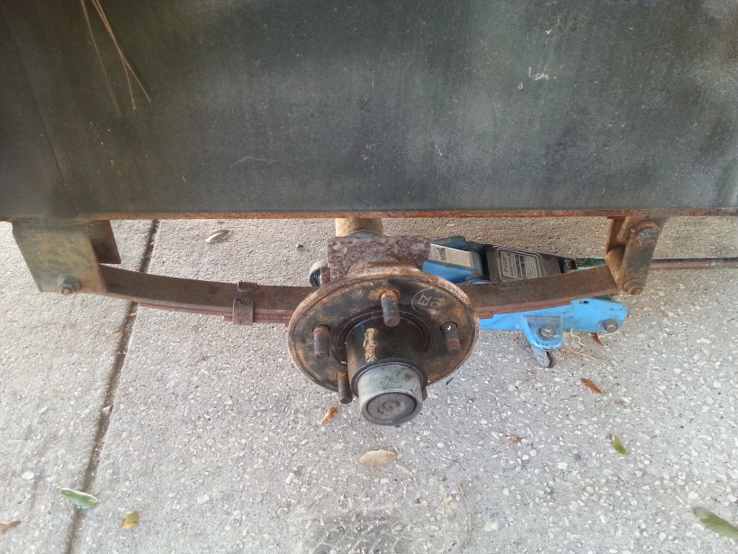

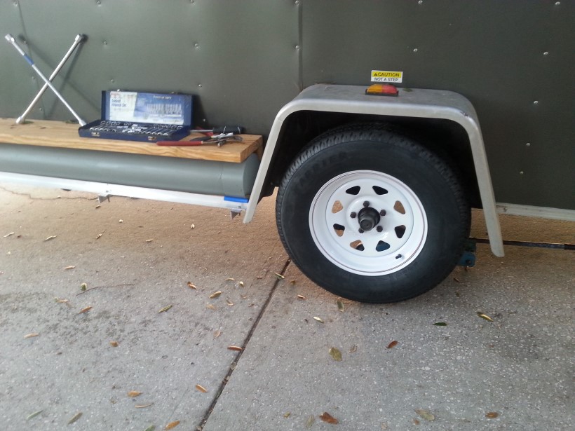

Postby Tommy B » Tue Oct 18, 2016 6:32 pm
Some last pictures. Take care of your bearings. Got one full turn at least on each side plus like what seemed like forever pumping on the grease gun till grease poured out. All very Good. I know bearings if nothing else. I got Lucky Break. One more trip with heavy load, scored axel, Guarantee it. Thank You Guardian Angel.

Postby McDave » Wed Oct 19, 2016 11:04 pm
So those bearings are the originals? That area looks a little rough, though I guess the salt air has quite an effect on any kind of exposed metal like springs and hubs. I see you don't have any chrome covers, I'm not sure how much the actually help but since they have the bearing buddys, I shoot some grease in almost every time I leave town. If you just keep pushing the dirt and water out they can last a long time, most of us won't put more than 7k-8k miles a year on a trailer.. I actually have the grease gun on board along with a simple tool kit. Air pressure gauge, screwdrivers ,wrenches, sockets, volt/ohm meter, 3 ton floor jack, misc. clamps and hardware and MULTIPLE flashlights and backup flashlights. And a fire extinguisher.

I don't know tires so much so I simply said to the clerk, " heavy load, lots of interstate travel, plus dirt gravel roads. I want the best you have "
Radial Tire came out first.
I got lazy on those bearings. They are the originals. 7-8 years old. I never so much as jacked it up and shook the tire. Never even greased them. If it aint broke don't mess wit it. Right? WRONG. The axle nut was not even hand tight and there was slop in both axles. That will not happen again. No Sir. They are now hand tight plus a quarter turn and greased. What grease in them was clean and free of metal specks or dirt. Oh thank you trailer god. So Lucky.
So now I must put new rear shocks on the truck prior to leaving. The trailer jack drags on the drive way now. It never did before. They are really bad I just cant put it off any more. And so it goes my friends.

Word of caution about the Bering Buddy system, ... Great if there are no breaks
on the axle. If there is a set of breaks then you are best served by doing it the
"old fashioned" way. Many folks have discovered that just pushing the old grease
out the back results in loading the brake shoes with the old grease and then having
to either replace the brakes or use a lot of brake cleaner to remove the grease.
About tires ... for single axle CTs you can pretty much use whatever you want. When
it gets into the dual axle trailers the tires tend to 'scrub' (slide sideways), when
making tight turns. Well, the compound is different in trailer tires so that they can
deal with the scrubbing. Also there are differences in the side wall construction, load
and speed ratings. Generally, trailer tires are more susceptible to ageing from exposure
to the Sun and that's why you see most RVers using those tire covers. They also have a
life of perhaps 3 - 5 years before the sun and ozone in the air weakens the rubber
compounds. (stuff learned from 9 years of RV livin' and hangin' out on a few RV forums).
