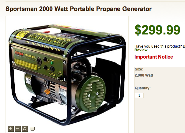

Postby OverTheTopCargoTrailer » Sat Jan 18, 2014 5:59 pm
Screen shot 2014-01-18 at 2.58.01 PM.png (246.94 KiB) Viewed 3715 times
http://www.basspro.com/Sportsman-2000-Watt-Portable-Propane-Generator/product/1302120536186/

Looks like a better deal then the Champion 1500 I bought this fall at $199 because it is 2000 W, propane and Wal-Mart has them for $249.
http://www.walmart.com/ip/15611929?wmls ... 10&veh=sem
But both this one and my Champion were too loud for me at 65db. Jerry, are you ok with the noise level?
Bob

12 hours at 50% load on a 20lb tank! You are gonna go broke running this thing! My EU2000 burns 5 quarts a day. I plug it into a 3 gallon boat tank then I can top the external tank off without shutting the generator off. Sometimes the only time I will shut down for an entire week is to do an oil change, and that takes less than ten minutes.

Guess I missed that point about the 1/2 tank consumption and I was only pointing out a lower price for that particular unit. I think there is merit in propane if the cost is justified. It means one less fuel to carry with you.
I used the Champion 1200 unit at a hunt camp last fall and while I did not keep records, my recollection says I got about 6-8 hours out of a 1.2 gal tank. At $3.25/gal (East Coast cost) we used about $3.90 worth of regular gas. For 12 hours (to compare it with the Bass Pro unit) the estimated gas cost can be extrapolated to about $5.85. For the propane at 12 hours for 1/2 20 gal tank which cost about $20 here in the east to refill, the cost premium for fuel is therefore about $10.00
That means for me the propane unit would be a little less then twice the cost to run over my Champion. But I for one am not going to keep it. The EU2000i or larger is on my buy wish list. And they do make propane converter kits for the Honda, but they run about $300 (from my quick search today).
And one cannot forget the cost of the generator itself. If one only used it irregularly, did not care about the loudness, the $250 for a unit which uses about $5 minimum more on each fill up might make sense. They can burn $750 more in propane for many years before the payback makes sense.
Now to compare the Honda to the Champion, that is another story.
Bob

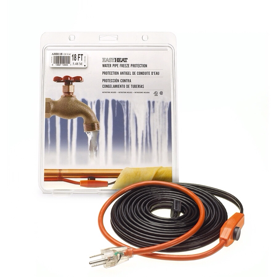

OverTheTopCargoTrailer wrote:Heated RV water hose
good to -42 degrees F
http://www.campingworld.com/shopping/item/12-ft-pirit-heated-hose/74842
Here is another option. Lots cheaper but it will require you attaching it to the hose. Says its good down to -40.
http://www.lowes.com/pd_23997-72436-AHB ... facetInfo=
Earnest

I'll only keep my observations to what my experiences have been with both methods of keeping the water hose from freezing.
I live in an RV and have survived several winters in Central Utah where the temps. do drop to -40*F and stick in the single
digits for prolonged periods of time.
Pirit (pronounced Pirate arrrggggg), Worked fine till the temp came back up to above 50*F then separated at the ends. As
the wiring is integeral there is NO splicing or repairs that can be done with them. :thumbdown: , :thumbdown:
I have been using one (1), EasyHeat heat tape for the past 4 years. snug it into some of the pre-made neoprene hose insulation
that looks like pool noodles, tape the sections together, plug it in ... done. Unplug when not needed ... :thumbsup: , :thumbsup: , :beer:
I tend to get the neoprene insulation that fits loose so it doesn't cook the hose, but a regular RV water hose CAN be repaired (extra +++'s).
hank
