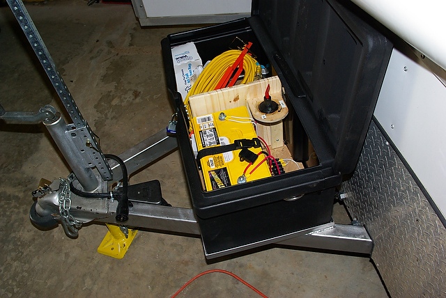

Finally decided on what to do with the battery and what box to use. I ended up with a 32" toolbox (on sale for $59 at Tractor Supply). I had to watch the height so I can clear the nose cone and I did not want a lot of storage room or I would fill it up.
The disconnect is between the battery and the WFCO converter. I can unplug the new 7 pin plug to isolate the tow vehicles battery. The board in the middle is mounted on a hinge so it folds away from the battery to ease getting the battery in/out.
It's a bit hard to see but I installed two vents into the sides of the box. I also have a trolling motor receptacle mounted in the driver's side just under the toolbox handle.
I added the slotted tubing to the back of the tongue jack for a solid mounting for stuff (perhaps solar in the future).

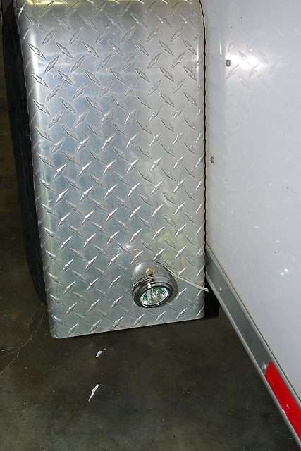

Ran my brake wires and backup lighting was installed at same time.

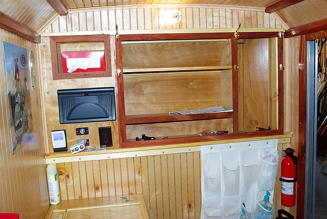

Figured out where I wanted a light in the front of the trailer - top dead center. So I pulled the front shelves out and installed it. I also added one shelf to the unit as well as a number of hooks to hang clothes on at night. A fire extinguisher and a shoe holder were added earlier.

Looks great Nathan that back up light is a cool idea I'll have to put one on the new one too.

Thanks Gary, but I will have to pass the inspiration to Mark and Em when they showed up after dark at Pershing. :)

Looking good Nathan. You have made some nice improvements since I saw it at Pershing. I like your backup lights, think I will put them on #2.

Thanks Jim. I haven't had to use them yet, but I did check them out and I think they will help if I have to back in after dark.

Was this section of wall open as shown, or did you cut it out?
Your use of the space behind the nose was great!

The top of the front wall behind the nose cone was already cut out when I purchased the trailer. I just tried to come up with a way to utilize that space.
