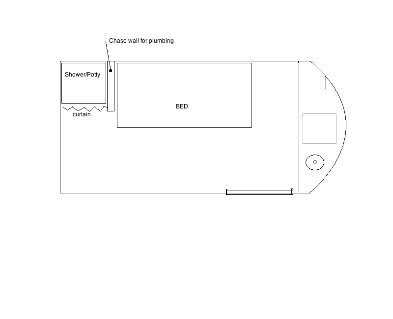

Postby GPW » Fri Aug 06, 2010 6:49 am
Quote: "won't be able to get in via the side door without walking on the bed.
Hmmm?... I see where that could be a problem :o
Here's a drawing I still consider workable in a CT ... Just more ideas to toss around.. :roll: Image
Postby d30gaijin » Fri Aug 06, 2010 10:11 pm
GPW wrote:Quote: "won't be able to get in via the side door without walking on the bed.
GPW,
That's a nice design and feasible, but not at this point in my build. My build is a little bit close to your sketch except the shower will not be so large. My galley shelf will extend behind the forward wall/bulkhead of the shower allowing me to make a cabinet just behind the shower forward wall/bulkhead and the absolute front wall of the CT. That cabinet will house the shower plumbing and provide some limited storage space. I could better explain it if I could make nice sketches like you provided... alas I can't so we'll just have to wait for pics as it progresses. :snappy:
We're off to the mountains for the next five days but should have WiFi when we get there... no guarantees but hopes.
Please keep the thoughts and ideas coming. I can make some changes but the overall layout is somewhat cast in stone at this point.

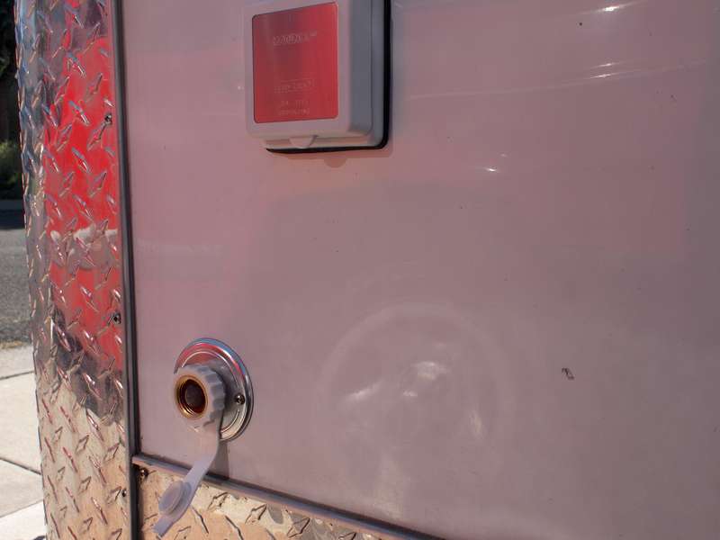

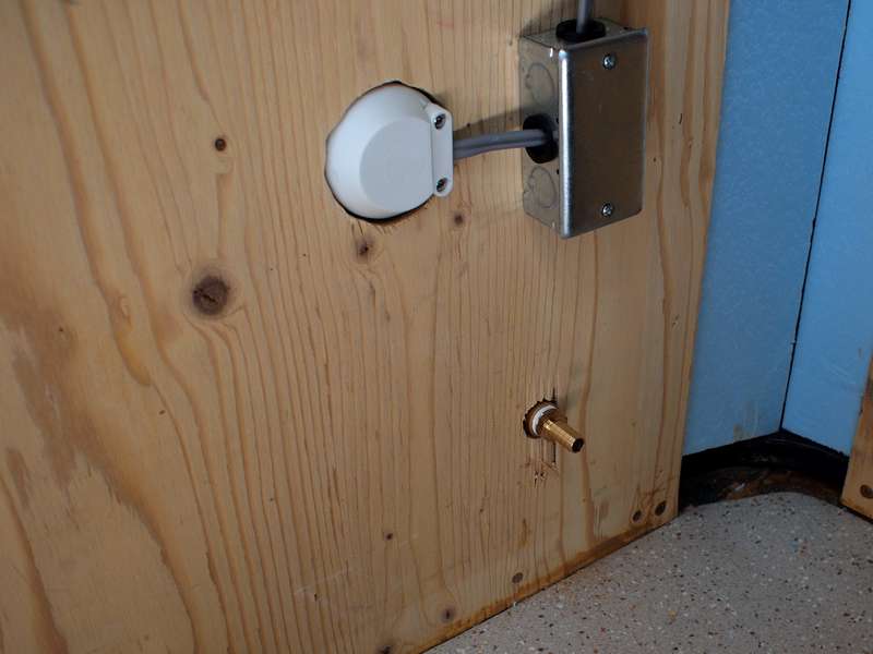

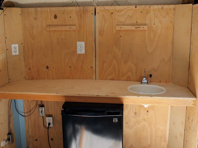

Today I was determined to get the 110v AC electrical done, something I have been dreading because the outdoor 12 gauge wire I have been using is such a PITA to work with in confined spaces/sharp turns but I got-r-done. What got done was the upper left CGFI outlet and the upper center outlet, which is tied into the upper left CGFI outlet for GFI protection. I Also cut some Luan for the forward corners. On the left I tried screwing it to the existing CT interior plywood but was not happy with the results so will use my air stapler instead and then remove the screws I put in (screws only on the left side upper corner). That completes the 110v AC electrical, with the exception of getting some Adel Clamps (rubber insulated clamps) to secure the 110v wire to the wood bulkheads per Engineer Guy's excellent recommendation to reduce the chance of 12 gauge solid wire breakage due to vibration.
I also installed the city water inlet/penetration.
Next on the list of things to get done will be rough plumbing, shower pan installation, and Formica for the galley counter top.
I will build a splash guard just above the interior city water penetration to isolate the plumbing connection from the electrical inlet/wiring/junction box i.e., should the plumbing connection fail all water spray will be directed down and away from any electrical connection.

Postby GPW » Mon Aug 16, 2010 7:01 am
Don, sealing the wood around that inlet wouldn't be a bad idea ... you can already see the water sucking up into the ply at the bottom (pic) :o
Postby d30gaijin » Mon Aug 16, 2010 8:45 pm
GPW wrote:Don, sealing the wood around that inlet wouldn't be a bad idea ... you can already see the water sucking up into the ply at the bottom (pic) :o
GPW,
I will make an internal seal. Externally the inlet flange was shot full of exterior waterproof silicon seal then screwed in place. No water will penetrate through that. Internally that isn't water being sucked up as there has been no water internal yet. What you see is glue remnants from the original side paneling to floor joint wherein the manufacturer gobbed a boatload of glue/sealant to seal the two joint surfaces (I spent hours scraping that stuff off/out).
By the way, all the inside wall and roof surfaces will be overlaid with thin wall paneling to finish off the inside in a decorative manner. The plywood siding is just there because it came original in the CT and holds the insulation in place i.e., I put back what was already there.
