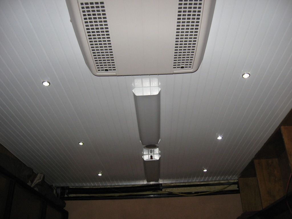

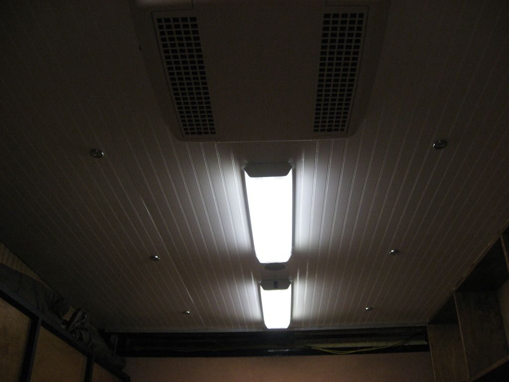

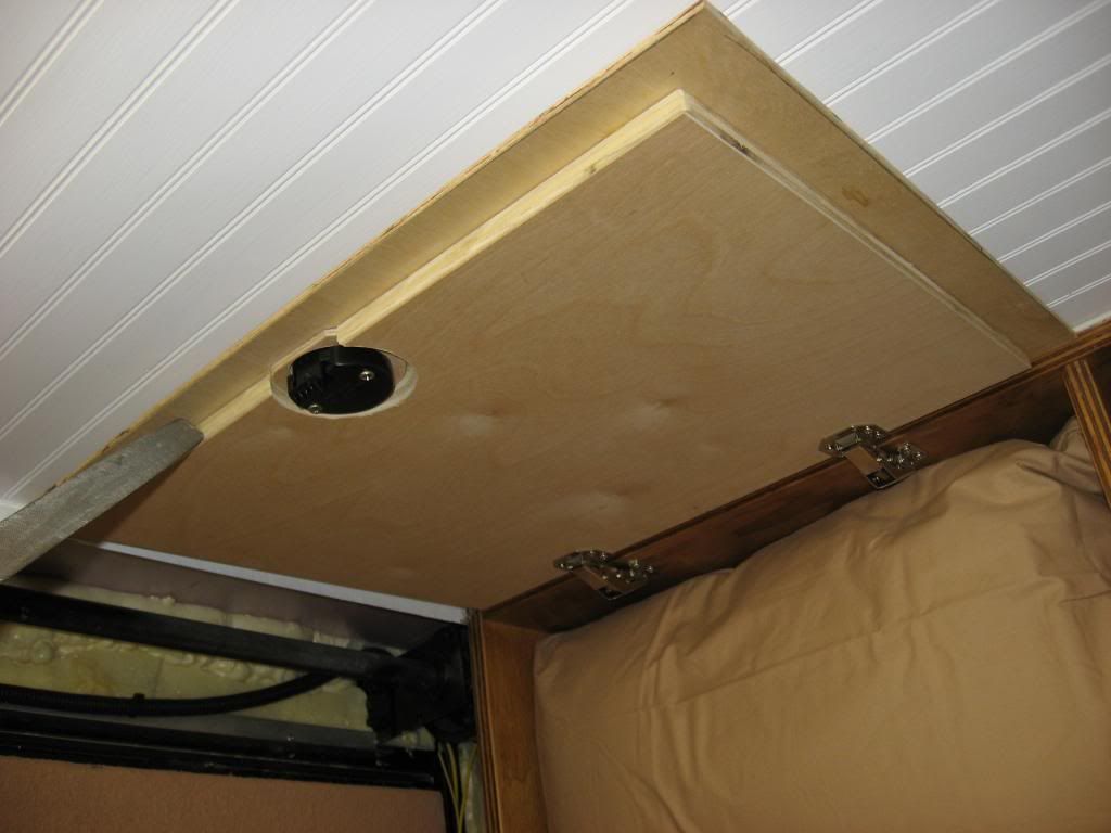

Main lights are DC fluorescent and draw about 9 amps but really light it up well
Low lights are LED and draw about 1 amp.

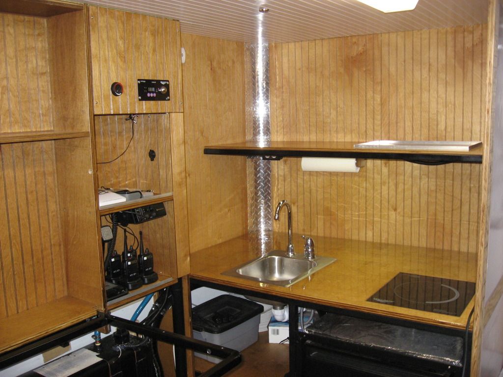

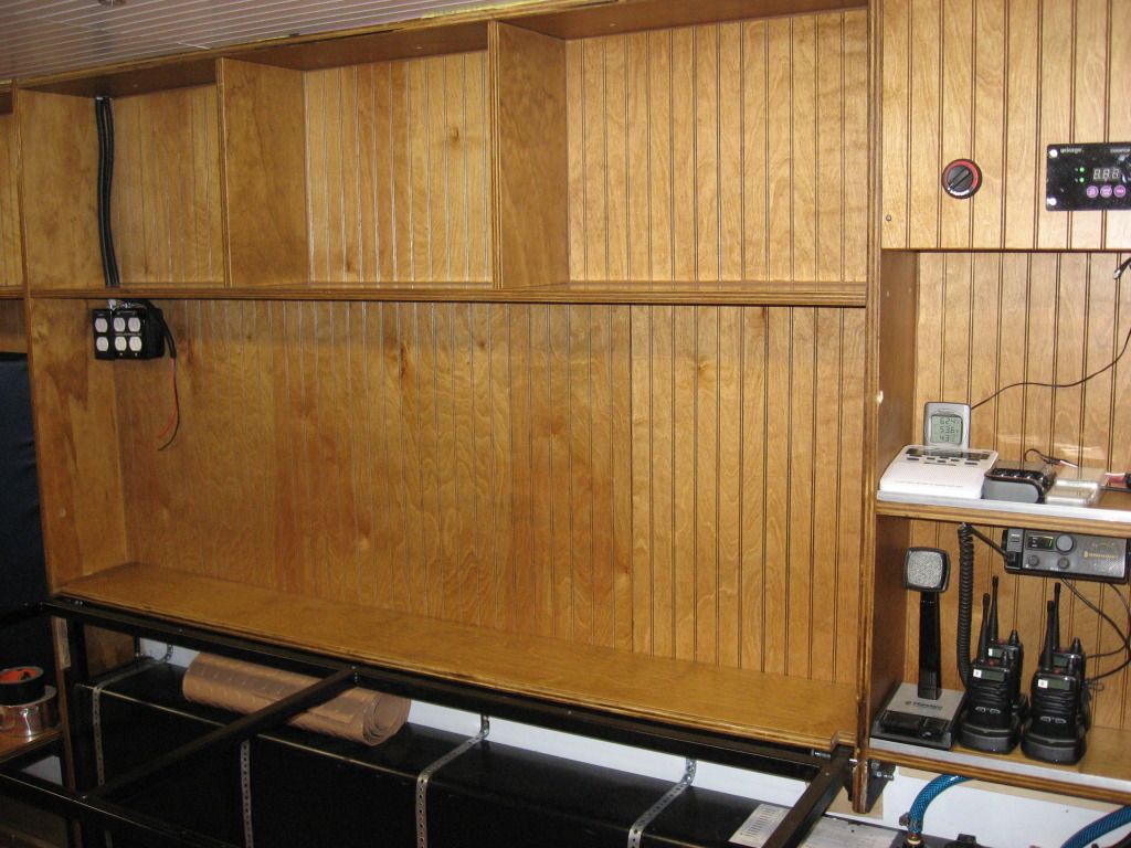

Accessory station for radios, chargers, etc

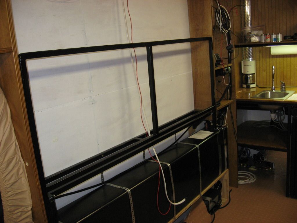

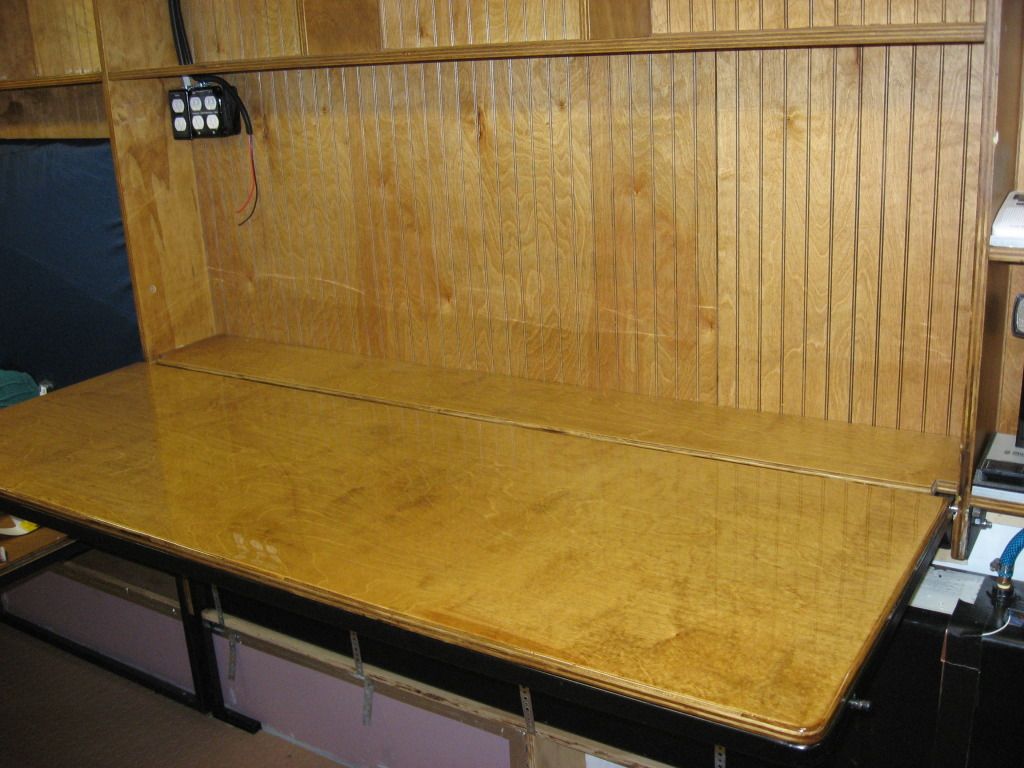

Fold down table. There will be compartments for storage.

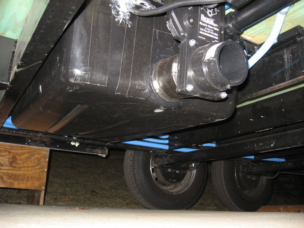

Gray water tank is ABS from IconDirect in Canada. It holds 17 gallons and I installed an electric dump valve. Not shown on the picture: I put in a 1.5" vent tube but it wasn't quite high enough. So I plumbed a 3/8" fitting higher on the tank and ran it into the vent tube. This allow it to fill up fully and vent properly although it is a little strange.

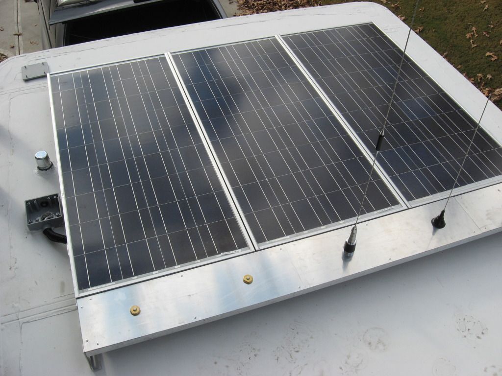

Antenna rack for weather radio, GMRS, Cell at rear of solar panel. Also see the small round silver vent for gray water. It is smaller than the hat style vent cover.

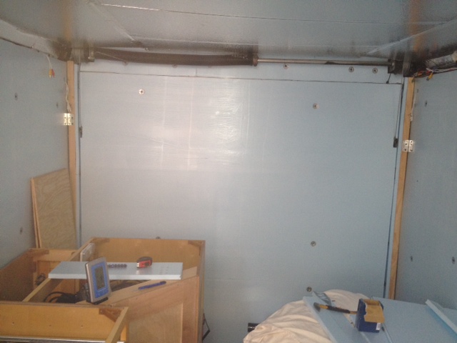

I'm getting ready for -40 and +120 deg, I'm hoping for heating with a match & cooling with a ice cube
almost done, still have a few nips & tucks to go , on the 2nd layer inside the first layer

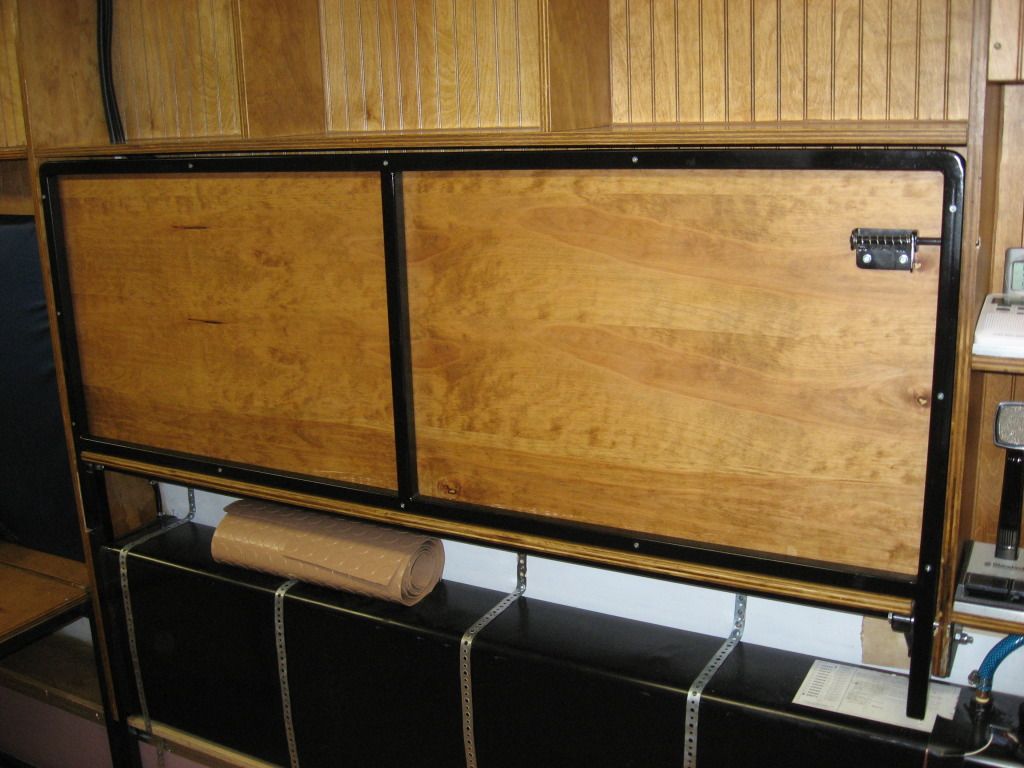

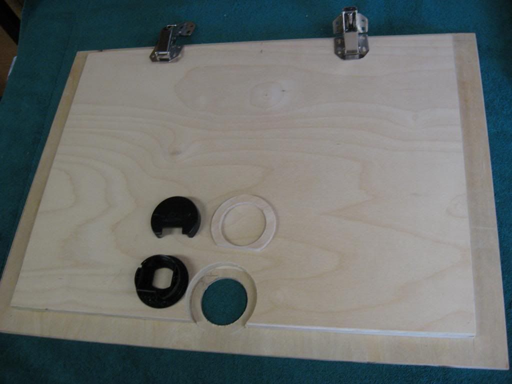

CABINET DOORS
I don't have cabinet making skills and I wanted flush cabinet doors. My solution is to glue 1/2" birch plywood to the back of paneling and mount it with hidden hinges from Home Depot and SouthCo finger latches. The weight of the door is too much for the hinges to hold open in the over head position but that really isn't a problem. I had to make a spacer for the finger latch but I think they are available for thinner panels. I got a good deal on a bunch of them from a surplus company so I took it. There are many different latch styles available but some are expensive and some have to be ordered in large quantities (aerospace).

I'm curious what the drop is on your blackwater tank? How far below the frame rail does it sit, at its lowest point?
Mine hangs about 3" below the frame rail. I don't think I have much reason to be concerned (especially since I'm on Spring Axles).. Just wondering !

Daniel, the tank is all the way up against the floor decking and hangs down below the frame 3.5". The electric dump valve adds another 1/2". It is right in front of the axle tube which is also below the frame about 4" and the front and rear jacks are about 5" below the frame. So I don't think it is at risk under reasonable circumstances.
