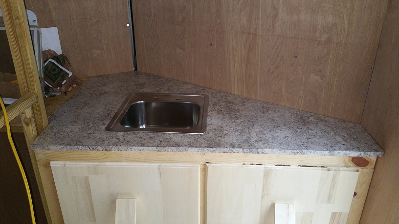

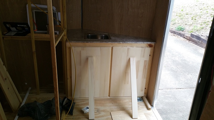

Here is what I got done yesterday Now I am ready to laminate the counter top. Picking up the laminate today also we are putting in the roof top AC more pics to follow.

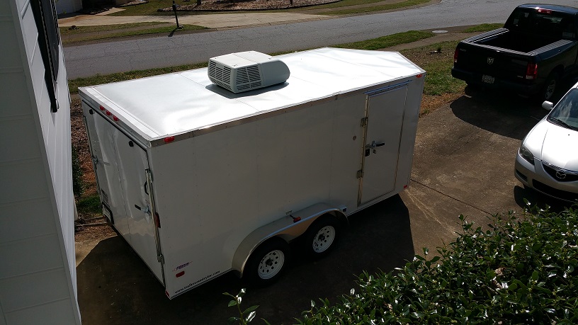

It was the easiest design I could think of I am making the doors now .. In other news Air conditioner..Installed :applause:

Tongue weight should total approx. 15% of trailer net ( loaded) wt. In my case net 2990, tongue wt. =448lbs.
Good info to have when planning for location of things like generators, batteries, propane and water tanks.
I am trying to keep the Harley basically centered over the axle (single axle, single bike) and use the other heavy items to achieve the proper balance/ tongue wt. You will notice how your A/C is cleverly located directly above the axels... :thumbsup: just sayin'...
