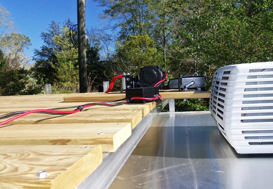

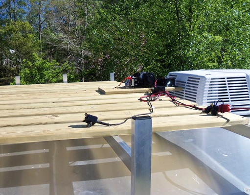

Postby Wolfscout » Tue Apr 05, 2016 7:30 am
couple images from the weekend working on the upper deck.
rear view (not shown a roller for the cable I added.)
side view

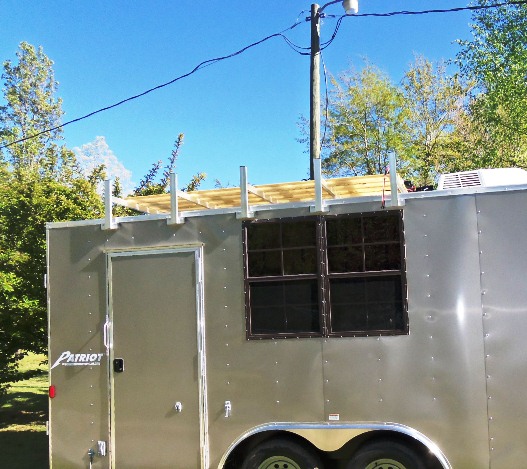

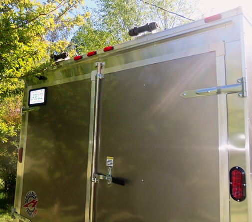

Postby Wolfscout » Tue Apr 05, 2016 7:33 am
two more images of the winch set up for my boat loader.
closer shot.

Yep that upper deck is extra stable. I think it'll work for holding out small boat and some gear.
Occassionally, we may want to take a stool or two up and sit and enjoy the sites. especially at the beach without ever getting in the sand. :lol:
