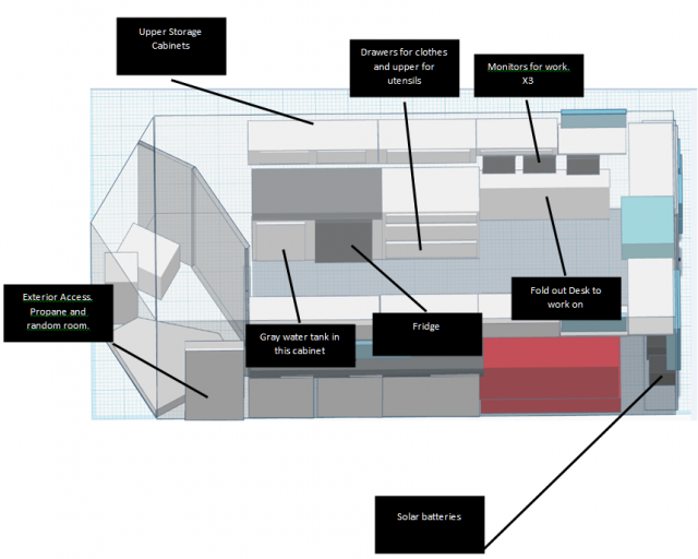

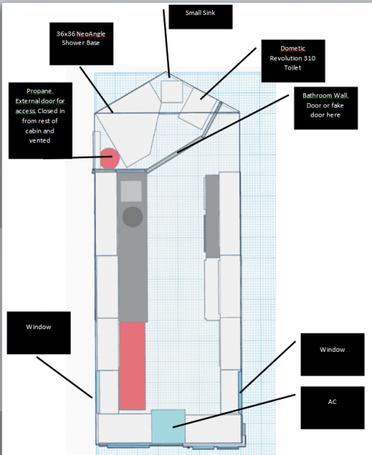

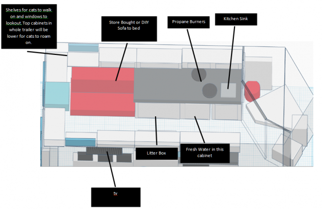

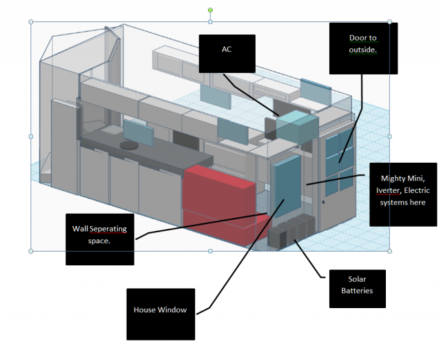

Since I'll be picking up my trailer in the next few days, I've been really researching about design and how I use my space. After seeing many layouts on this forum and around the web, I've decided to change my layout to make better use of my space.
Here is my modified layout: (Note, I decided to build my cabinets and drawers to maximize space and make my layout work for exactly what I need/want in the trailer)
Top View
Left Side
Right Side
Back

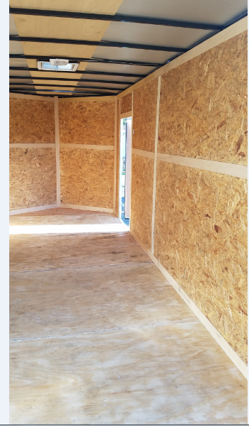

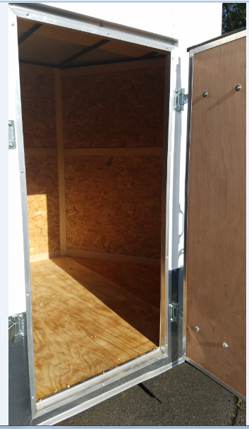

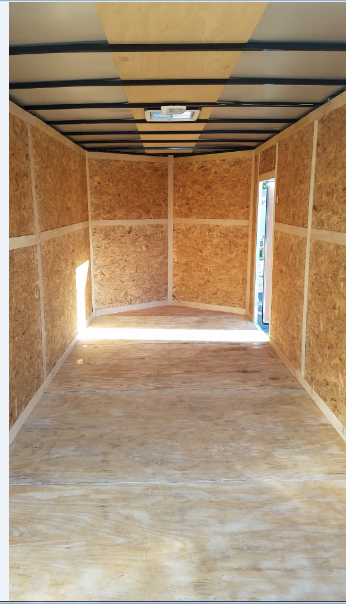

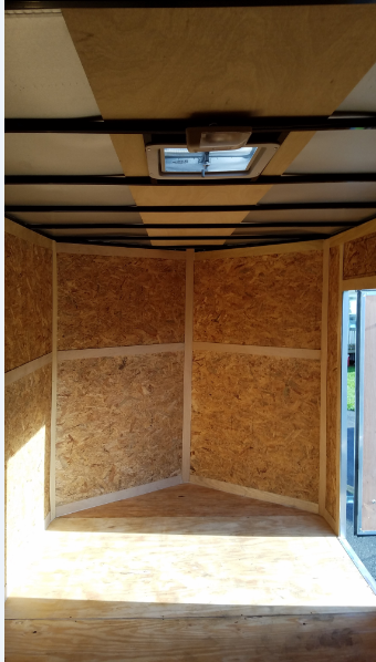

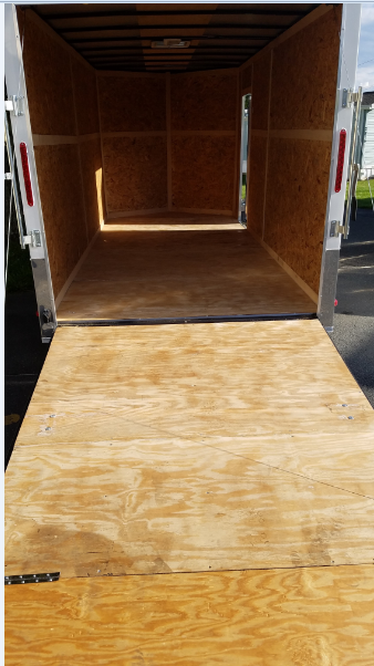

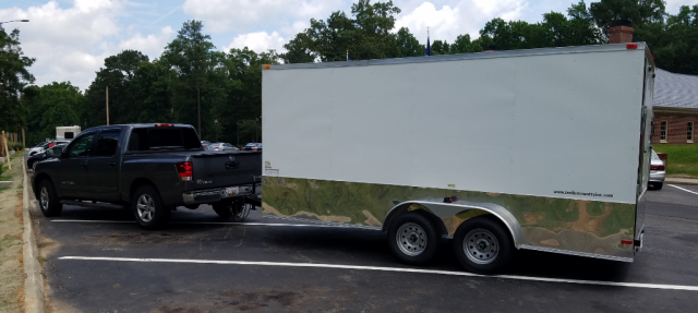

Well, took the trip to Georgia and picked up my new trailer!!
Some things I learned:
- Jack Knifing is real. I put a very small dent in the front of my trailer while trying to back it up
- 7 x 16 really isn't as big as you think.
- Go with a quality trailer. I skimped here and regret it a tad. But gonna make the best out of what I have
- Towing is scary if you've never done it. I went from Georgia back to Maryland and learn so much about towing and my truck. Good experience.
- Your tow vehicle matters! While my truck handle the empty trailer with no problem, it averaged 10 gallons per mile. So yeah, I love my truck, but my next truck will be better on fuel.
- Cars will and trucks will pretty much stay away from you when you first learn to tow. All the cars on the highway gave me super space and moved out of my way. I was having a hard time keeping that trailer between the lines. I got better during the end of the trip.
Without further ado, here is my baby:
Side view with Truck:
Side with Door:
Side Door open:
Ramp from the inside:
Inside pic from Rear:
Inside:
Ramp:
Roof Vent:

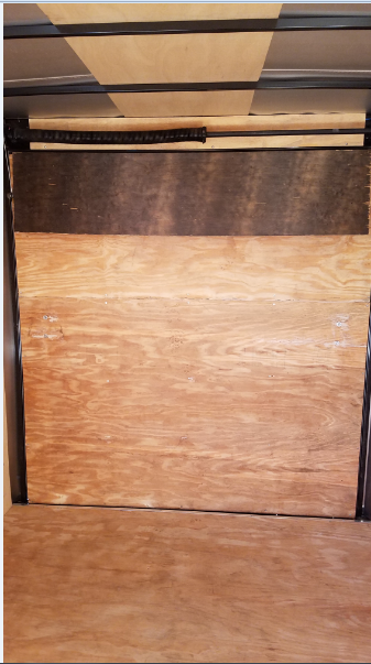

Now the fun begins. First step is taking off those panels and seeing what is underneath there.

Re: 7x7x16 V Nose Cargo Trailer Conversion, First Build
Postby flboy » Tue Jun 06, 2017 7:36 pm
Congratulations on a very nice looking trailer. :thumbsup: :thumbsup:
I wouldn't expect much better gas mileage unless you get a Diesel. My guess is you will get about the same MPG fully loaded (unless in the hills) . Most of the energy is spent pulling that mass through the air which does not change when loaded and these newer trucks are optimized for gas mileage when empty and stock. I'll get anywhere between 18-21 MPG with my F150 4WD (302V8) depending on my speed and winds, but when you drop the trailer on... mileage goes down 40 to 50%. Loaded or not seems to make little difference (it is flat here). That is normal from what I understand.
You can improve the handling behind the truck with a sway bar and load balancing hitch (will make it easier for you), but how you balance the build/load will make the biggest difference.I wouldn't be too concerned yet. The empty trailer seemed to pull worse for me . They are relatively light when loaded and the wind and passing trucks seem to push them around a lot more. You will get use to it quick and it will be easier to keep it all in one lane.
It is kinda late for you now, but I had an extended tongue put on my trailer to make the backing up easier and it also prevents denting up the front with the bumper if you back up too sharp. I learned that from my first build. You will remember that if you ever do this again.
I look forward to your build! :thumbsup: :thumbsup:

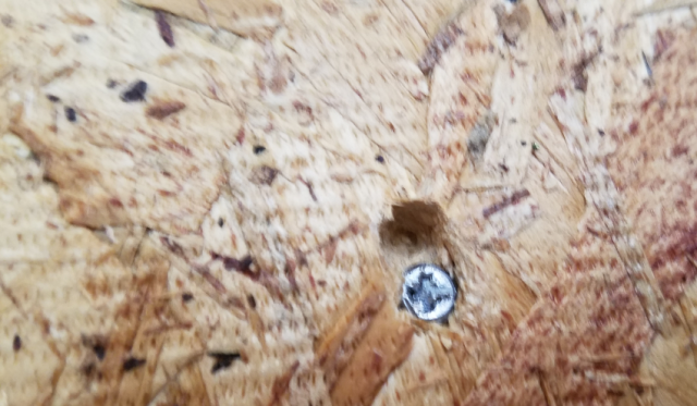

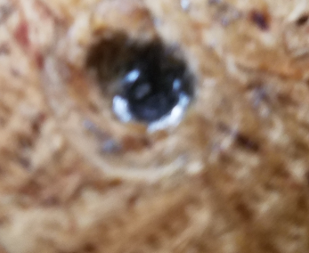

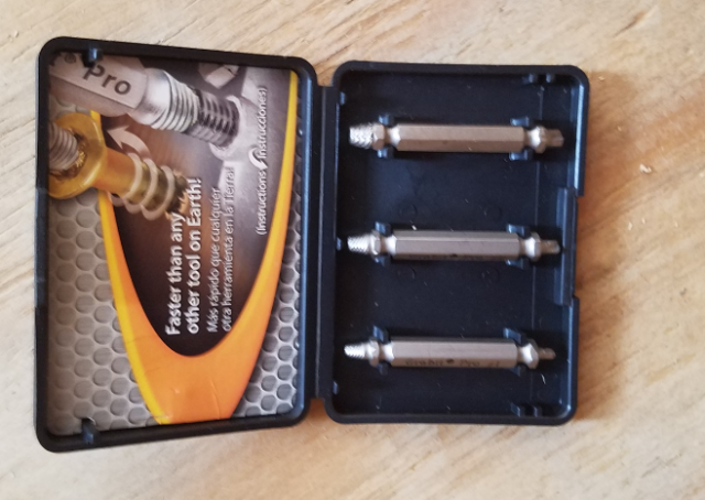

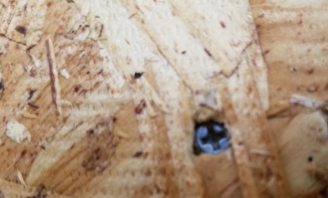

So here is my first challenge, I can't get the screws out of the plywood. The trim came off easily. For the screws, everything I use strips them. They seem to be really cheap screws. Anyone have ideas on how to get these out? I have a regular drill, a driver drill, drill bits, and that special tool to get out stripped screws. Nothing really worked. I also tried with a black drill bit to drill it out, and it just broke this in half. I did not think my first issue would be taking out screws....sheesh
Screw stripped with regular drill:
A good screw before I chopped it up:
stripper tool
Tried with special drill bits to remove bad screws:
