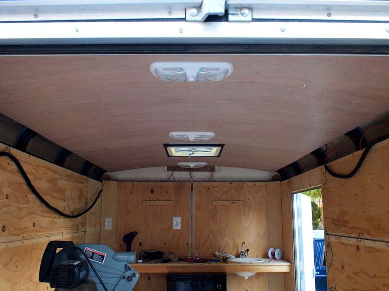

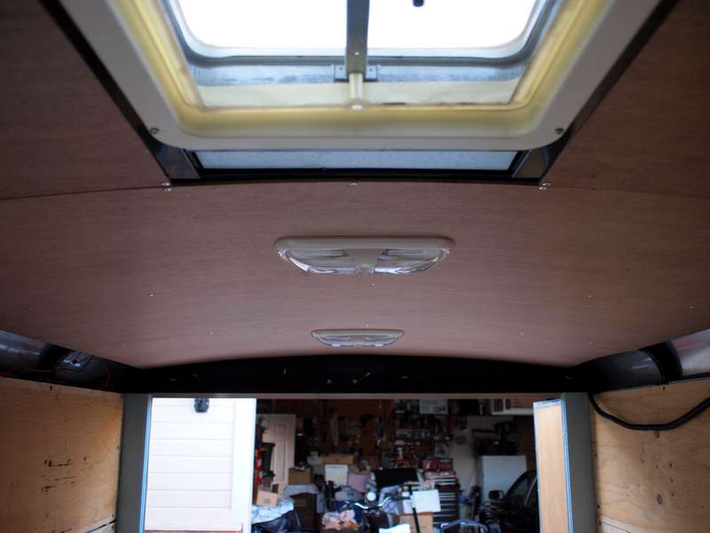

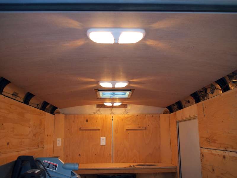

Installed Luan paneling overhead along with three 12v DC light fixtures. If it appears the lights are off center in the ceiling they are not. The manufacturer installed roof vent is off center.
"Let there be light, and there was light."

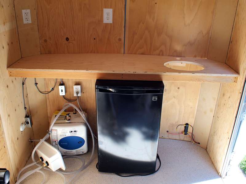

Installed the Ariston 110v AC water heater and plumbed it to the Thetford RV/Marine shower box, a shower box one normally sees on the outside of an RV but it will work just fine for our interior shower use (the same shower box 8ball_99 used in his CT conversion shower, see here about 2/3rds of the way down the first page of his conversion http://www.tnttt.com/viewtopic.php?t=36422). Interestingly when I did a full pressure hydro test from house water i.e., approximately 60 psi (no typical RV pressure reducer installed in-line at the CT's city water inlet) there were absolutely no leaks in my plumbing but the Thetford shower box leaked where the factory installed flexible outlet line attaches to the shower box. I had to disassemble it to tighten the connection to stop the leak. In the pic below you can see my concern with making splash guards because the water plumbing is right next to the 110v AC electrical. If you're wondering why I didn't install the water heater on the other side of the reefer (where the 12v DC is) it is because I need that space for fresh and gray water tanks that will be plumbed to the sink, and the sink is a hand pump type so I wanted to keep the line run to the tank as short as possible.

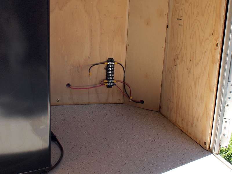

This is a pic of the 12v DC side wiring. It's rather simple in that it will be, at this time, used only for the 12v DC ceiling lights and side door porch light. The positive and negative wires not connected to anything will be the attachment points for a "Battery Tender."

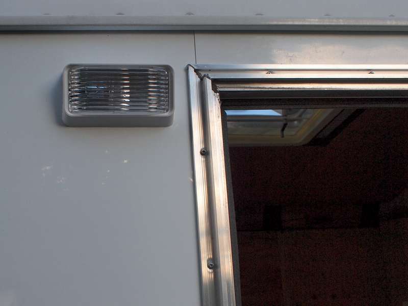

Here's a pic of the porch light, and no it is not installed crooked, it just appears so because of the angle the pic was taken at.

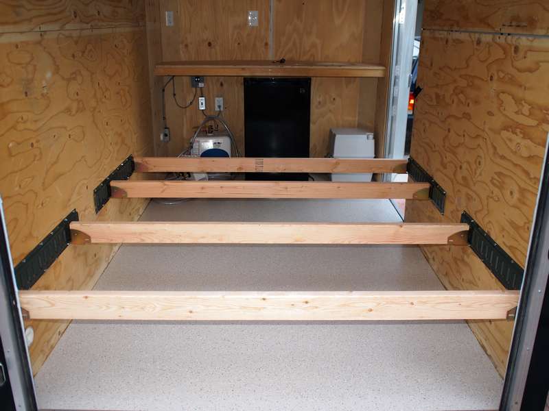

The E-Track hardware came in today and I mounted it, cut the 2x4's for the bed frame and am now ready to buy and cut plywood to finish off the bed frame... tomorrow will see the plywood bought, cut, installed, and Formica counter top installation (taking a day off work to get things done to meet our camping schedule). The entire bed frame is removable/stowable thanks to the E-Track system so as to get the Harley in there when we want to take it along.
