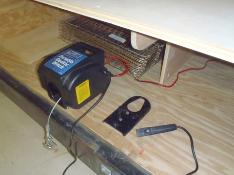

Time for Plan-B. Winch it in. I got the winch at WalMart for about 70-bucks. It has a removable bracket that can be hooked over a hitch ball. The bracket is also predrilled for mounting on a solid surface.
I installed the mounting plate to the floor of the TT. I don't carry the winch with me. It stays in the garage and gets hooked on the the trailer when I want to move the TT inside. I power the winch from the 12-volt batteries on the TT.

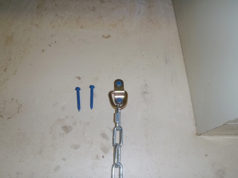

The winch comes with 29-feet of cable which is not enough to get all the way into the garage. I added 10 feet of light chain, attached to a simple loop anchor plate that is Tap-Conned to the floor.

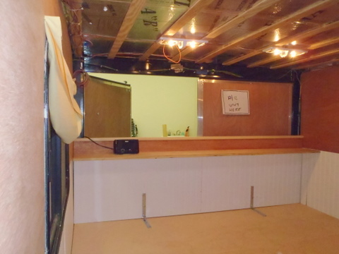

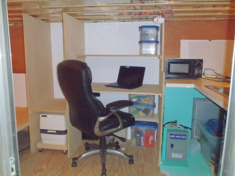

All of the "rough carpentry" is done. Finally. Next step is adding the face-frame cabinetry, drawers in the kitchen and cabinet doors.

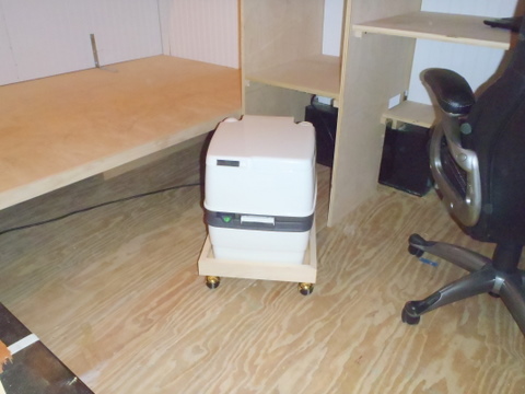

Under the desk I added a shelf and it will have doors on it. I widened the toilet compartment a bit and made a rolling base for the Porta-Potti.

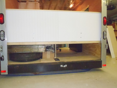

I build a half-wall across the back doors with a shelf along the back for an alarm clock, a place to park my eye glasses at night and somewhere to put that bottle of Rolaids.
I reconfigured the storage area under the bed. Making a walled off space for the spare tire, jack and blocks, and the two doggie fences. The rest of the under bed storage area is accessible from both the interior and the back doors.
