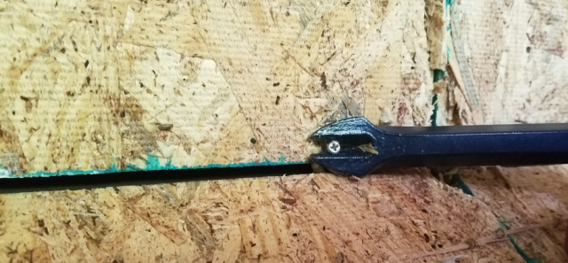

Postby jr9744 » Wed Jun 07, 2017 4:38 pm
Padilen wrote:Do you have the dreaded, screw head nails?!. If that's what they are I'd probably drill head off and pry boards off the remove the nail.
How would I know that? I put one pic of the screw in good shape, do you think is the screw you mention?

jr9744, Howdy;
I've had luck by dipping a damp screwdriver tip in some Comet or Ajax. It improves the 'bite' in the screw head. Also,
are you using a Prince & Reed or Phillips of the proper size? If you still fail to extract any of the screws then I'd think
that they most likely are the screw-headed nails and I'd just drill off the heads and pry the wall panels off.

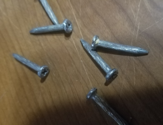

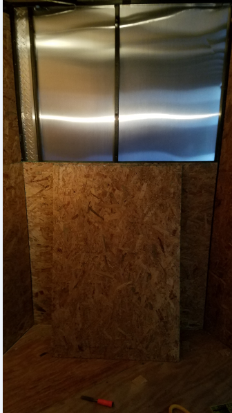

Re: 7x7x16 V Nose Cargo Trailer Conversion, First Build
Postby jr9744 » Wed Jun 07, 2017 7:45 pm

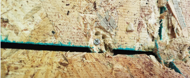

Holy Cow!! Those were nails that look like screws!!! I ended up using a chisel to kind of get to the head of the screw/nail, then I just moved it around and popped it out. Sometimes I could get the hammer in there and just pop it off with that. Other times I just hit it a bunch with the chisel until it came.
But, there has got to be an easier way. I did try drilling the heads off to no avail. Vets, any advice on taking these off quickly? If I have to chisel every screws, this will take me all year.

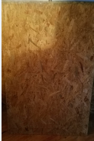

First Panel off. I tried my best to keep the plywood in good shape so I could reuse it.
First Panel. I do believe I can reuse this one.

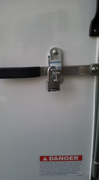

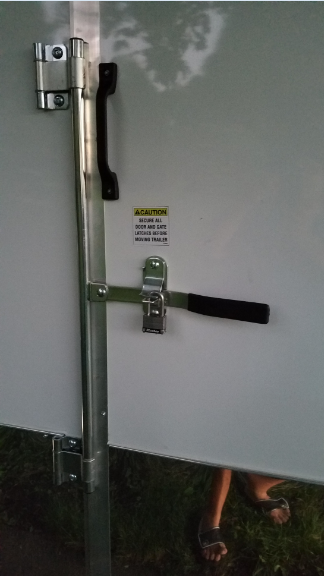

For some added security, I added master locks to the back and side doors.

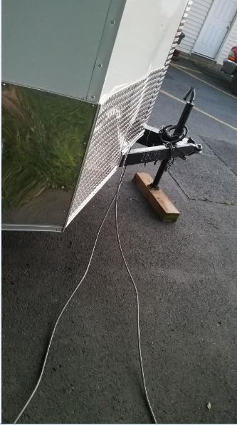

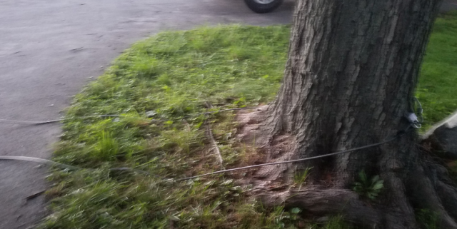

I then wrapped a wrope around the front of the trailer and then to a tree. May not do nothing, but I figured it is a little deterrent.
Postby jr9744 » Wed Jun 07, 2017 7:48 pm
hankaye wrote:jr9744, Howdy;
hank
They are the dreaded screw-headed nails. I tried drilling off the heads with a drill bit, but had no luck. Is there a special drill bit or tool you use for this?
Postby hankaye » Wed Jun 07, 2017 8:02 pm
jr9744, Howdy;
Forget the frustration of trying to drill, go get a good nail puller aka cat's paw.
https://en.wikipedia.org/wiki/Cat%27s_paw_(nail_puller)

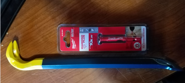

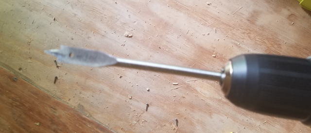

Postby jr9744 » Thu Jun 08, 2017 7:51 am
I went to HD and bought a cat claw and a very small circular drill saw thing.
These are the pain in the ass screw/nails in question
The small red drill did not work. I used a small 1/2 inch winged drill thing to cut wholes around the screws.
Once I could get the cat claw in, pulling these out was no issue.
