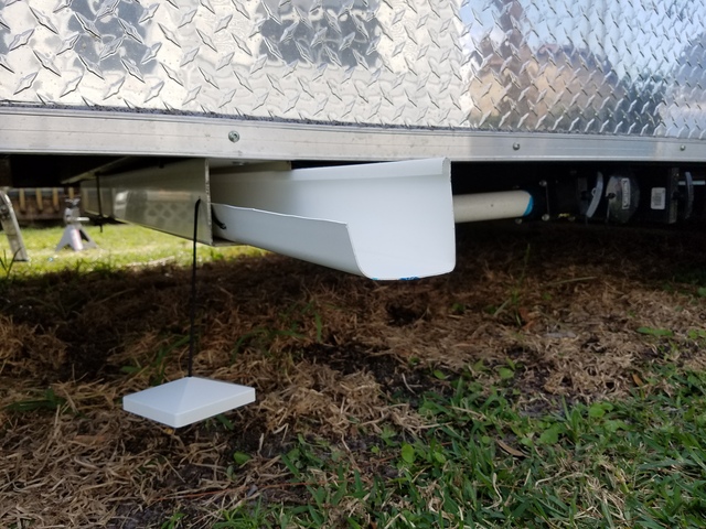

Hader wrote:"I am going to use an adhesive and 4 screws to attach it underneath to the wood decking"?
Isn't there about 4" or more of space between the bottom of the decking and the bottom of the frame?
It will go between the frame rails and mount flush to the floor decking. The purpose of the tray is I can pull it out and drop it down at an angle to access the hose... then push back in. I may need to trim some of the length off so I can get a good angle to pull the tray out . I'll make that decision just before I mount it. The gutter (tray) is very flexible and will bend. I'll take a few pics tomorrow after I install so you can see what I've done. I am pretty sure it will work... it does in my head anyway! :thinking: :thinking:

flboy, Howdy;
Don't anticipate anything bad happening with the access holes/vents. Where I'd
anticipate a problem would be with just using 4 screws and washers to hold it. True
it won't have much weight but there will be other forces at work down there. Such
things as wind, drag, the occasional stone or a slightly larger cousin (rock). Call me
overly cautious but I'd be wanting to use some pipe strap to add support as well as
security. Also, un secured caps can become blown off so in addition to the cord I'd
recommend a screw on both the front and rear facing cap lips.

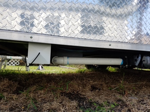

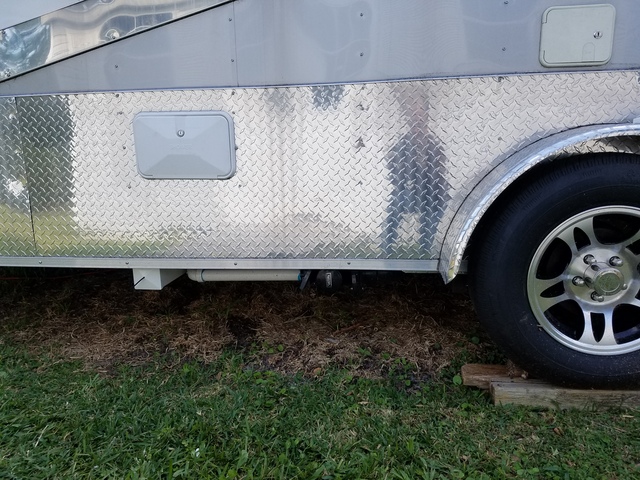

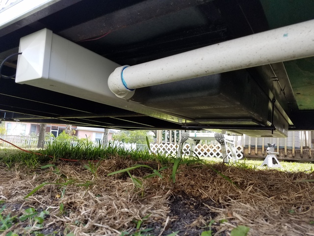

Postby flboy » Sat Nov 19, 2016 12:59 pm
This is what I ended up with. I decided last minute not to screw this into the underside of the decking and have it recessed. There was enough room for this to slide in the hanger brackets for the gray water tank. The more I thought about it, the more I liked the idea of easier accessibility, and it does provide some rock protection for the front of the gray water tank that hangs down. The square tube will take the abuse. Also, it sets no lower than the other plumbing for the tanks. I think it looks okay this way and will be super easy to use.
