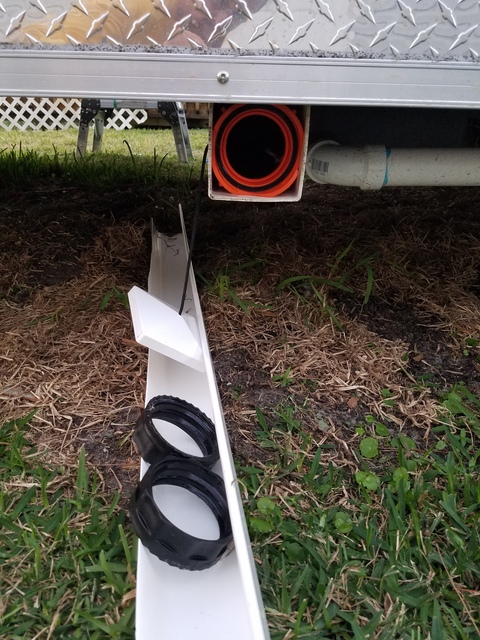

flboy wrote:Hader.. I cut it to 5ft. The way I ended up mounting it, I could have left it at 6 ft. I have a 15 ft hose arriving Monday. I'll put it in there and see what room remains to estimate total capacity. Will let you know.
Hader... do not get the 4*4 Square poST ... I wish I had my Camco hose earlier. The hose will fit, but the newer coupling (not the 90deg part) bind in there and will not fit smoothly. This does not work. My older hose does fit but the coupler is not as robust. I really like the Camco hose; however.
I am going to see what I can get for a larger vinyl post.. maybe a 5*5? Back to the drawing board and ~$20 wasted unless I leave it there and put a larger one next to it or use my old hose.. decisions... :cry: :cry: :cry:
In any case.. get a 5"*5" post and you should be good any way you go. Home Depot sells those also and they are only a few dollars more.

I may just leave it like this now.... I took off the black collars which were causing the binding... They really don't do much for the hose other than prevent rotation and the hose unscrewing from the fitting (the collars are reverse threaded from the hose fittings and mesh with it). My old hose didn't have collars either.. so I see no problem leaving them off. I'll just have to watch it to make sure the hoses stay screwed in well to the fittings. I also couldn't use the gutter slide.. but the hose feeds in effortlessly and I just need to line up the last part of the hose that attaches to the tank output, and it fits in snuggly.
I'd still recommend the 5*5 post however... Guaranteed no issues with that.. and if I knew better before I did this (used my old cheap hose as a fit check), I'd have probably went that way... I may have had a hard time fitting it the existing tank hanger however.
Hader... BTW... the hose collapses about ~3' to 1'... so 15' collapses to just less than 5'. 15' of hose is a lot.. I can't imagine too many scenarios where you'd need more than that.

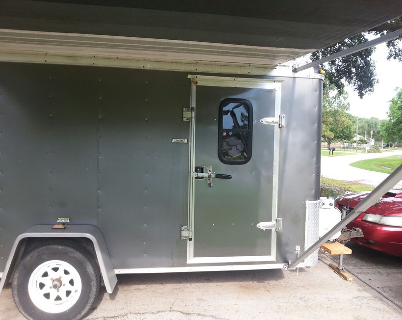

That retractable awning looks very similar to my Dometic 8500. I remember paying $500.00 I think for the whole shebang. That was 7-8 years ago. They have gone up in price though. maybe 8x10 or so. The material for the awning has a pretty short shelf life for me. Maybe 3-4 seasons and its already cracked and brittle on the material that is exposed to the sun when its rolled up. A few air bubbles are just beginning now in the inner portion. I store my trailer with the awning deployed as this seems to prevent inner condensation building up and that's what I think causes it to bubble between the layers of material. Just info.
I love my awning and its worth the money to maintain.
You May need that little roller wheel on the corner of the door to prevent tearing the awning material when you have it in a tilted position.
Cant wait to see it in use!

Postby Hader » Wed Nov 23, 2016 9:51 am
10-4 on the "You May need that little roller wheel on the corner of the door to prevent tearing the awning material". :cry:
