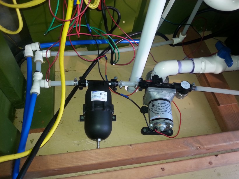

Finally got it right! :thumbsup:
All sink, pump, and on demand hot waters heater problems solved. Just like that. :D The accum is a MUST. Low flow at the sink... no problem!

Glad to hear it worked out well. I know the accumulator made a difference for me when I wanted to trickle water. That is why I installed mine. My hot water is not on demand... so never had that problem.

I would keep a close eye on those hose clamps you've got at some of your connections I've found
they don't do so well with the thicker walls the PEX has over time. Just something to keep an eye on ...

One tip I found out when it comes to pex and barb fittings is my wife's hair dryer made quick work of it all. Heat up that tubing real good and it form fits easy. Then slip the hose clamp in place and tighten while the tube is hot. I will monitor it for the week under pressure.

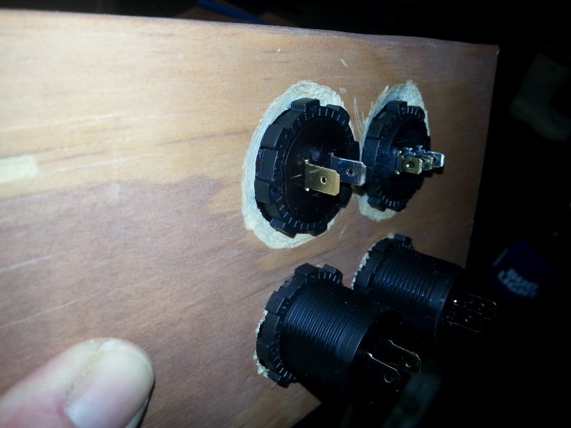

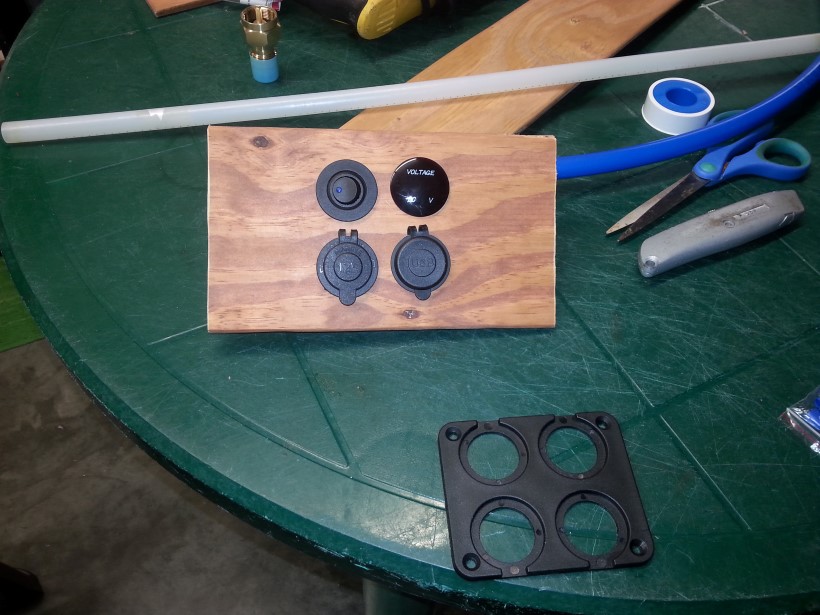

Don getting ready to maybe hand this off to you for wiring up. I don't have a soldering iron.
But a little more work yet but it is pre-wired.
Will make small wooden box like the OD pump switch box.
