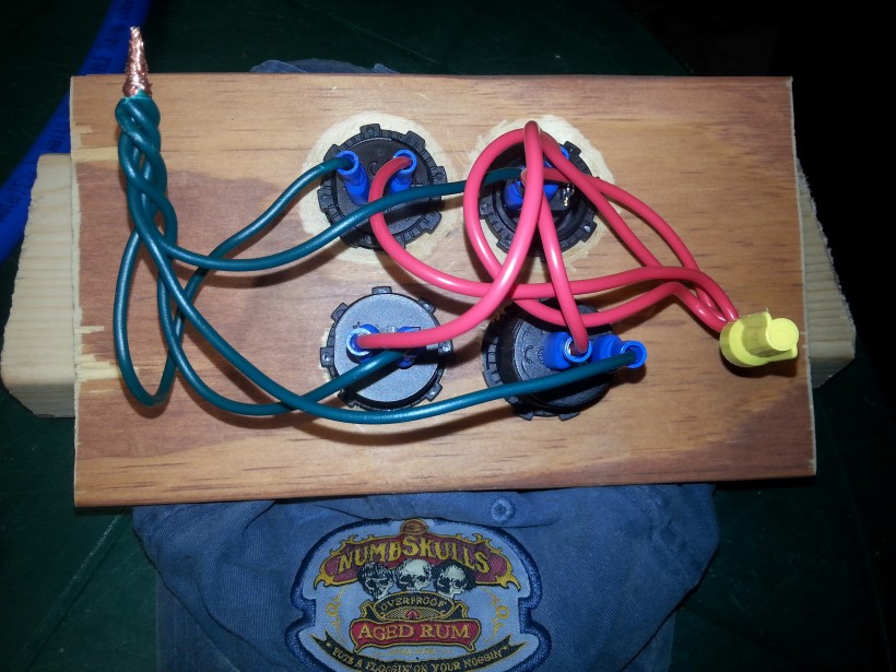

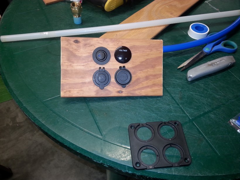

I don't see the need for soldering here so I forged ahead. Going to rap this up quick. I had fun. Simple. Not done yet though. Shelve and small box above fold out shelve... :thinking: dunno
I did not wire in to auxiliary buss yet but the wire is run.

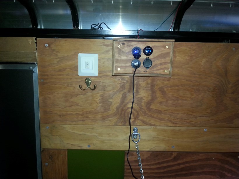

Well I wired it up per Dons instructions and of course it works.
Will now make some sort of box/shelf combo. Using scraps I saved. The ones that are already sanded and stained are a bonus for me.
You know when I first hooked it up the C.T was plugged into the house as it has been for a day or so as I was working in it. So at that point the voltage read 13.6. I then unplugged the house power and it dropped to 13.3
Both readings seem high for a 12 volt battery. Can My Progressive power center over charge. Is it?
It has some charge wizard chip or something so It shouldn't.
Anybody? 13.6 :thinking:

Your good! That's what you should be reading.

13.6v is typical for the charger. 13.3 will probably drift downward some without charger and more quickly if you put a load on the battery. It sounds normal to me.

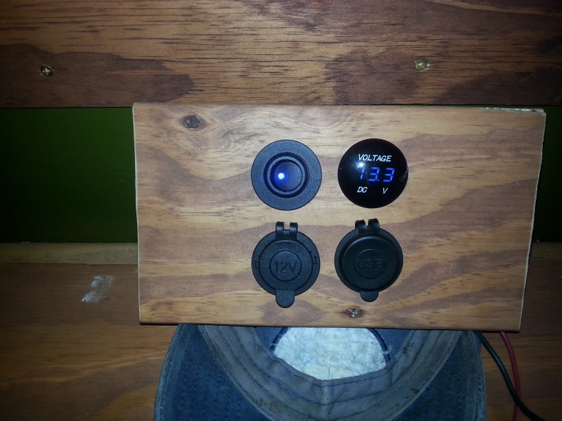

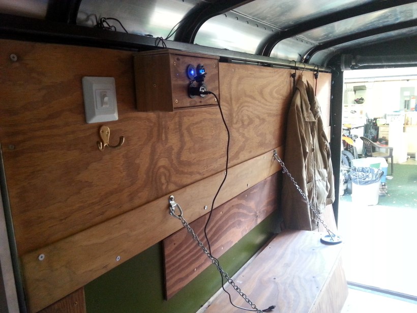

Thanks all. It seems to have settled at 12.7 but I had LED lights on as I finished.
Its bigger and deeper than I thought it would be but it is a new DC power center after all, The location allows for the phone to set on the fold out counter with no stress to the cord.
I still need to tidy up the wire and all but that is the basic set up.
Question if anybody knows...will that set up run a lap top or a DC TV ? One of those outlets should do it, right? :thinking:
That picture shows the phone cord in the wrong outlet. It was too big and I had to use the cigarette lighter like outlet that I use in the truck which worked fine. So what are those other jacks for? TV or Lap Top?

Tommy, the cigarette lighter receptacle should run almost any DC device limited only by the gage wire and fuse size you selected (of course you need the correct DC adapter for your device if it does not run straight up on 12vdc) . The USB ports will charge phones and laptops.. but not do much else... you can run the laptop while plugged in however, if the USB port doesn't keep up, the deficit will be drawn from the laptop battery.
The mount looks great. Nice work!
I am confused on the USB outlet being too big and having to use the truck adapter. Can you post a closeup of the USB port?
Also, I forgot to say, the switch is a 20amp switch I think. You should be fuse limited to 20A.
